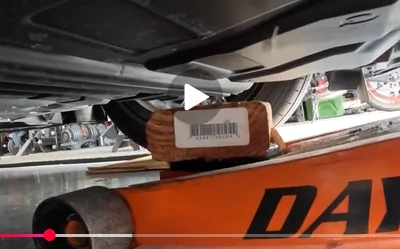

Hello friends.
I spent the day painting the brakes of my Nissan Z lime green, so of course I needed to get the car in the air and remove the wheels. I've seen a few posts with pics on putting a Z on jack stands, but no vids. I made a quick video today for the masses. Feel free to put your $0.02 on the vid or tips that can make the process better. All will benefit from this input. :)

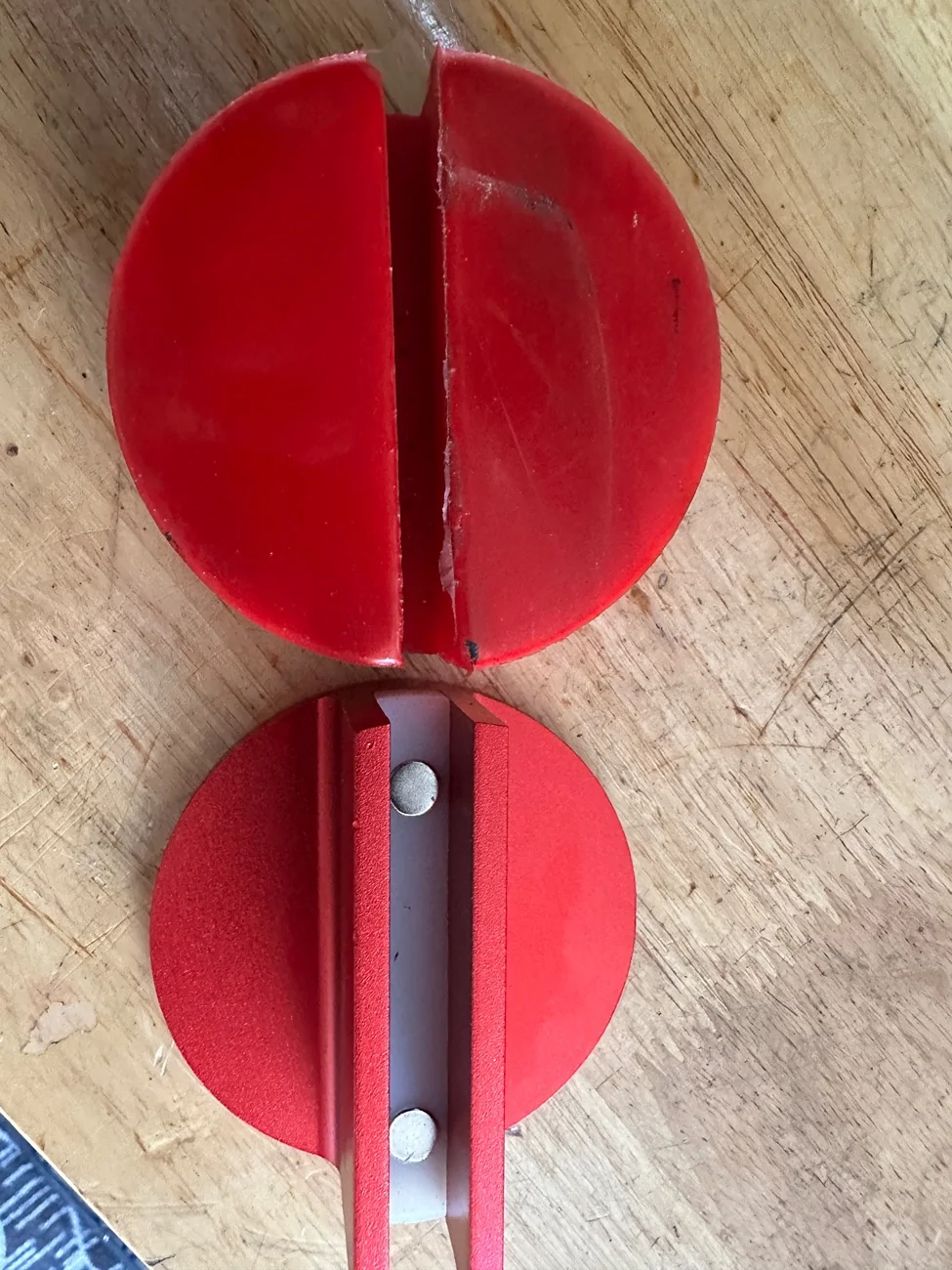

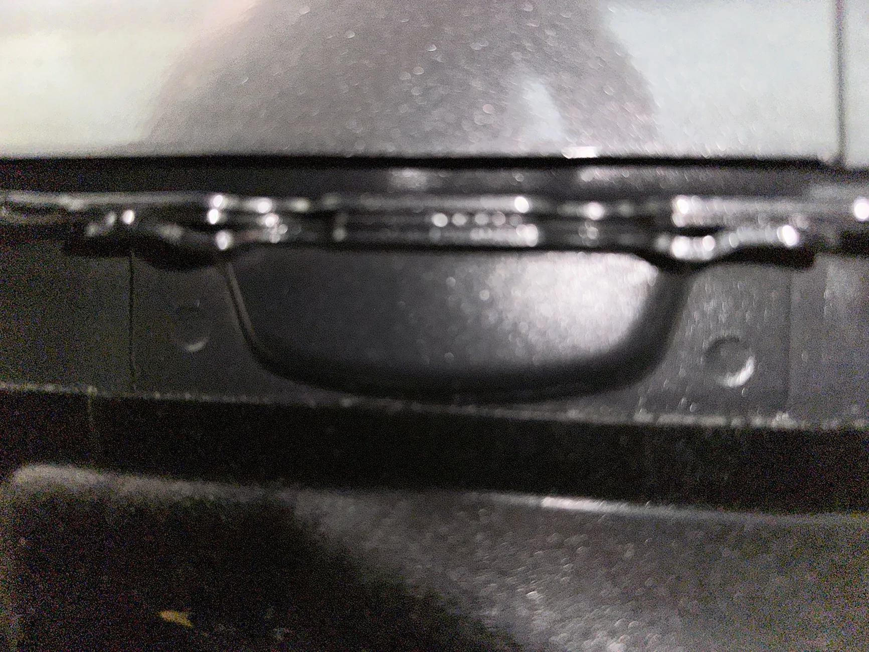

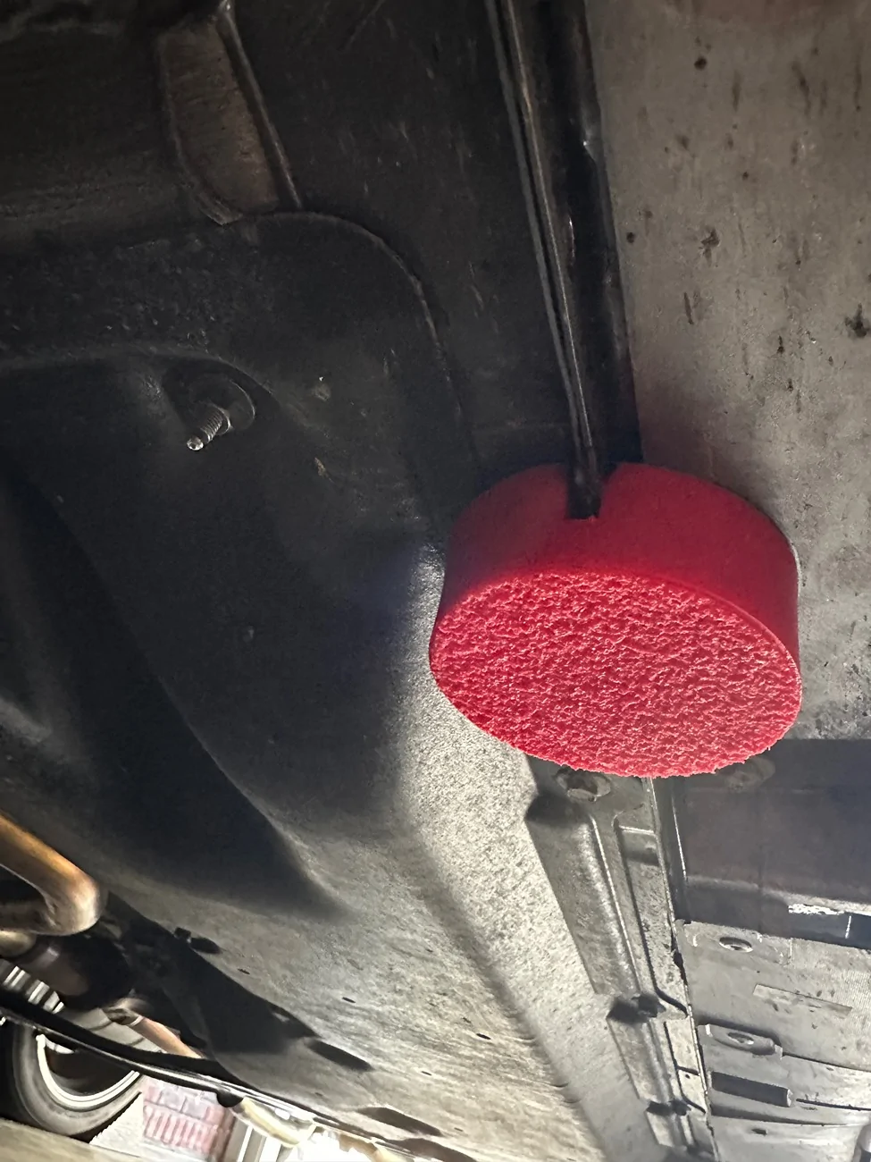

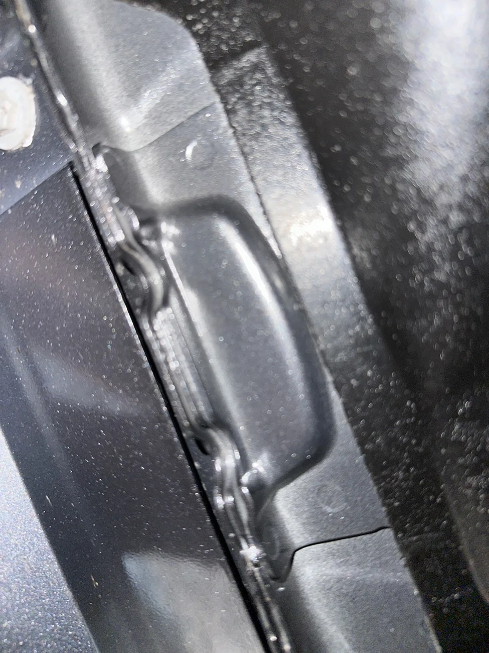

I loved the location for the front jack stands. However the pinch weld “flange” is not designed for support. There is a pad/lift point just inside of the flange. The flange itself is just for locating the lift point and not to be used for lifting / support.
i bent a few flanges before i figured this out. lol.
Thats why the hockey puck with a slot works so well. with the puck resting on the pad, the outside of the puck will clear the plastic trim and the slot clears the flange.
looking at my polyurethane puck, you can see the imprint of the pitch weld pad. Also note the pretty little aluminum puck would not fully cover the pad.

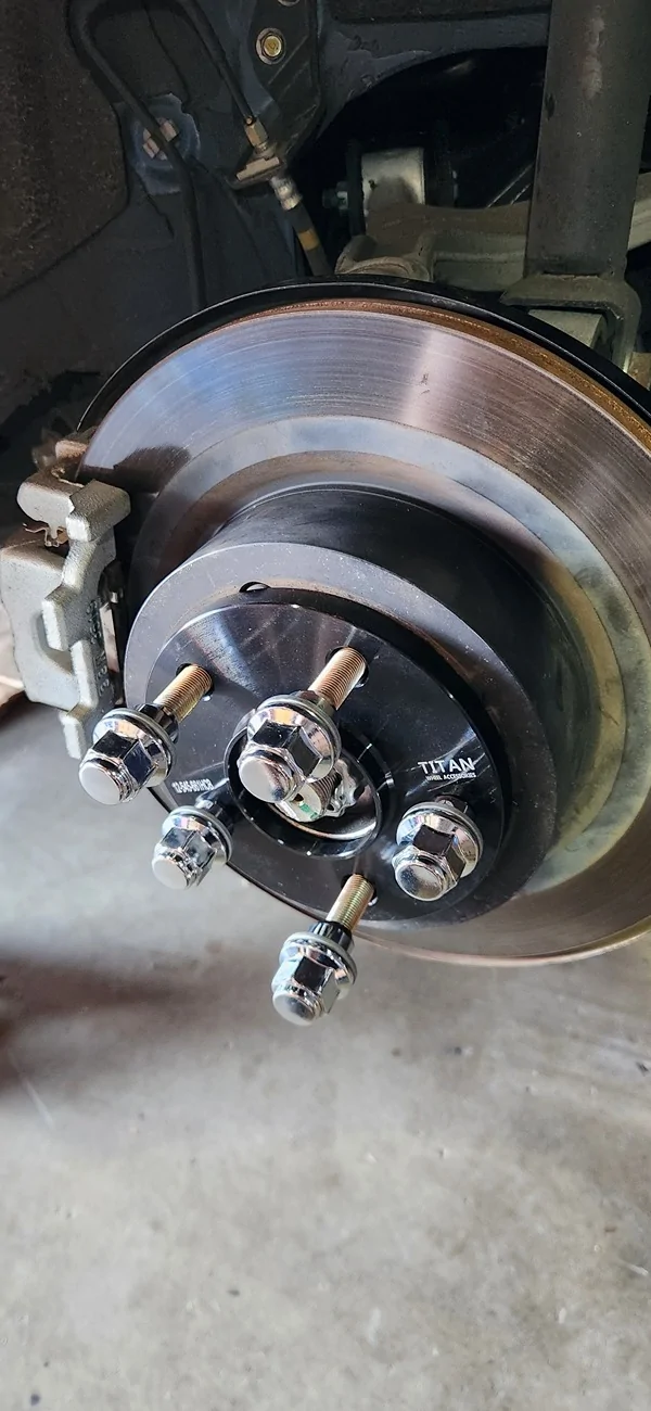

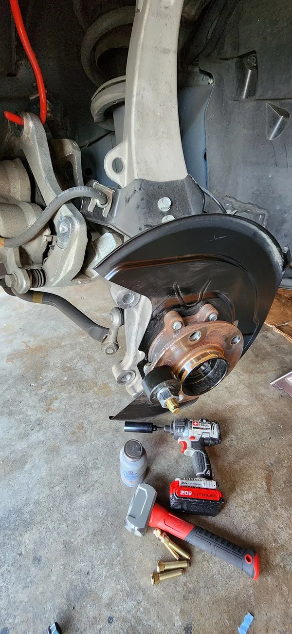

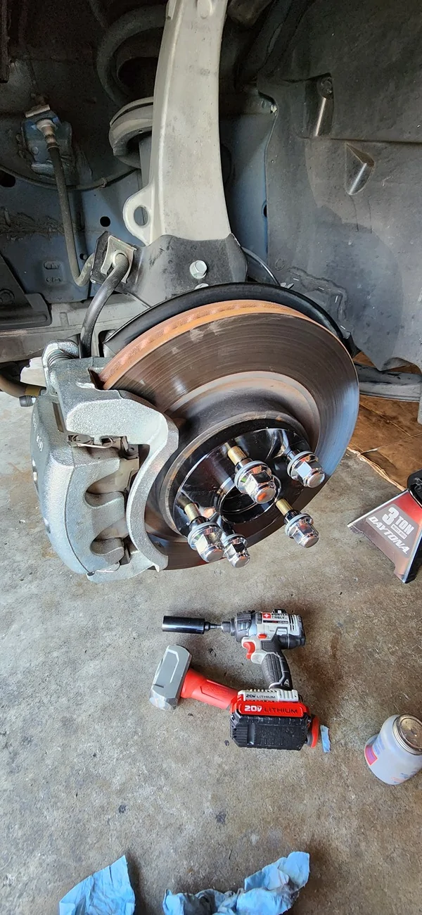

I did the 50mm wheel studs. The fronts has a cut out for the studs (see pic). The rears are not that easy. Just make sure the ebrake is off. You spin the hub while feeding the stud.
They fit my 12mm and 15mm spacers with stock wheels and lugnuts. You can see the nuts bottomed out on the spacers.
