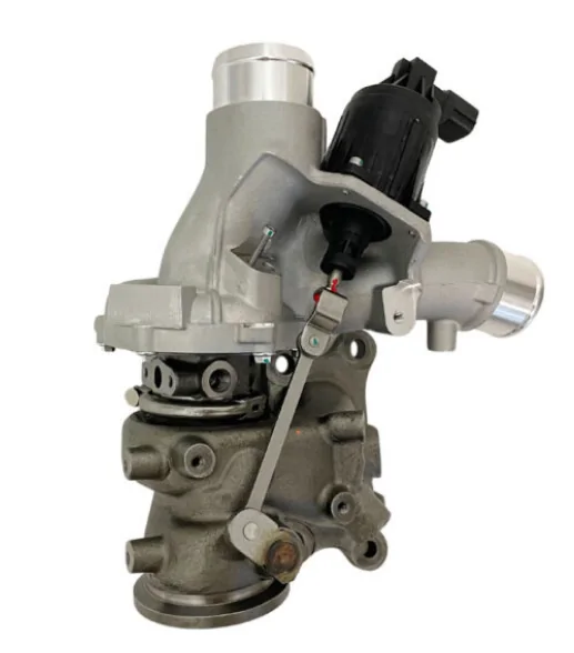

It sounds like the wastegate actuators and/or their linkage to me. Either one or both of the electronic actuators is bad or it or it's linkage is sticking. I'm surprised the dealer hasn't even checked this.
It's the black part in this photo. If it is bad/misadjusted/sticking the car will boost like mad to some insane number before the ECU freaks out and probably closes the throttle plates to prevent destruction.
