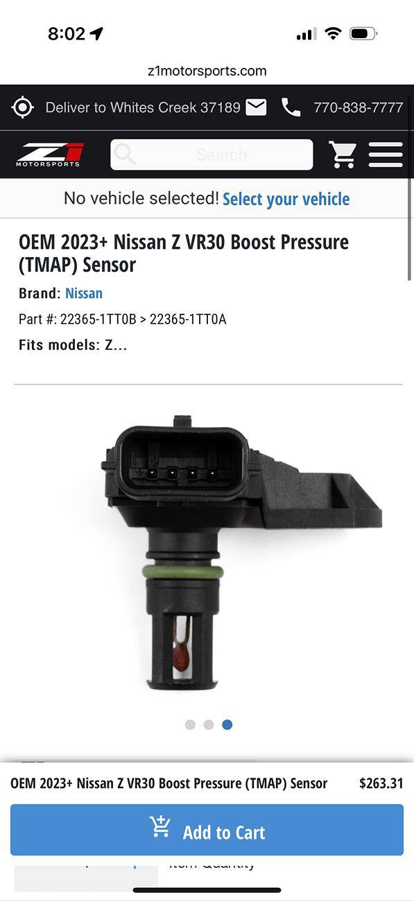

Even with things going wrong, could the turbos spool to 23 psi THAT fast? I feel like this is an electrical/sensor thing.
In the first video:
4,800 RPM, 40% throttle, 0 psi
-> 100% throttle
0.7 sec later, 5,200 RPM & 23 psi
In the second, "less aggressive" video:
4,000 RPM, 25% throttle, slight vacuum (-1 or -2 psi)
-> 100% throttle
1.2 sec's later, 5000 RPM and 23 psi.
I could be wrong, but 23 psi in 3/4 of a second and a 400 RPM swing seems physically impossible on stock turbos and stock exhaust.
