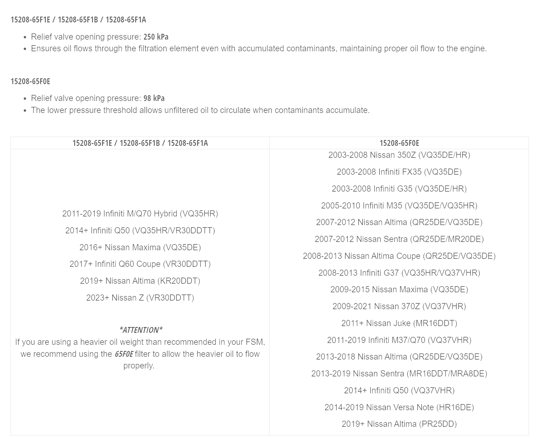

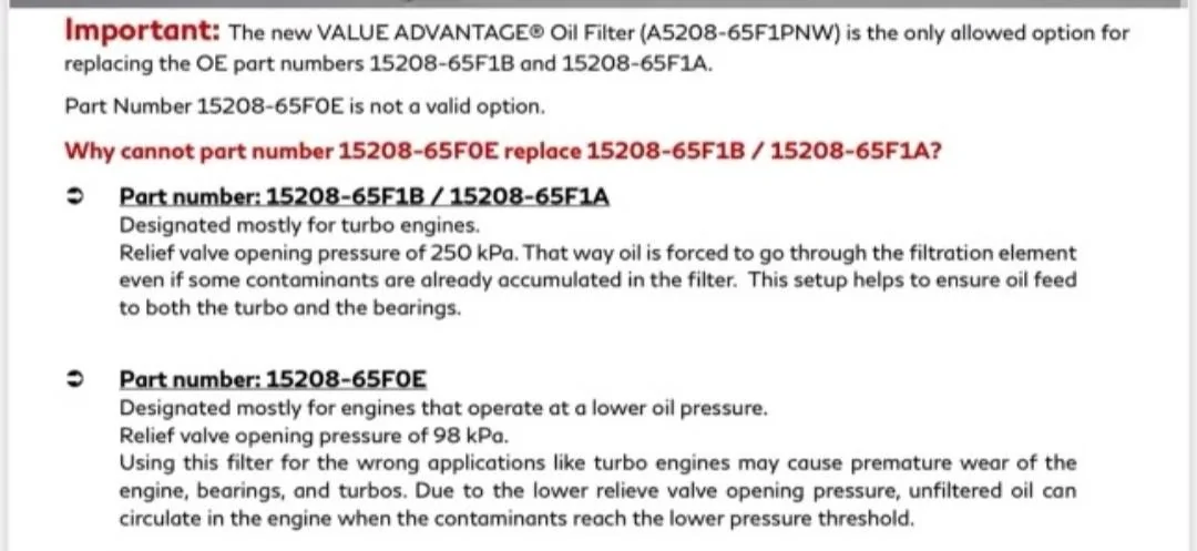

I went back to the 90s oil change interval at every 3k miles using 5w30 and the Nissan GTR oil filter. I been pondering to go with 10w40 this summer and switch 5w30 for winter
I know the GT-R filter physically fits and is often-times talked about as an upgrade, but has anyone confirmed it contains the correct bypass pressure? I've searched, but thus far have been unable to verify.
For this reason, I am sticking with the 15208-65F1B/E. Here's a comparison I did of the two:
https://www.nissanzclub.com/forum/threads/z-oil-filter-japan-made.7336/page-3#post-148596
