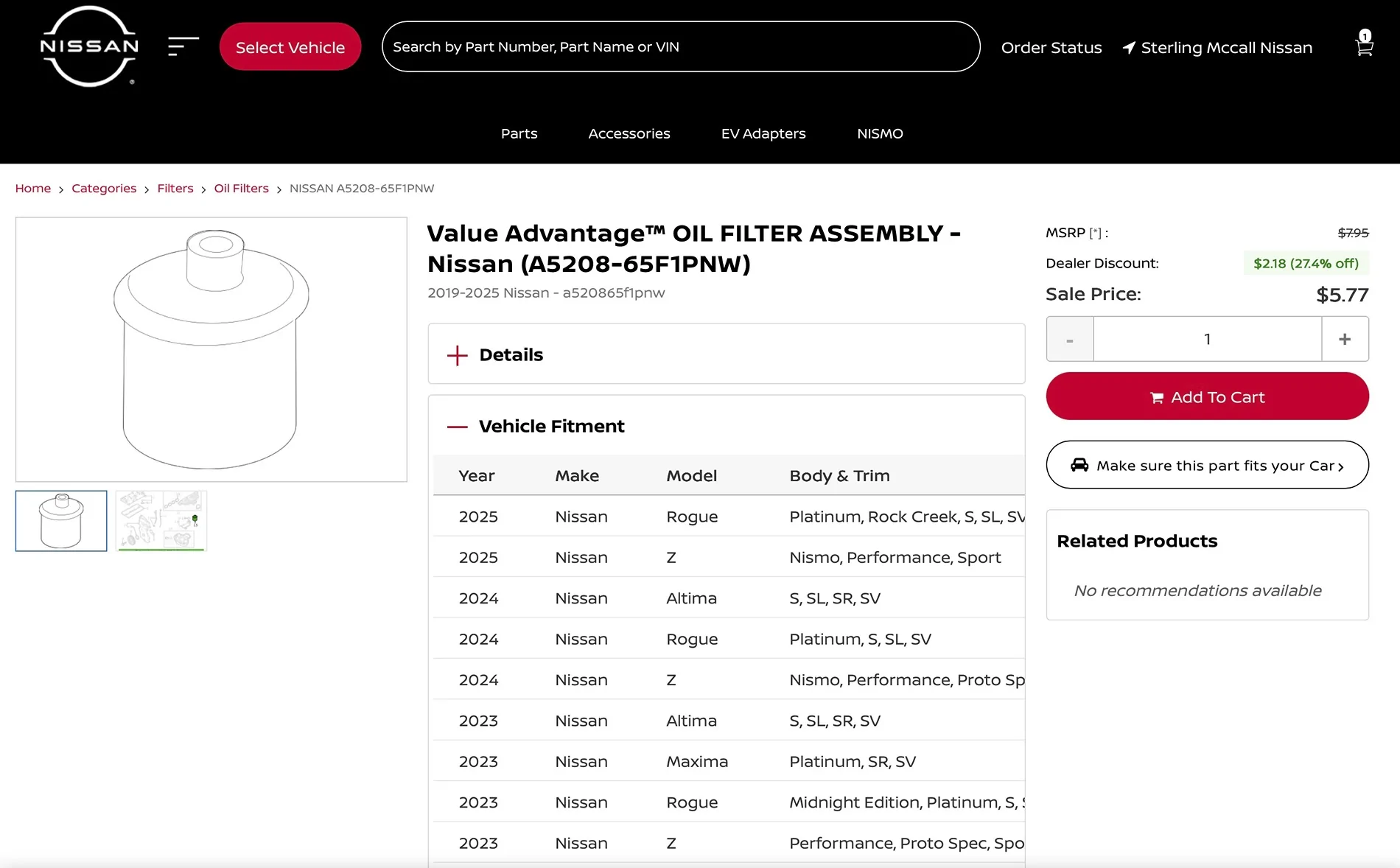

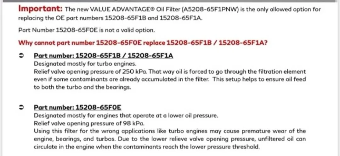

do you have pictures of the Value Adv filter?
This one looks like a universal filter for nissan

Someone with the NVA filter for the Z, or who knows the answer, should verify, but other NVA filters are produced in Indonesia.

The 65F1E I ordered online just arrived; I'm going to go back to the dealer and see if they have any more B's on the shelf.
Sadly, they had no more 65F1Bs when I stopped by this afternoon so I just got another 65F1E. They tried giving me the 65F0E at first so reminder to always check what they hand you.

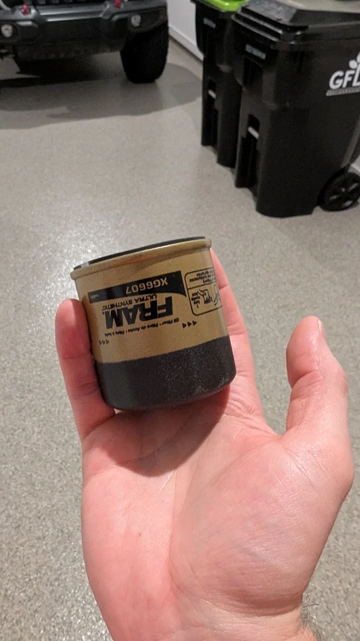

I wish there were a good aftermarket option that utilized the proper bypass psi... A Fram XG would be ideal! I originally ordered one until I realized it was the incorrect bypass pressure so I returned it.
At least my nearby dealership only charges $9 for the OEM Nissan filter and includes a crush washer for free. Too bad I got their last F1B and they're on to the E's now! Irregardless, I'm sure it's fine; the GT-R filters are also now made in Mexico too.

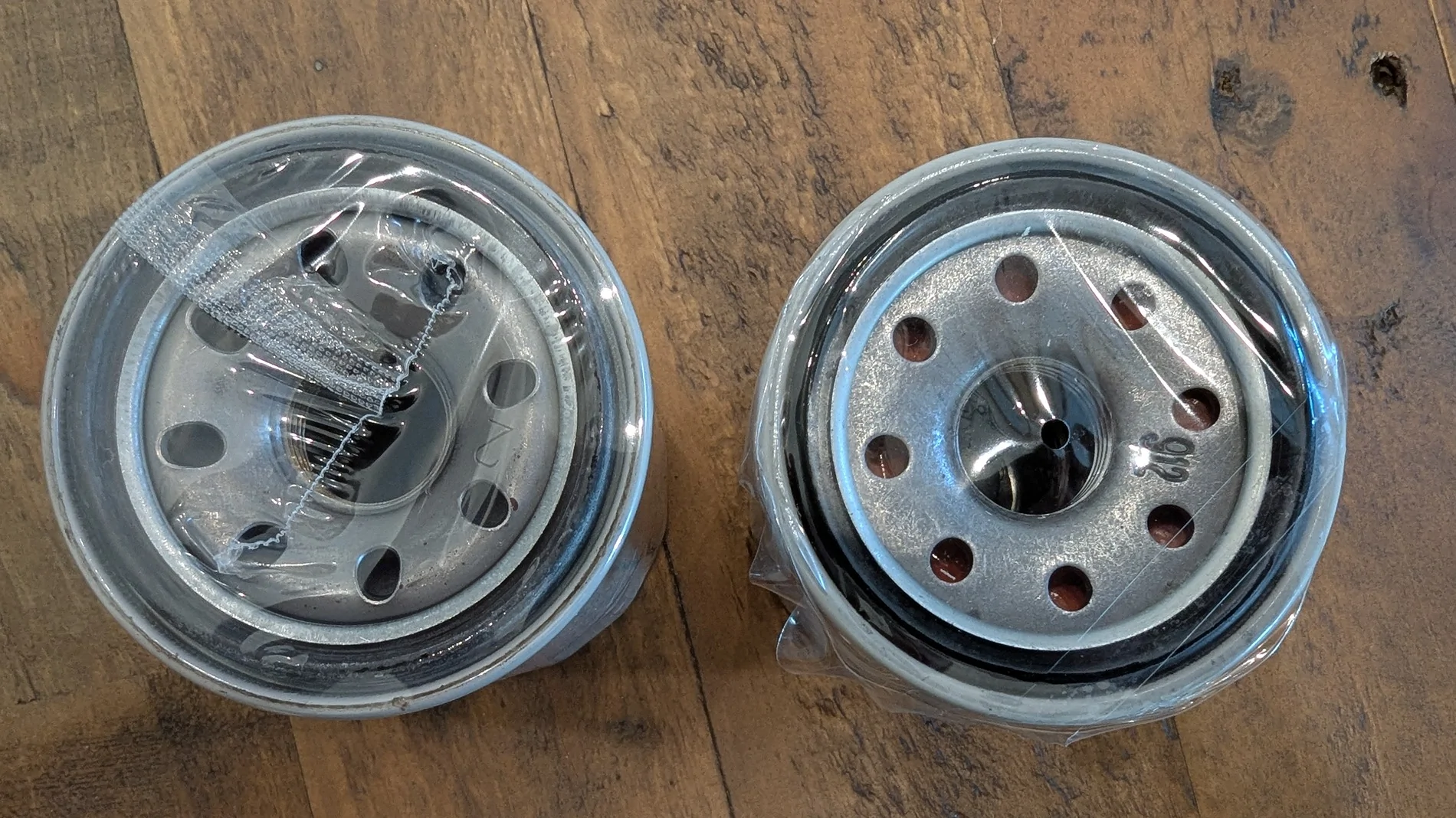

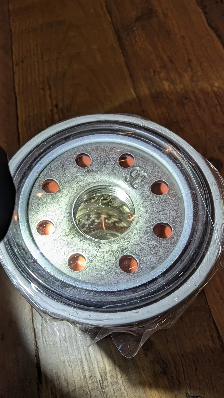

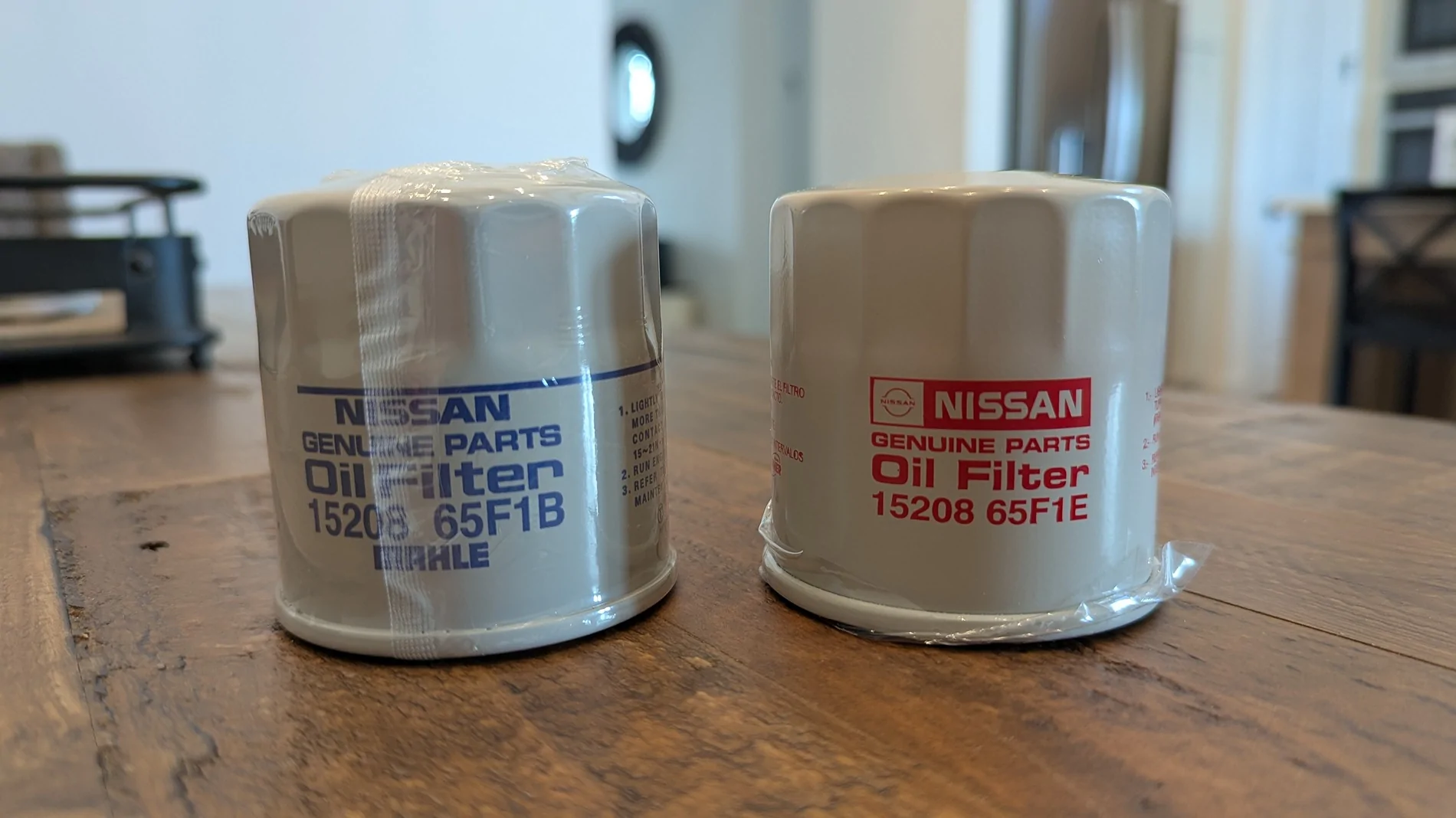

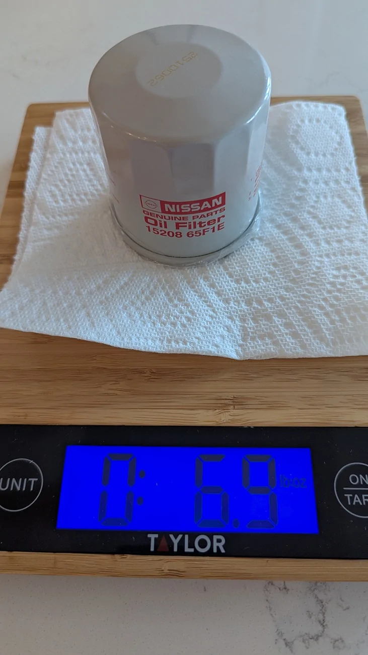

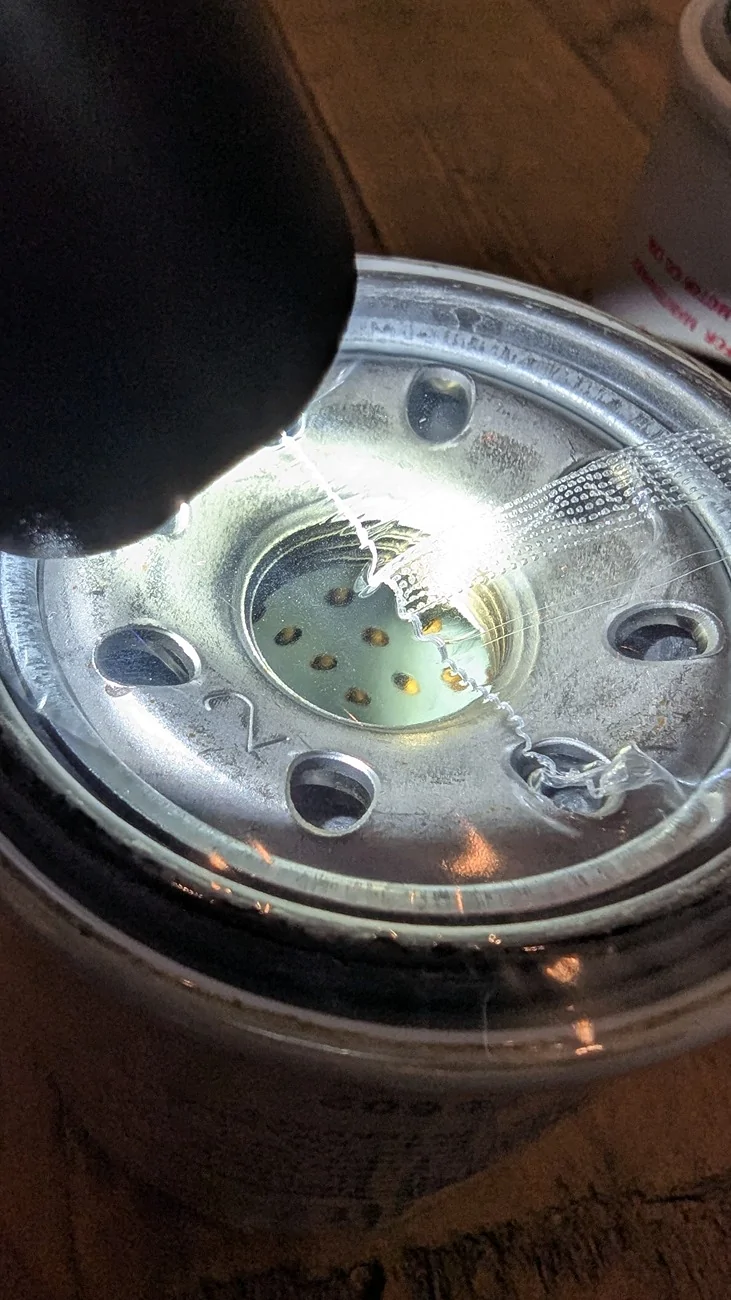

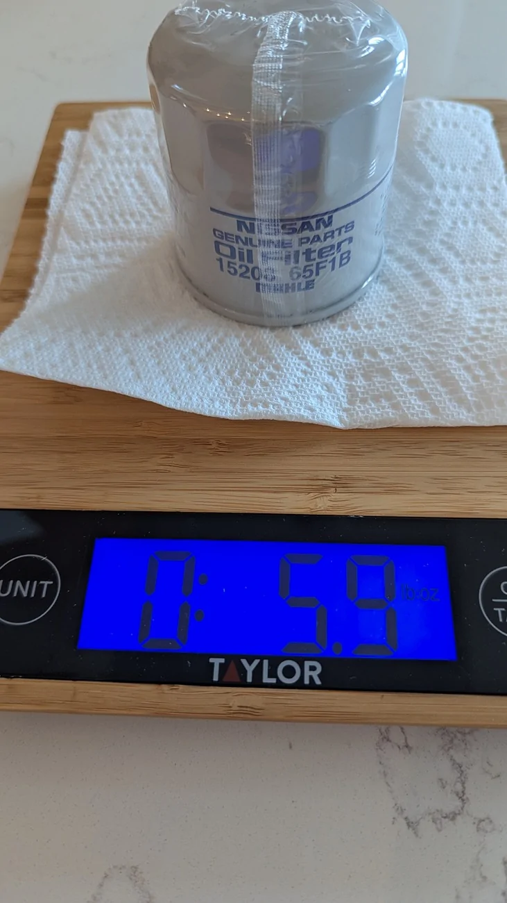

A little side-by-side comparison:
Japan left / Mexico right
Japan
Mexico
Japan
Mexico
Takeaway:
It's probably blasphemous, but after holding & looking at both, I like the Made in Mexico filter! I prefer the anti-drainback material, internal louver design, and heavier weight.
