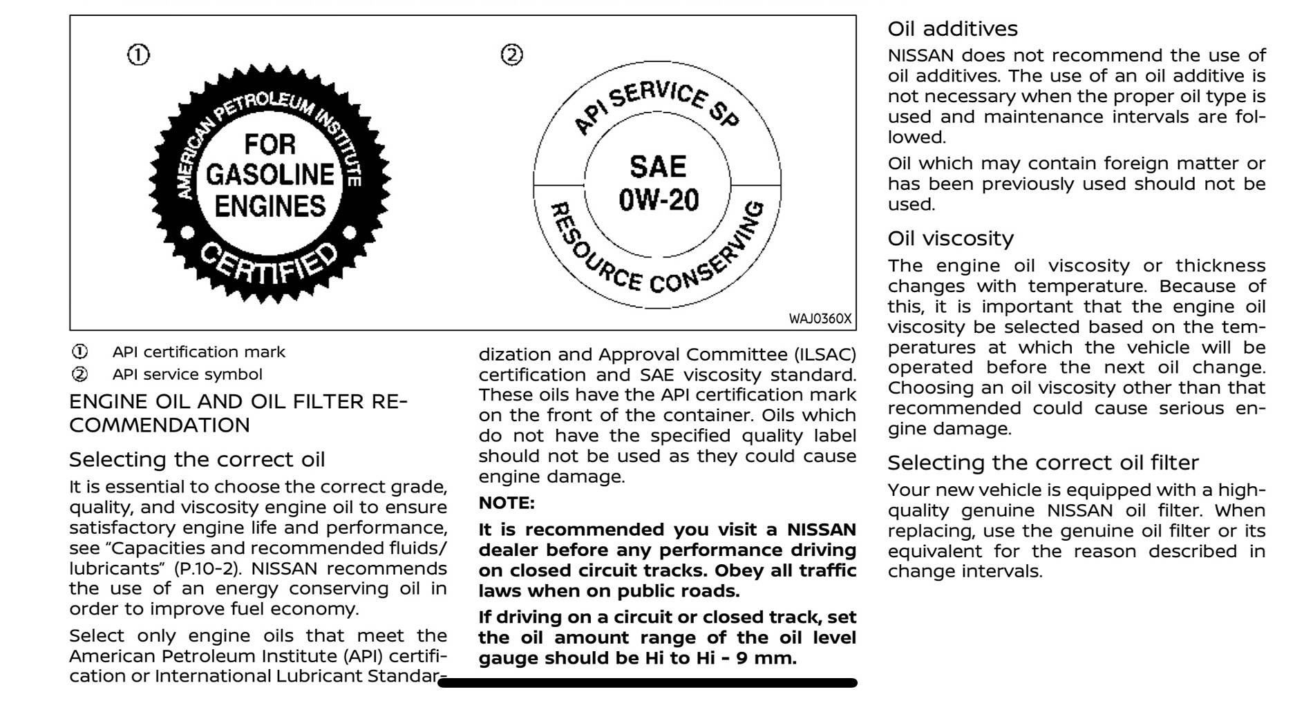

From the manual:

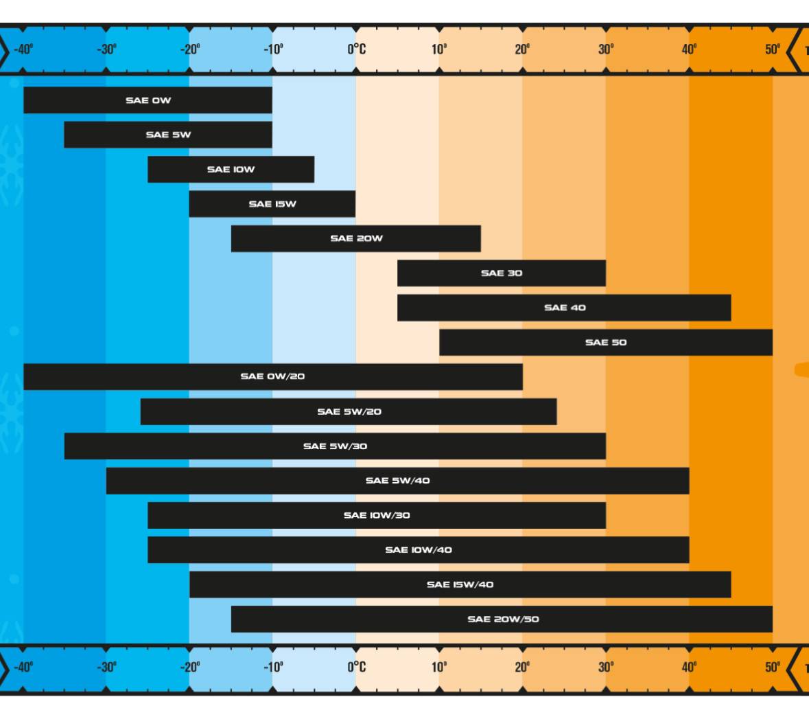

If you look at this generic chart showing ambient temp range and oil viscosities, it is pretty clear that 0W-20 is a dumb choice for summer pretty much anywhere other than the arctic. Get this from a reputable place like API, Nissan, etc. Don’t use a photo off the internet.
FYI 20C is only 68F. That’s what 0W-20 shows below. Clearly dumb. 30C is still only 86F, which is what 5W-30 is good to. None of these will blow your engine up when the oil is operating temp, but I would think people in Phoenix or similar run 10W-40, or should anyway. You could even run 50 weight
I’m no oil pressure guru, but I’d think there are diminishing returns above 10W-40 on this engine with it having turbos and being smaller displacement. But a way bigger concern is the stupid oil bypass solenoid stuck open and blowing the engine.

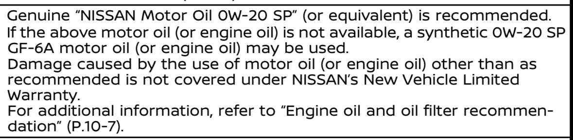

The key takeaway here is "Damage caused by use of motor oil other than as recommended is not covered under NISSAN's New Vehicle Limited Warranty.".
That language seems to specify that they are free to deny warranty claims if you don't use their recommended oil, which is exactly what the nissan tech told me at my last oil change.

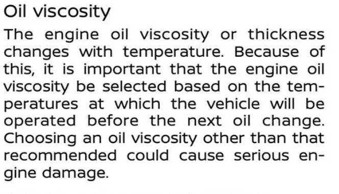

However, under the section for Oil Recommendations, it says this:
Nissan recommends: 0W-20, API and ILSAC, and using the correct viscosity due to ambient temperature range “before the next oil change” if 0W-20 isn’t it.
The part in quotations is apparently not worded well and means “before going to the dealership and having your oil changed [determine the correct ambient temperature and corresponding oil viscosity for the next period during which the changed oil will operate]”.
Note: ambiguity is still there, but in this case I move away from worrying about someone else’s terms and conditions and focus on ensuring my own. I can do that with what they said in the manual and fight it easily if my oil is in the correct temp range its entire operating life.
