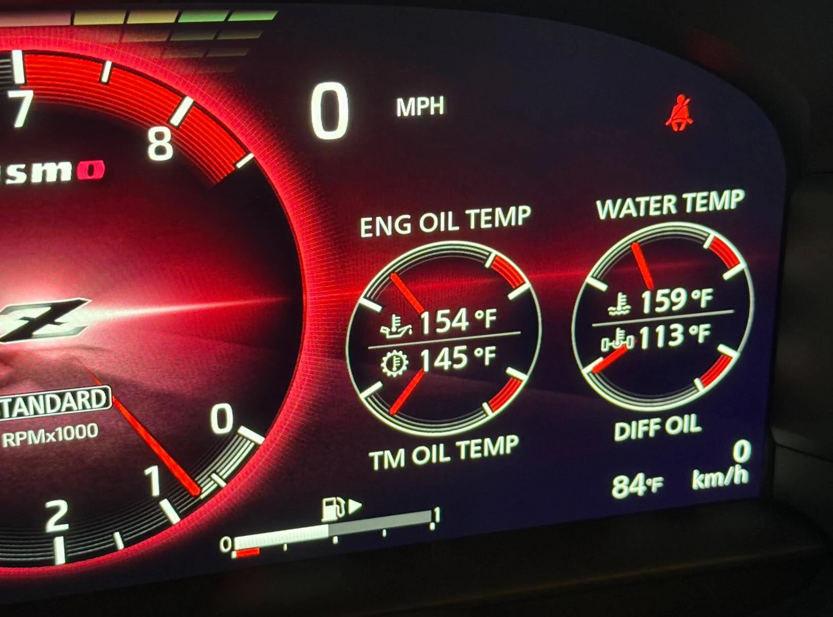

FYI: Tapping the pic above on my iPad to copy it and happened to tap on “113 F” and a dialog box popped up with that temp in C. Computers is smart.
That's exactly what the performance looks like in sport view. No oil pressure. I wish we could choose which gauges show up. I always thought TM meant "turbo motor" until the Arizona Robot educated me that it's transmission temp lol.
