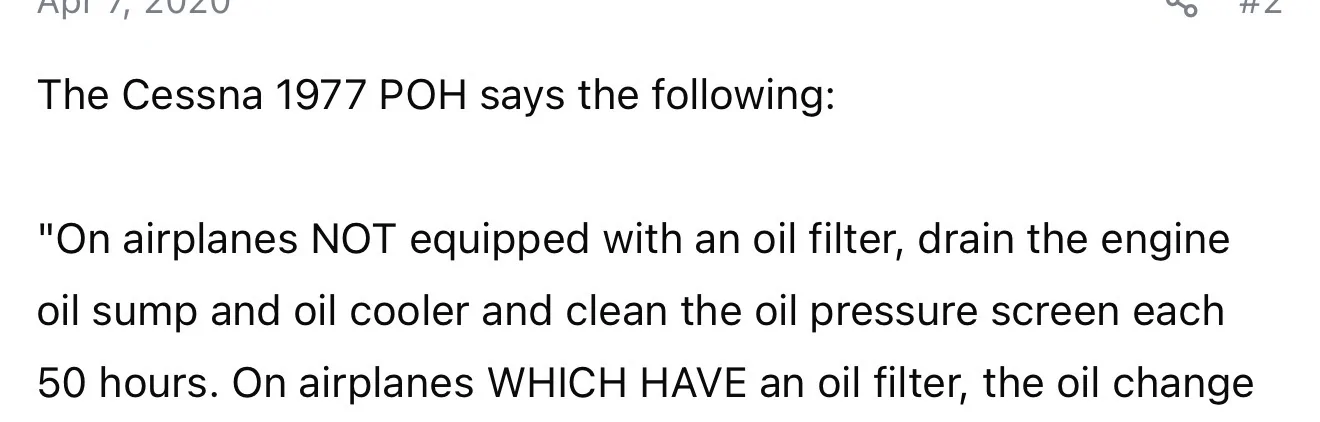

They do... I'm sure your friend is a fine pilot, but mechanic he is not. Most professional racecar drivers couldn't tell you the difference between a wrench and a lug nut, either.
Christopher
Nov 23, 2025
1,372
1,989
Sioux City, IA
Commodities
Drain engine.
Drain cooler.
Clean screen.
Every 50 hours!
That's basically the equivalent of 3 WEEKS worth of Houston commuting.
I'd rather just run a quality filter with a simple drain & fill procedure and worry about it a few times per YEAR instead.
Unfortunately, your pilot buddy doesn't understand how oil filter bypass valves work nor that it's unrelated to engine oil pressure and instead a pressure differential across the filtering media. Luckily for him since he doesn't replace them, they do work effectively enough to save his engines from immediate destruction once clogged.
