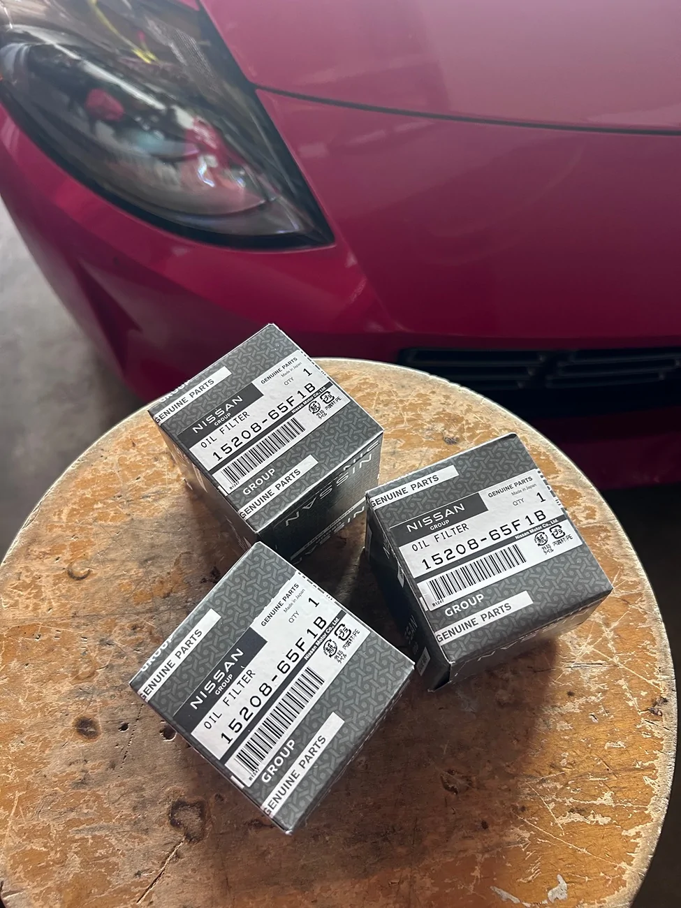

Where did you get the info on the relief bypass spec for each oil filter? I've been sent an oil filter with part number 15208-9F60A but want to see if it's at least the same spec as the 15208-65F1E I ordered
afaik Nissan says the 9F60A supersedes the 65F1E. They don’t know what filter they want you to use on the RZ34. I prefer the Mahle to the recent ‘OEMs’ and then the taller GTR oil filter (more filter media) in that order. BTW- google says the 15208-9F60A is “approximately 1.0 bar, which converts to roughly 14.5 PSI” 🤔

afaik Nissan says the 9F60A supersedes the 65F1E. They don’t know what filter they want you to use on the RZ34. I prefer the Mahle to the recent ‘OEMs’ and then the taller GTR oil filter (more filter media) in that order. BTW- google says “approximately 1.0 bar, which converts to roughly 14.5 PSI” 🤔
Thanks for finding that, I'm sending the 9F60A back and have ordered a few of the Mahle 65F1B ones.

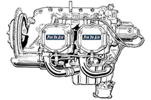

Greetings ....
Not knowing your buddy pilot's point of reference or specific type of aircraft engine, I have attached a few pics to perhaps help clear the air. First, keep in mind that aviation maintenance can not compare to that of the automobile industry. Second, in contrast to the statement that "most plane engines have no filter at all" feel free to study the attached pics and determine if your pilot friend can explain why one of the most prolific manufacturer of reciprocating combustion engines in the USA designs their engines with an oil filtration system which includes an oil filtration canister.
Again, not knowing your friend's aeronautical background/qualifications/certifications... base on the above subject statement alone, I recommend you politely refraining from actually flying with him/her at the controls!
