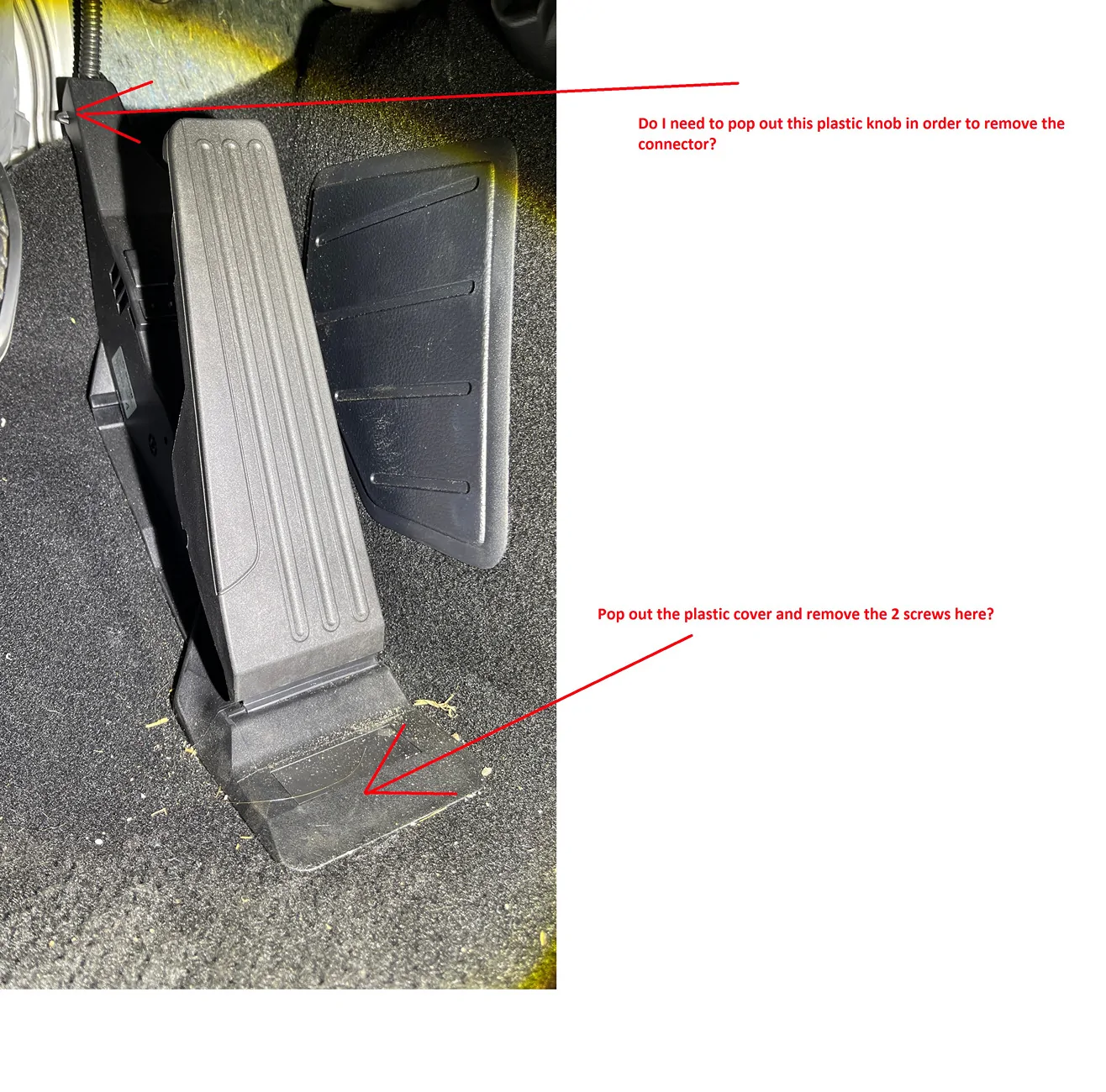

Disconnect the battery (-)
Unclip the connector at the top.
Remove the plastic rectangular trim at the base of the pedal.
Remove the two bolts.
Disconnect the connector at the rear.
I don't see anything else.

Disconnecting the car battery before you unplug the gas pedal will prevent the computer from detecting the disconnect. The two bolts are 10MM btw.

Just the negative side. No need to touch the positive side.
Here is a picture of the gas pedal with 2 red arrows to make sure I am looking at the right locations.
How do I pop out the little plastic knob at the top red arrow? Can I push it in with my thumb or use a hammer to pound it in? Thanks!
