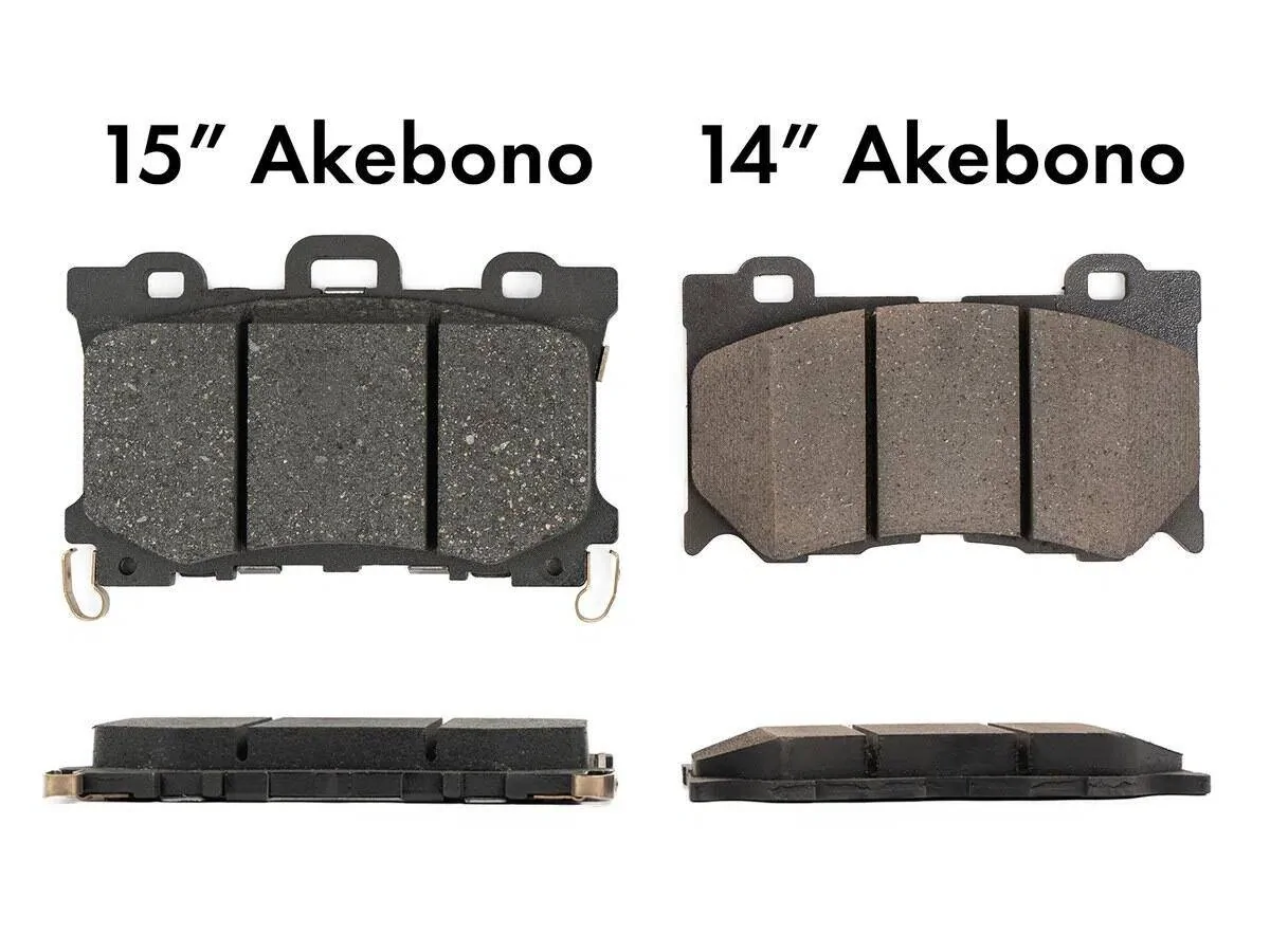

pretty sure rear is the same. here is the front comparison

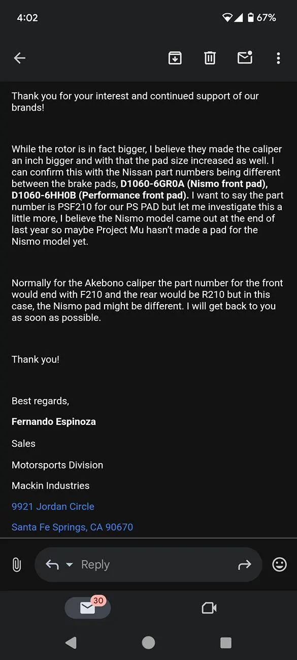

If you find the correct part number, please share.
I’m also keen to change the pads, but cannot find anything other than the OEM replacements.
Fwiw at this point.
Confirmed the NISMO pads are different.
Some parts numbers confirmed by Sales @ Mackin Industries (official Project MU distribution)
Waiting on his confirmation if P. MU has pads for the NISMO
