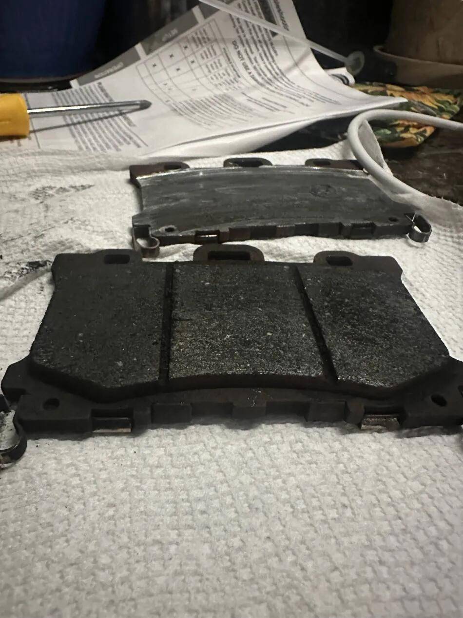

So after inspecting my pads that i brought back home with me it seems like something has gone terribly wrong with my front left brake which is at the top versus front right at the bottom... Is this what delamination looks like?
D2M
Jun 14, 2024
190
289
NJ
Nismo Z, Veloster N, Ram 2500
Thats normal wear on a clockwise track. I rotate my pads from left to right before every track day as my track has 9 right turns to 3 left turns.
