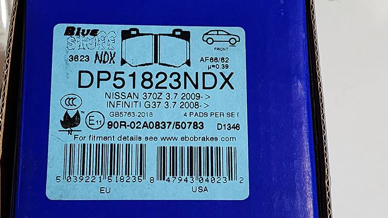

There must be some motorsports shops around VIR. I had these EBC pads installed just prior to my recent track day, it looks like they fit a variety of Zs.

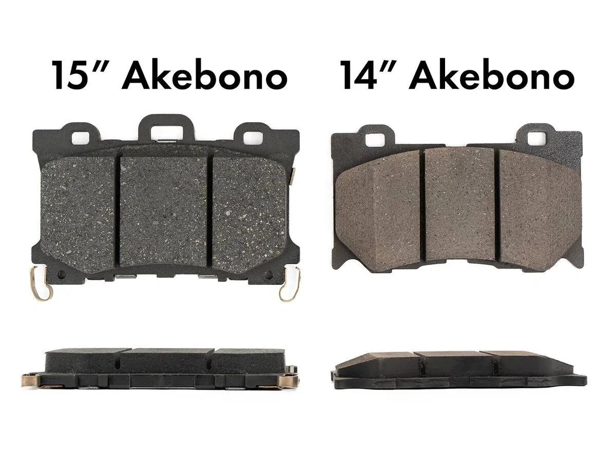

problem for NISMO owners is we have to have pads for the 15" brakes the 14" wont fit

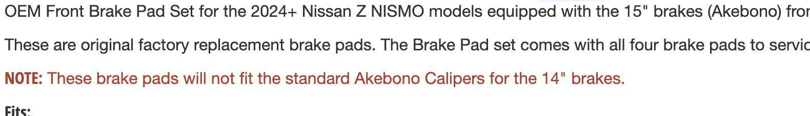

So the old 370 akebono pads won't fit? I was looking at the z1 page for the replacement pads '24 Nismo pads and they mentioned specifically that they wont fit the 14" but I wasn't sure if the reverse could still be true. I've been on a wild goose chase calling motorsports teams that run Nissan's in the area for help who were nice enough to help out and put me in contact with the guy who runs KNS Brakes. He recommended trying the 370 Akebono pads saying:
"They might fit in and be the correct width but just leave some rotor uncovered
The overall width and pin location must be exact though"
Was gonna ask Quantum in the morning either way

I wish I knew the answer to that but I skipped the entire 370z generation so don't have a great knowledge base on that set up. however I do know that NISMO USA makes an accessory track pad you can buy at a dealer ect these have been around since the 370Z and are offered for the new Z....but here is the catch they do not fit our 2024 Z NISMO. that tells me the 370z solution might not be compatible. I wish you could rig something up just to get yourself home.
these are the NISMO pads that fit the regular Z but not ours
https://nismoparts.nissanusa.com/pa...front-brake-pad-set-cu-free-d1060rnz45?c=az0x
man If I had a extra set of the OEMs here for my car I would bring you a set.
it sucks you cant visually inspect our pads without removing the wheel

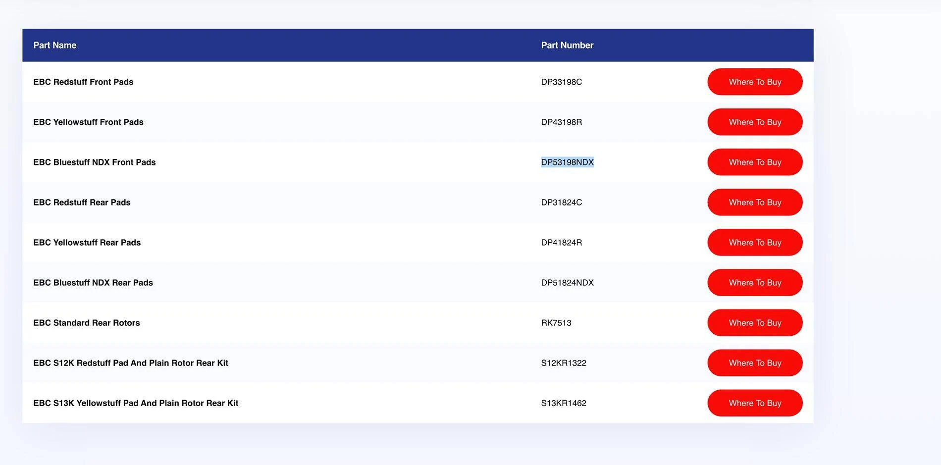

I've been looking at every brand I can find and the aftermarket support is very limited from what I can tell. It looks like EBC might have some options but the only website I found selling that part number showed it not currently available. I was told that you can send an old pad in to G-Loc brakes as well if they don't make one for your vehicle. The guy i was talking with from KNS mentioned holding on to an old pad as well. I've been looking at the OEM+ Nismo pad as well recently https://www.z1motorsports.com/nismo/nismo/nismo-2023-nissan-brake-pads-rear-p-36962.html edit: those might not actually fit

that Z1 link is the same pads in the link I sent. they wont fit
