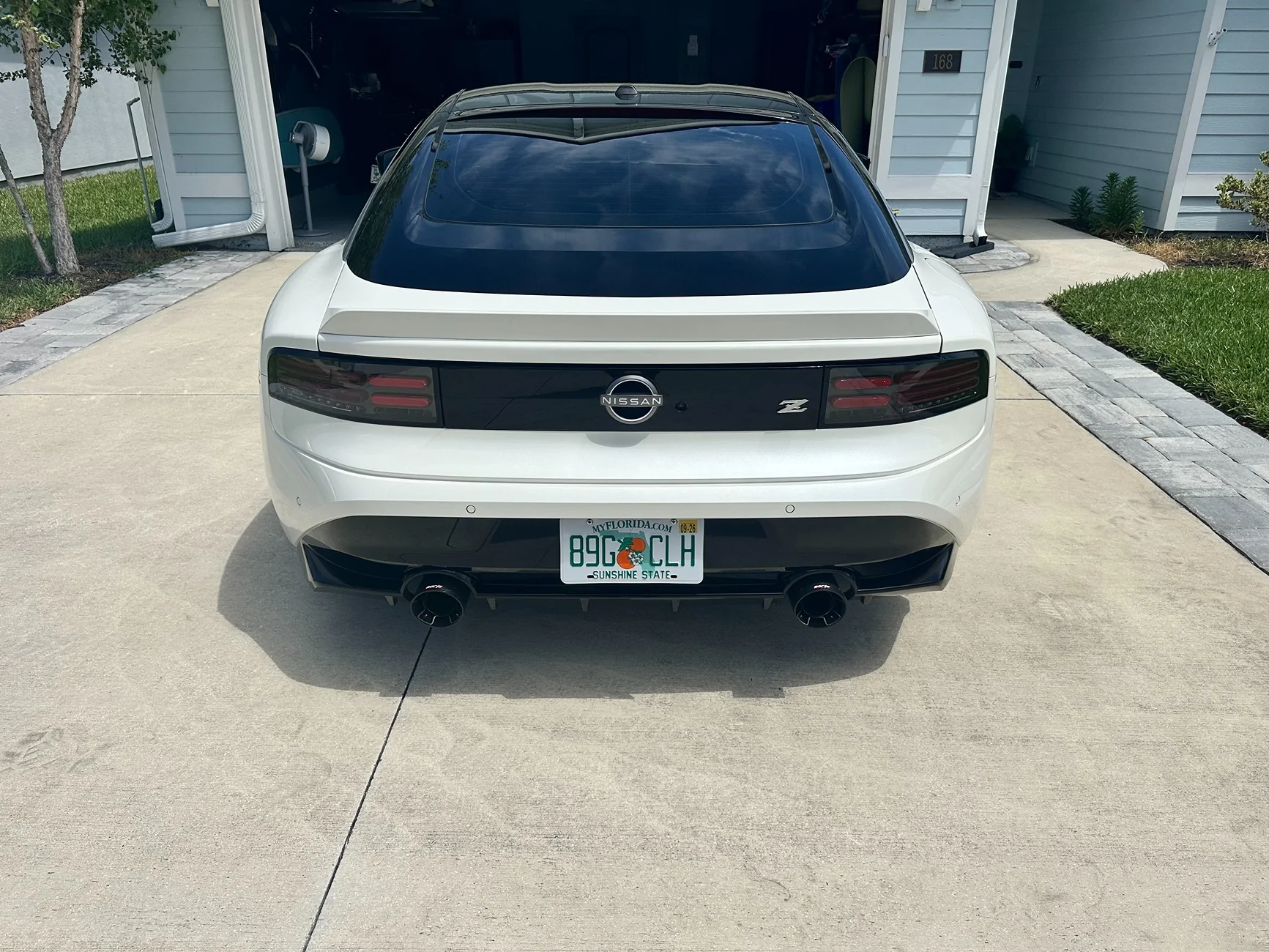

Hello everyone. New to the forum and Z ownership. I picked up a used 2025 Z performance 6 speed yesterday with just 1700 miles on it. I had low balled an offer about three weeks ago which they did not accept but I kept watching and on Tuesday I made one last offer for $42K and they accepted it. I feel like I got a really good deal and as a bonus the first owner, which was a ~70 year old man, put Borla S-Type exhaust on it. In any case I got the car back home and I am an older guy myself (55), that has been hot rodding and racing and building cars all my life. But this platform is new to me, hence the post and call for advice. I'm just looking to add 100 ish FWHP which seems doable but if I can safely take it farther I will.
The modifications I have in mind to further compliment the exhaust (which I think sounds great) are as follows;
1. - down pipes. I'm in Florida so I can go cat-less but what are the drawbacks? I've been looking at multiple AMS products. What do I need to match up to the Borla S-type system? Suggestions
2. Intake - again looked at two on AMS. The 80mm which they say is the highest flow and the cold air.
3. is the next progression the tune? If so from who? custom of just an ECU tuner that will compliment my upgrades?
4. Heat exchanger or Intercooler upgrade? Here is where things getting unclear for me as I haven't modified a turbo car. Any advice or help appreciate.
5. I plan to get Eibach lowering springs all the way around. Seems straightforward.
I think that is my first questions and thank you all in advance for the feedback. Car is really fun so far but I want a bit more.

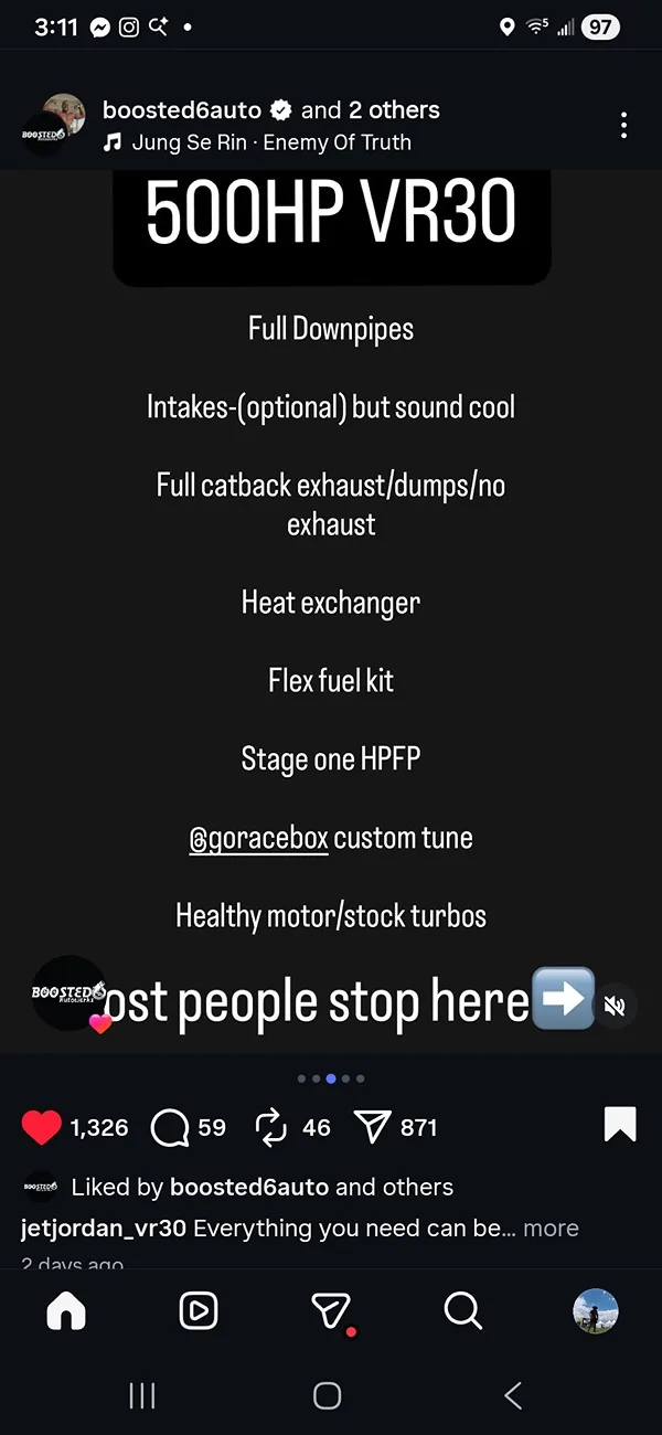

Stillen TruControl, lower down pipes, Z1 drop in filters and a full catback should get you to 500 crank HP. That's what I have. I just pulled away from a coyote yesterday easily. This is your most affordable option.
I'm also running an e85 and 93 splash gas blend to make about 95 octane.
