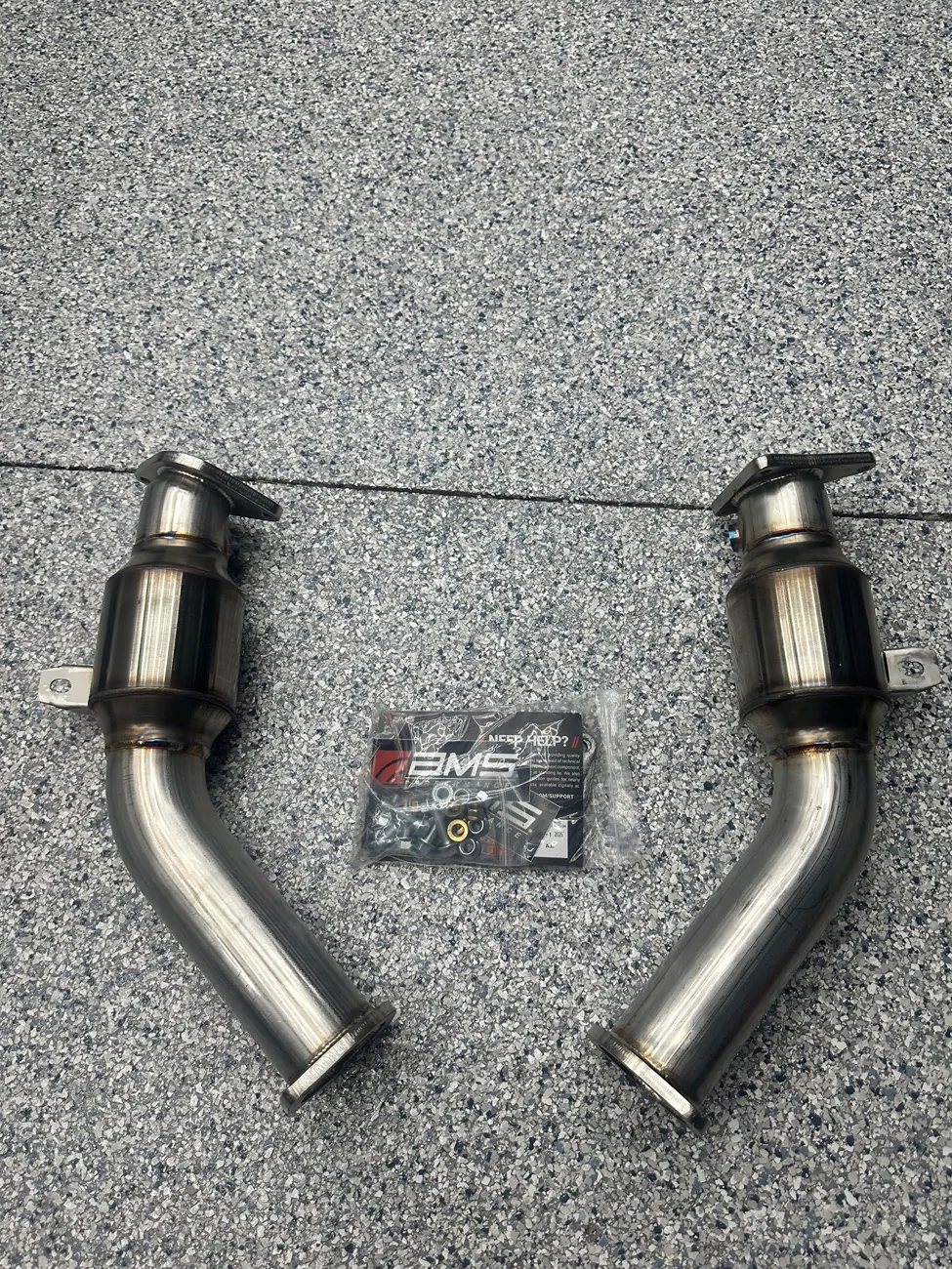

Point made ahhhhhh very telling. 3" FDP, there you go. If you choose 2.5 cat back then cool. Now FOR DUAL 3", titanium metal would drastically reduce weight and reduce back pressure. Thanks for sharing.
