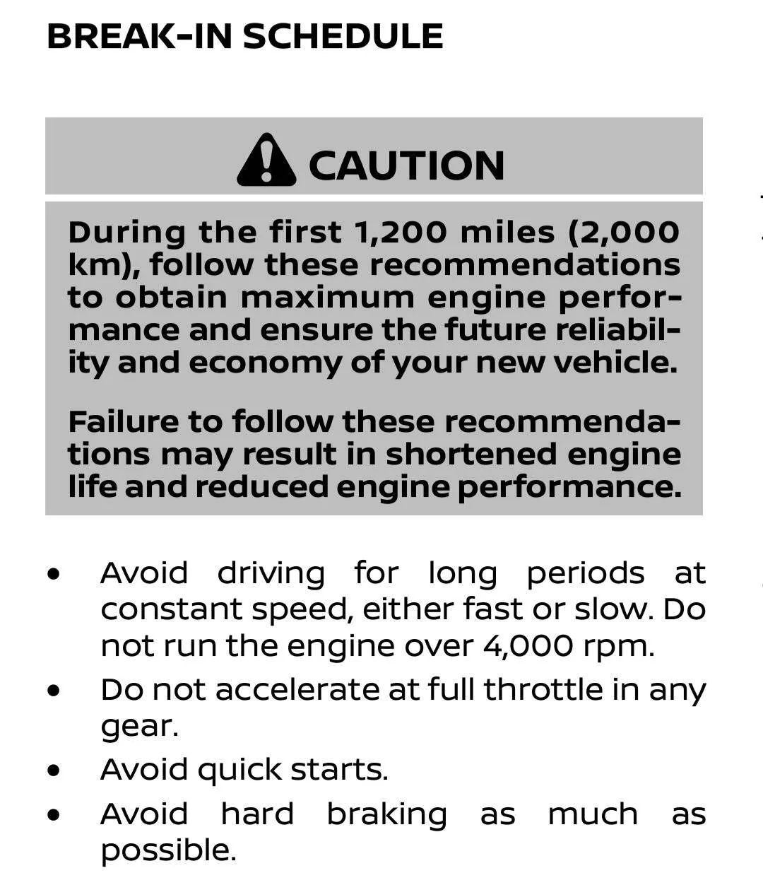

I'd recommend to follow the advice on the manual for breaking in, which says 1200 miles
Thank you for the advice. I did not have any trouble keeping the RPM's low-it goes 60 mph at about 1600RPM's. It is an automatic. I need to investigate the miles for break in. The dealer said 1000 miles beak-in and oil change. Others have said 500.
1200 miles cannot hurt and is more conservative. At my age I will not be driving this one 20 years but I do want to take care of it.

Yeah. Up to you. I just wanted to share the screenshot of the manual, to cite my source.
