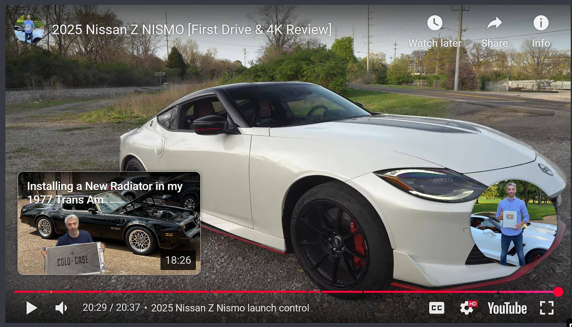

Have you checked to make sure that the shipping spacers were properly removed from front springs? Reason asked is your front end looks awfully high (as mentioned in vid) and the gap between tires and fender is enormous, which I understand is unfortunately a common problem with dealers not doing their job correctly during pre-delivery inspection/prep due to them not bothering to remove those shipping spacers before delivery. For reference, here's a shot of my NISMO taken at stock height before lowering was done. As you can see, the gap between tires and fenders is fraction of what yours appears to be in video.

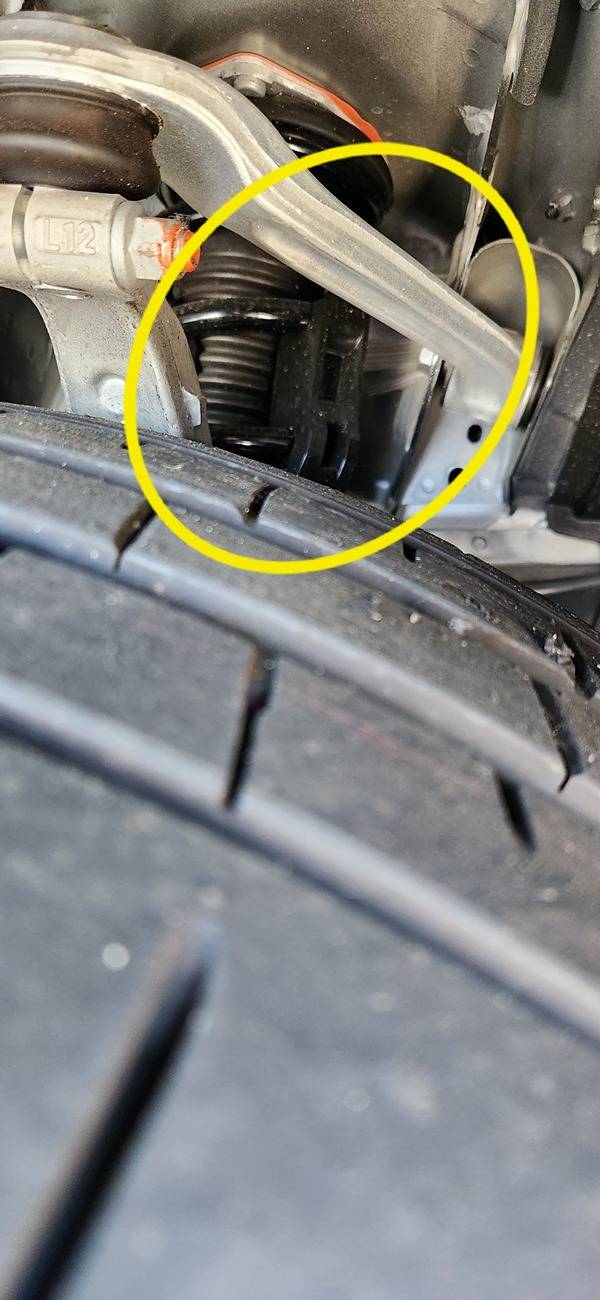

Let me help you ID the transport block that is shoved in the spring. Gotta remove it for it to look better. You can do it yourself by lifting the front end up, or have the dealership learn from their mistake
The '24 Nismo with the Spacer block still installed
I took all my spacers out, and mine doesn’t sit that low. Wondering if driving it 500mi with spacers on the front messed up something. Nissan dealerships- don’t get me started.
you are fine mine doesnt sit that low either
Thanks MCN1SMO… the Silver Z sitting low looked like it had stock wheels & tires. That was what worried me. I’ll just wait & see if the crappy roads around here help it to settle lower. šŸ˜†
