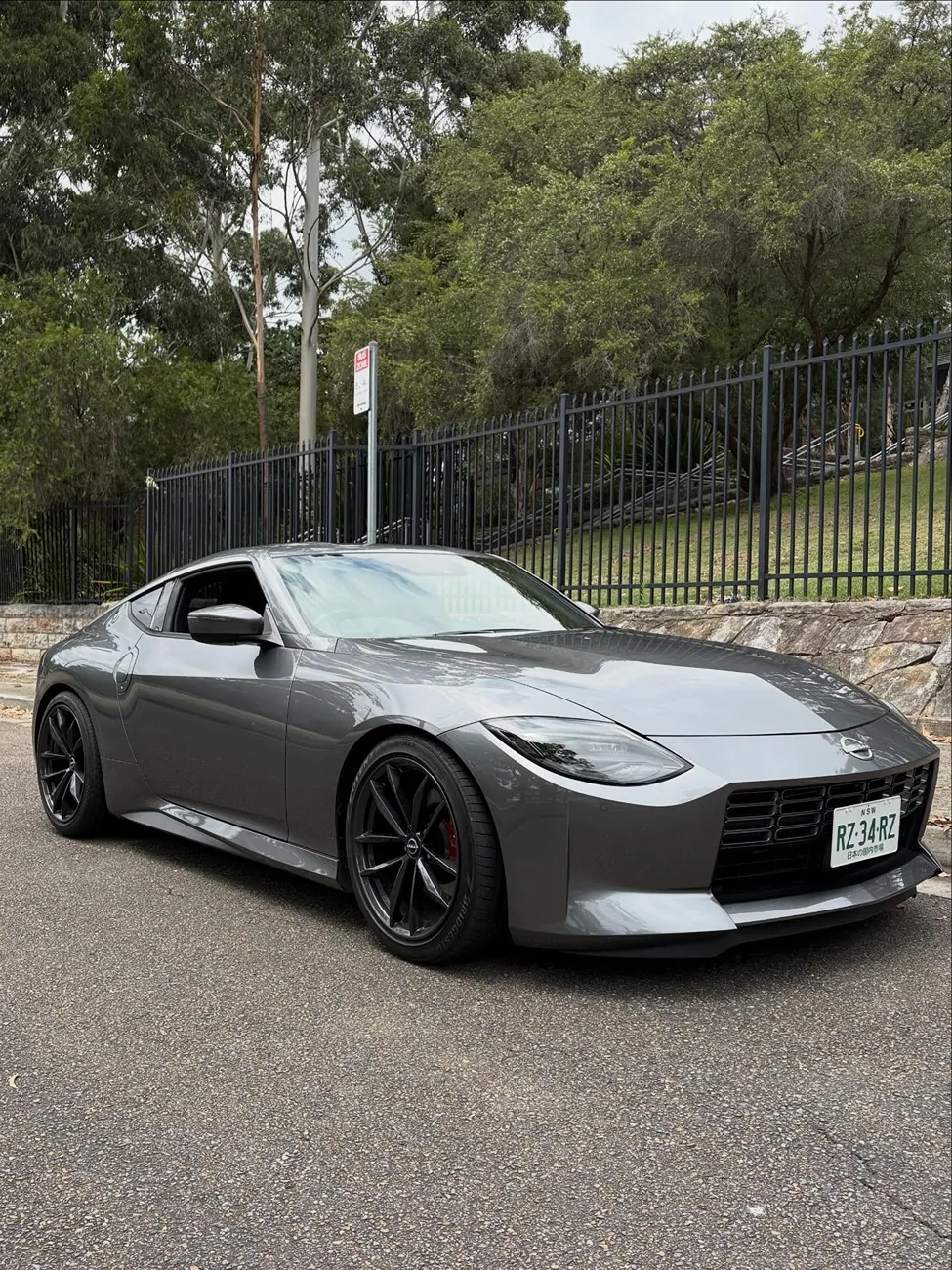

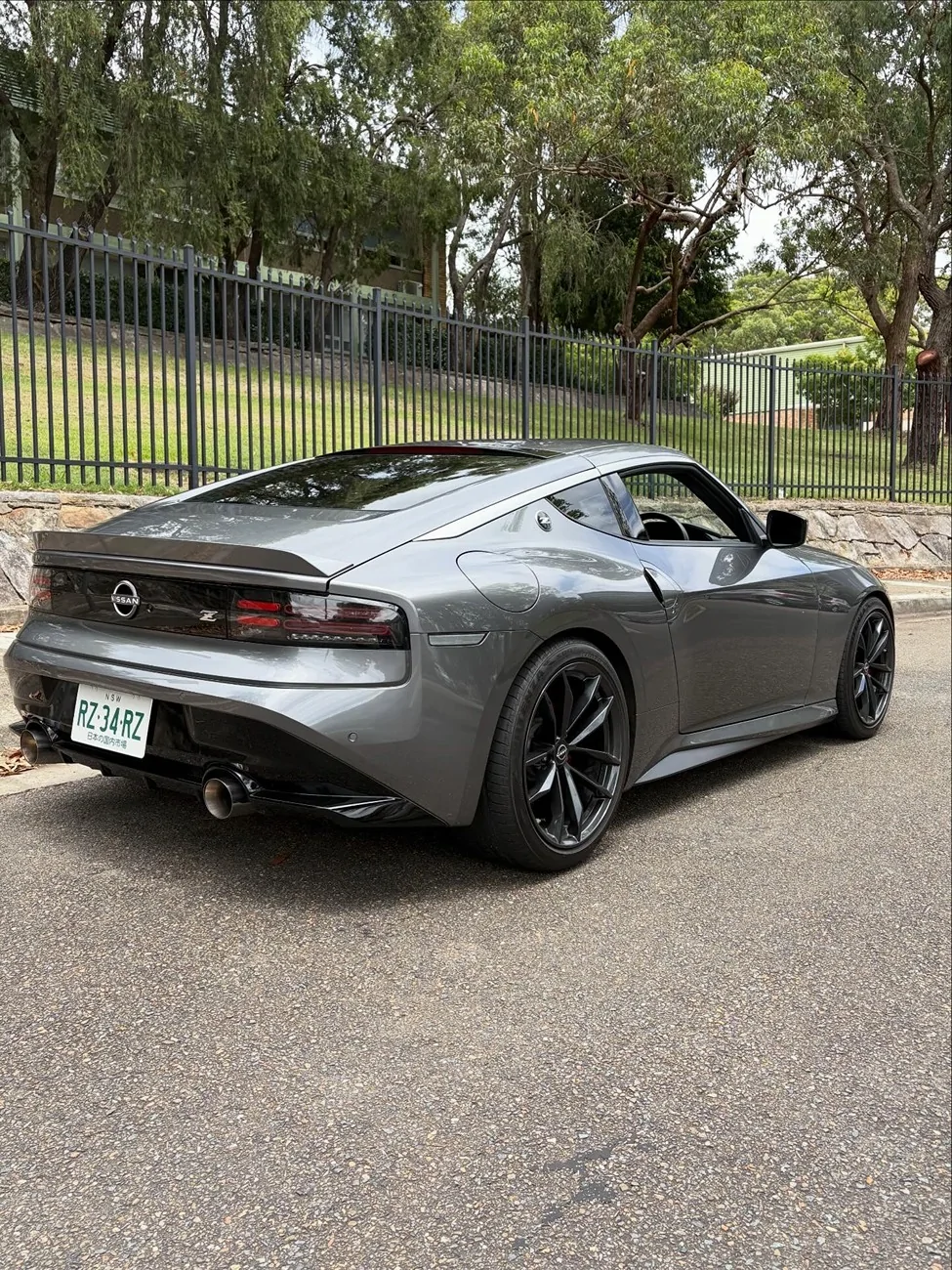

Might as well keep this thread going.
I got my Hypermax R's and installed them. The installation was super straightforward, 5 bolts at the front and 4 at the rear. The only issue I had is that I stripped the nut of one of the rear shock bolts, which is specced to ~120nm. I returned the torque wrench and swapped it for a better quality one to be on the safe side, but the other bolts I tensioned were reading correctly so I'm not sure what the problem was. It's pretty high torque for such a fine pitched thread, and of course the exact nut is not easy to source, so I had to get something close enough from the fastener shop until I can get a replacement nut from HKS.
That challenge aside, the shocks dropped the car by about an inch an a half once they settled. Initially they were extremely stiff and I thought I'd made a mistake by going with the R's, but the ride improved once they settled and now I've backed off damping it's totally acceptable. I'm about -10 clicks from stock (15/30) now, but I think I'll increase the front by 3-4 and the rear by 1-2 and that will feel pretty good for "spirited driving". I don't track my car, but it's also not a daily, so a firm but functional ride is what I'm aiming for.
To finish it off I got the Z1 lowered spacers for the stock wheels and the fitment is just right. I've only driven it enough to settle the suspension before getting an alignment, but even with the angles out of whack I can tell these shocks are game changer. It feels like a slot car in the corners, and I can put the power down so much better from a standing start. I'm very keen to get the alignment done this week and see how it handles.
The spacers are just a stopgap until the tyres wear out, and then I'll go with some aftermarket wheels in a proper offset and some stickier rubber. Love this car!
