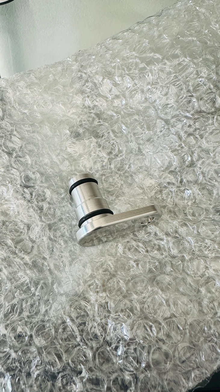

Jack stands will do, just tight to get into. Hoist would be much easier. You will get a soft code that will need to be tuned out.
Wasn't there something else other than just removing the solenoid? A plate or something?

lol “Instructions are not included.”
Not weird at all.
He makes everything himself,
I've had mine installed and my idle sits around 175kpa now, I'm using a GTR filter.
Credit where credit is due… it is a solid bit of billet. I got my mechanic to install it. He said it was straight forward.

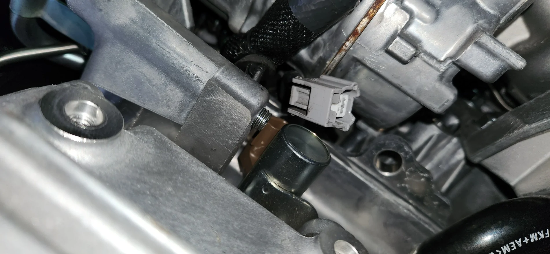

Pic shows the solenoid (Black). Harness (Grey). Connector (Brown). If you do the block off plate, drain the oil first 😉 I dont remember if the bolt can be easily reached from the pic. It will be a few beers and some swear words that you havent used in a while lol
You can get to the solenoid from under the car. The most PITA was to get the harness to unclip. Its facing up. Had to use a 90° pick tool in one hand, and a flat head screwdriver in the other. Pick tool to pull down the fastener clip, while the screwdriver is to separate the harness.
After getting the CEL. I talked to Mark at SonicTuned. He said the solenoid stays closed and the code that showed will not do any damage to the engine. Its only when its opened, it will stop oil circulation and starve the engine and turbo's of oil. Making it a catastrophic failure point.
