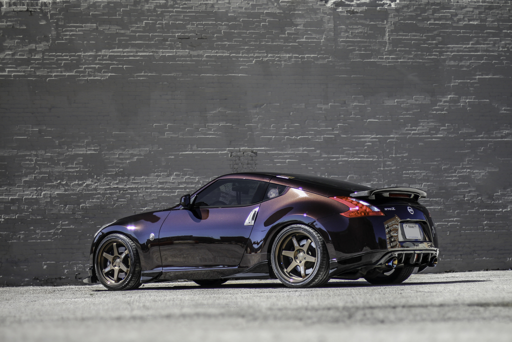

example
this is a Z34 on TE37, 19x9.5 +22 front, 19x10.5 rear. 275/35 and 305/30 on eibach springs
The specs you posted a a bit more aggressive and that is why adjustment should be needed

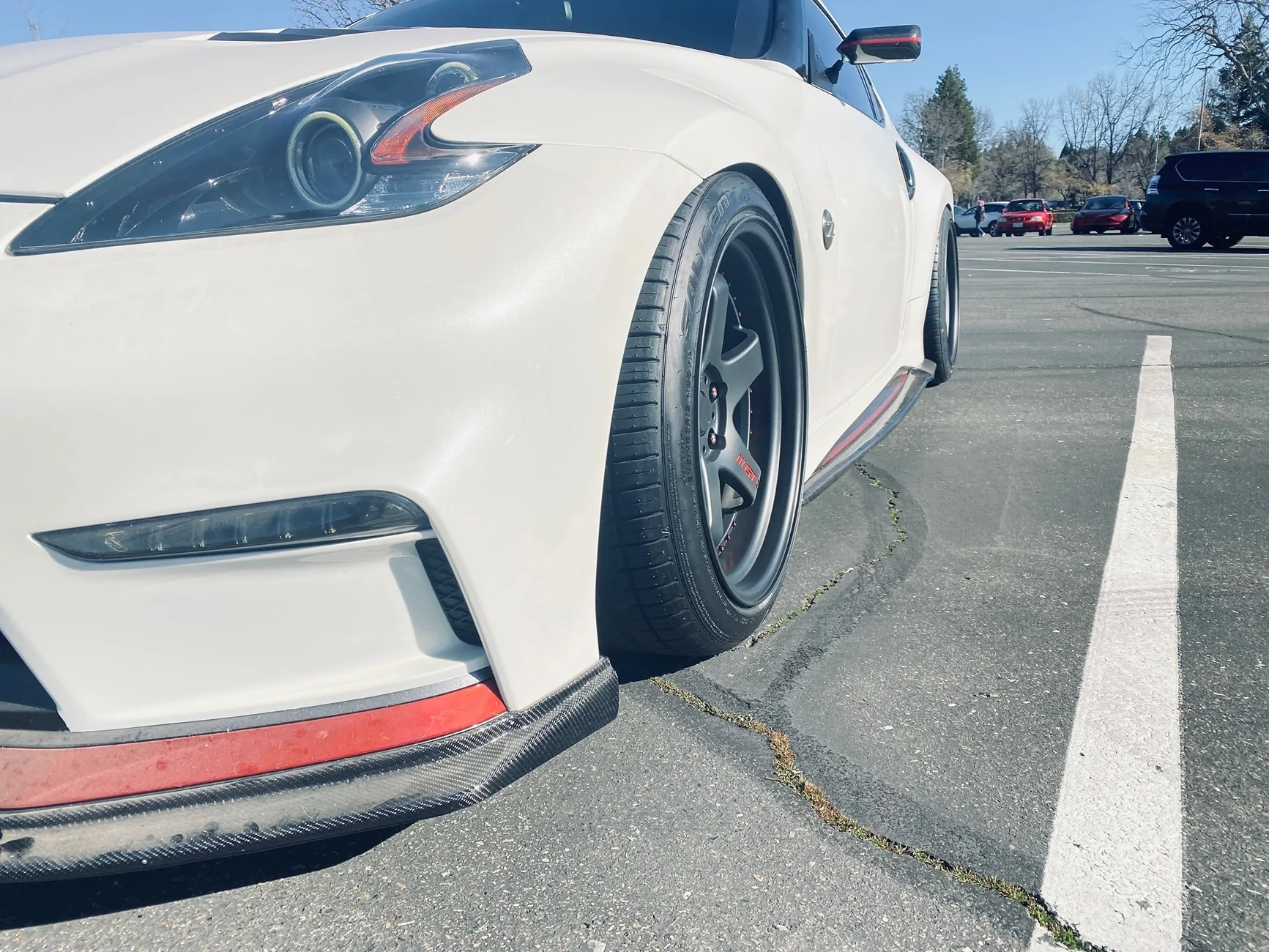

@OptionZero ... What was your camber setting with 20x10/-1 on the front? I assume that was dead-nuts or really close to the clearance limit for a non-molested front fender.
Actually, fits pretty comfortably with my pulled fender and -3.5 camber, 245/40 tire (Falken FK510)
Please excuse the dirty car, this was on pickup from the shop
No rub lock to lock, no on any form of freeway or street driving
I have air cups so speed bumps and curbs are not an issue even with the lip
HIGHLY recommend air cups in front, solves all the problems people complain about here with scraping
