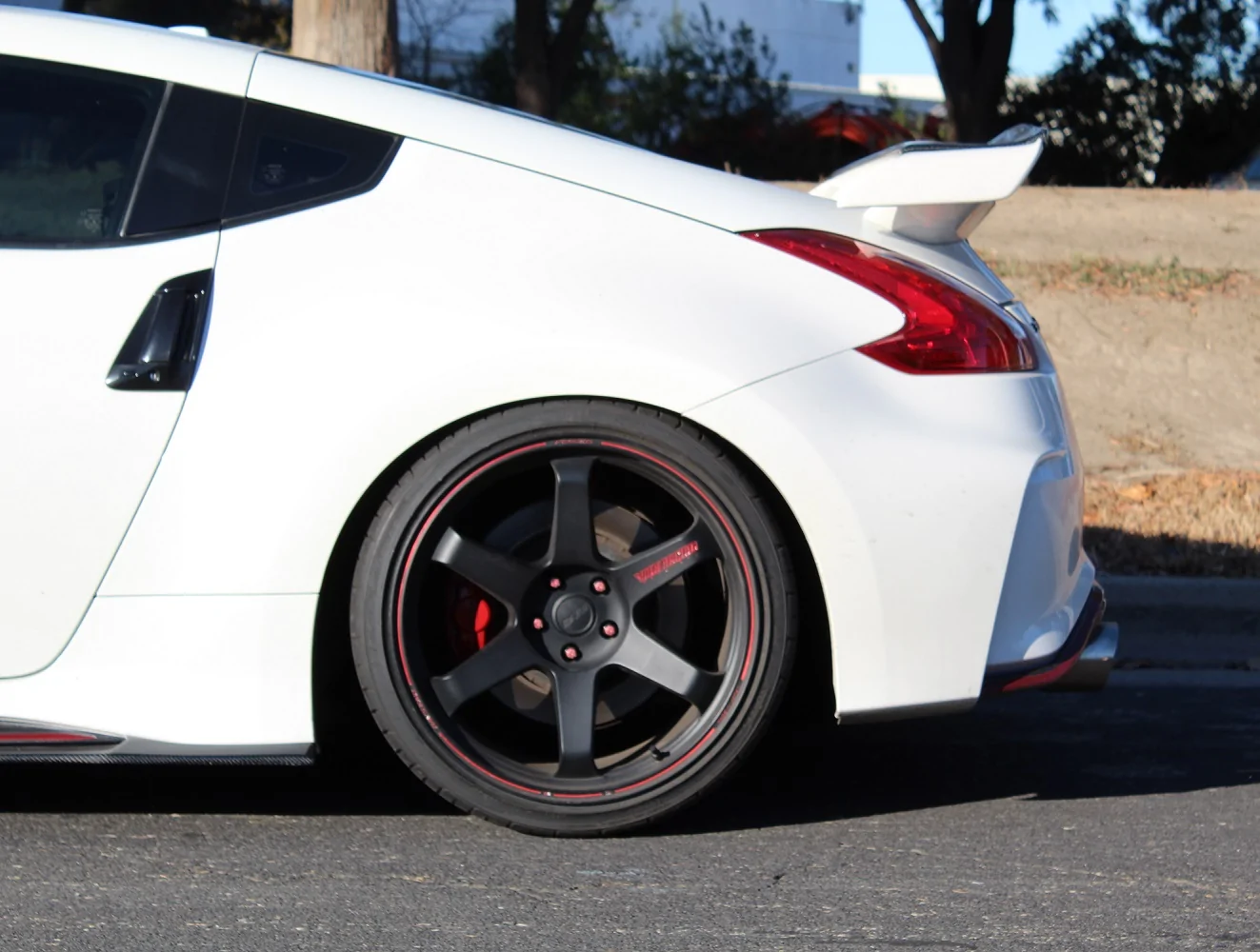

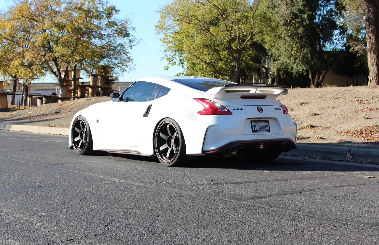

haven't done any measurements but sure seems like they're the same based on fitments floating out there. any minor differences can be accounted for in alignment
also, yes, you can fit 20x12 in the rear
20x12, +20
315/25/20
-2 camber

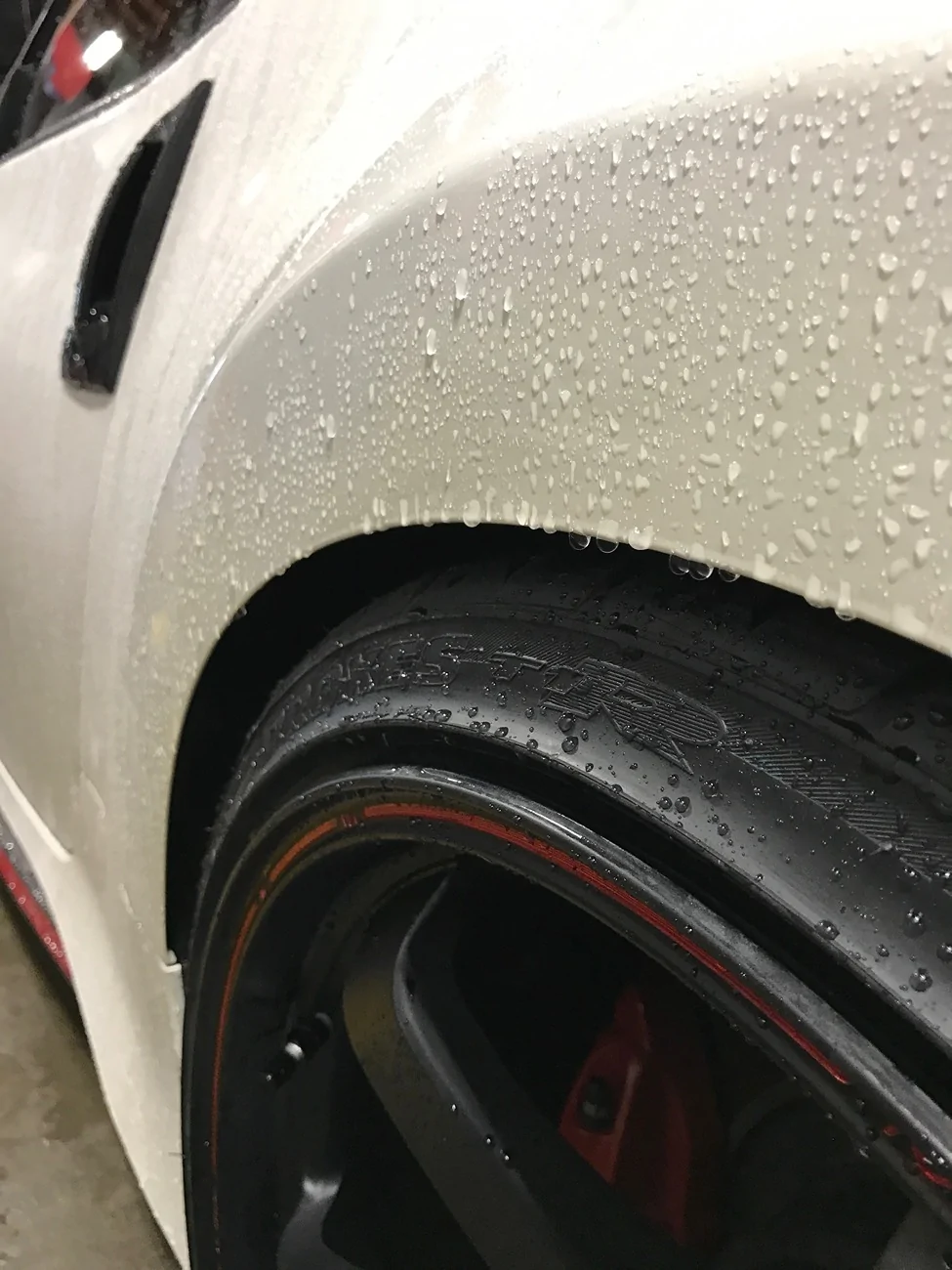

This is where my fitment actually could have been better:
the 20x11, +15 fronts are MUCH more aggressive than the 20x12, +20 rears.
Look at the last pic, you can see a chasm of clearance
I could have done a 325/25/20, EASILY. That was only -2 camber!
Had I gotten 20x10.5 +22 fronts it would have "matched" the same level of poke
(To match the 20x11 +15 fronts i would need to be 5 to 10mm more aggressive in rear)
i don't wanna hear anything about lack of tire bc 315 rears are plenty

No rubbing in rear. As I said, there is a chasm, you can fit two fingers.
Had some rubbing on the front bumper tab in front
Trimmed/relocated the tab
No more rubbing

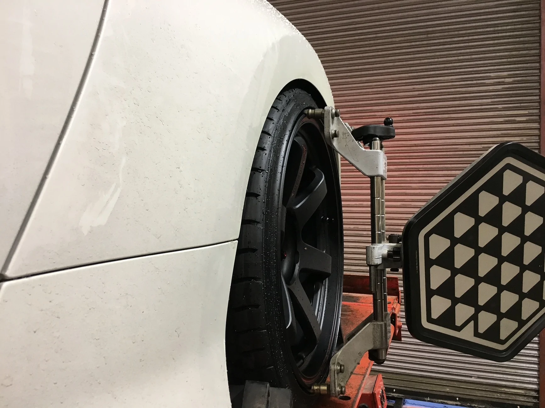

Running an even more aggressive set up now
19x10, -3
245/40/19
19x11, -6
275/35/19
Front fender is pulled
Camber makes a massive difference
