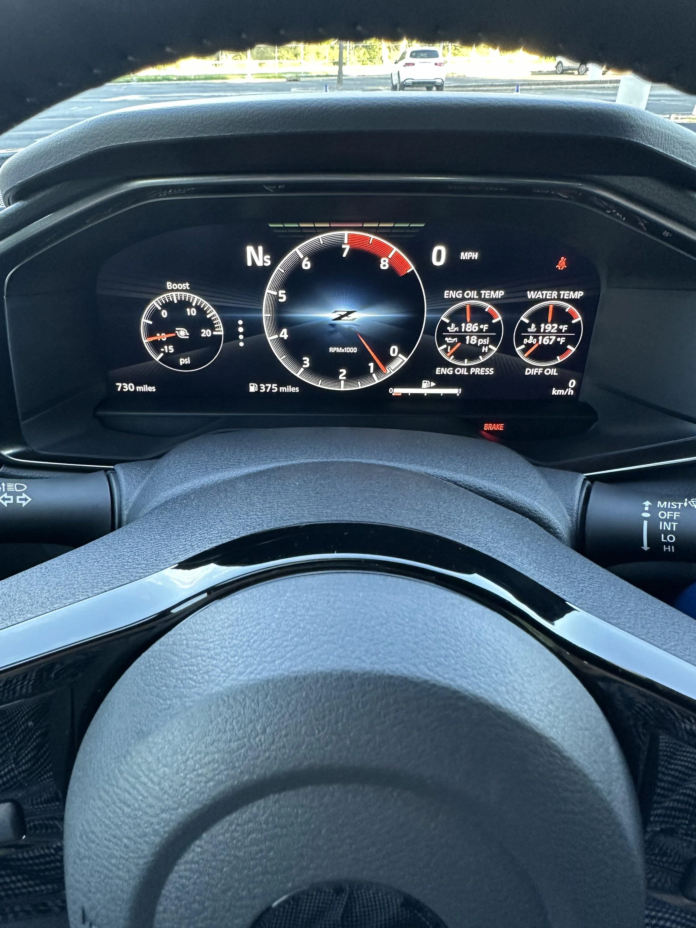

Update: this time I waited until I had less than a 1/4 tank before refilling. Filled up the Z and everything worked as it should, fuel gauge and DTE working great. I think the lesson for this particular Z owner is not to fill unless the tank is under 1/4 full! Ha! As you can see getting close to completing break-in periodā€¦ couple more weeks and will be free to set the demon loose! šŸ˜ˆšŸŽšŸ’Ø
