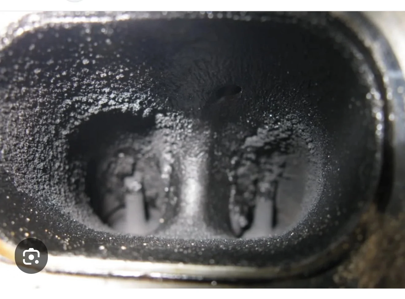

None of these pics are from a VR30... I'd be willing to bet they're from some German vehicle. It took a while for VW & BMW to get it figured out, but eventually even they did.
As I said, a solution looking for a problem.
I too was once paranoid about this because of internet forum rhetoric and pulled my C7 intake manifold off religiously because of it. Know what I found after 70k miles of doing it? Absolutely nothing worth addressing. Heck, I even pulled my C8 intake manifold a few times just to check; same story.
It was actually interesting, GM wouldn't void warranties for headers, intakes, cats, etc. but they'd void a powertrain warranty on the spot as soon as they saw a catch can.
that’s not actually true. The VR30 is known for at as well. I had a Q50 and my tuner suggested the cleaning service that is performed on both the Nissan and Infiniti dealers. The pics above are from random direct injection engines though. But direct injection is direct injection. This is why Toyota started doing duel fuel injection setups. Direct for the mileage and performance benefit and port to keep things clean. Another way to deal with it is water/meth injection. Works on any engine but if meth is used then you have to tune for it.
First off…that was sarcasm, for those that didn’t catch it.
Second…lol!
Searched for ā€œgrenaded engineā€ and it was all v8s, so I changed my search to ā€œgrenaded v6ā€ and it was page after page of BMWs.

Although they look like booger welds made by a 6 year old, all that crust in the intake and on the valves is what they call ā€œPower Poppers.ā€ They’re concentrated petroleum nuggets. Highly explosive. When they get big enough they fall of into the combustion chamber and BOOM, like +40hp. It literally only lasts like 1/60th of a second though, so you never really know.
Either that, or they fall off, stick to the valve seat and you lose compression. Not all of them are honorable enough to go out like warriors.

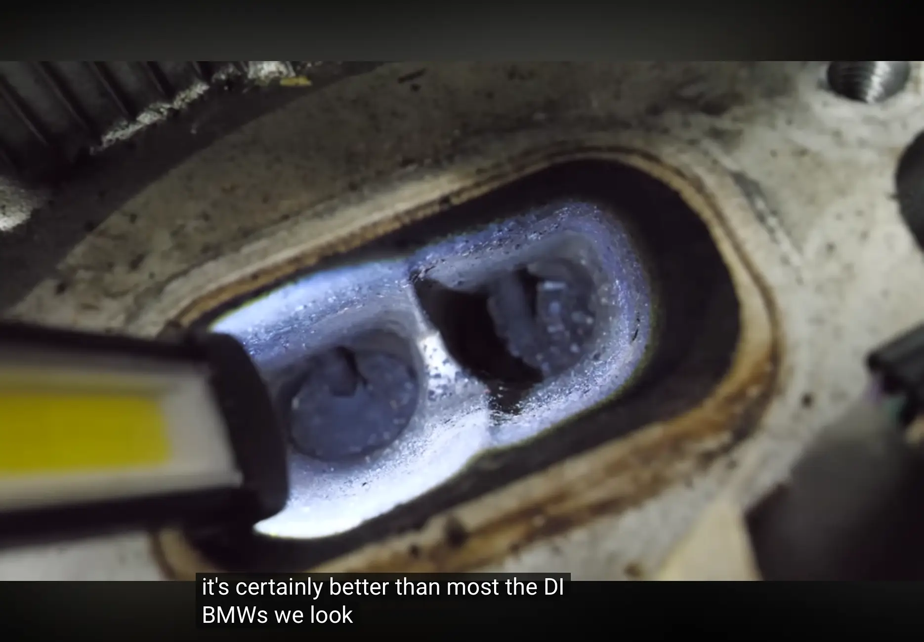

60K miles on a VR30DDTT with no catch can below, thanks to ā€œI Do Cars.ā€
Couldnā€˜t find a comparable pic with a catch can.
