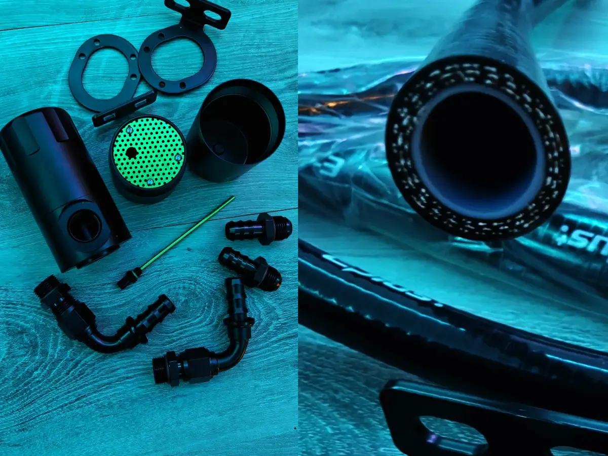

Do we need them? IMO YES.
Do we need them on both banks? IMO YES.
I saw on multiple intake installs videos that there is oil in the hoses. This one shows it in the passenger side. @ 4:14
I got 2 high quality catch cans, Silicon hoses and fittings for $120 from AliExpress.

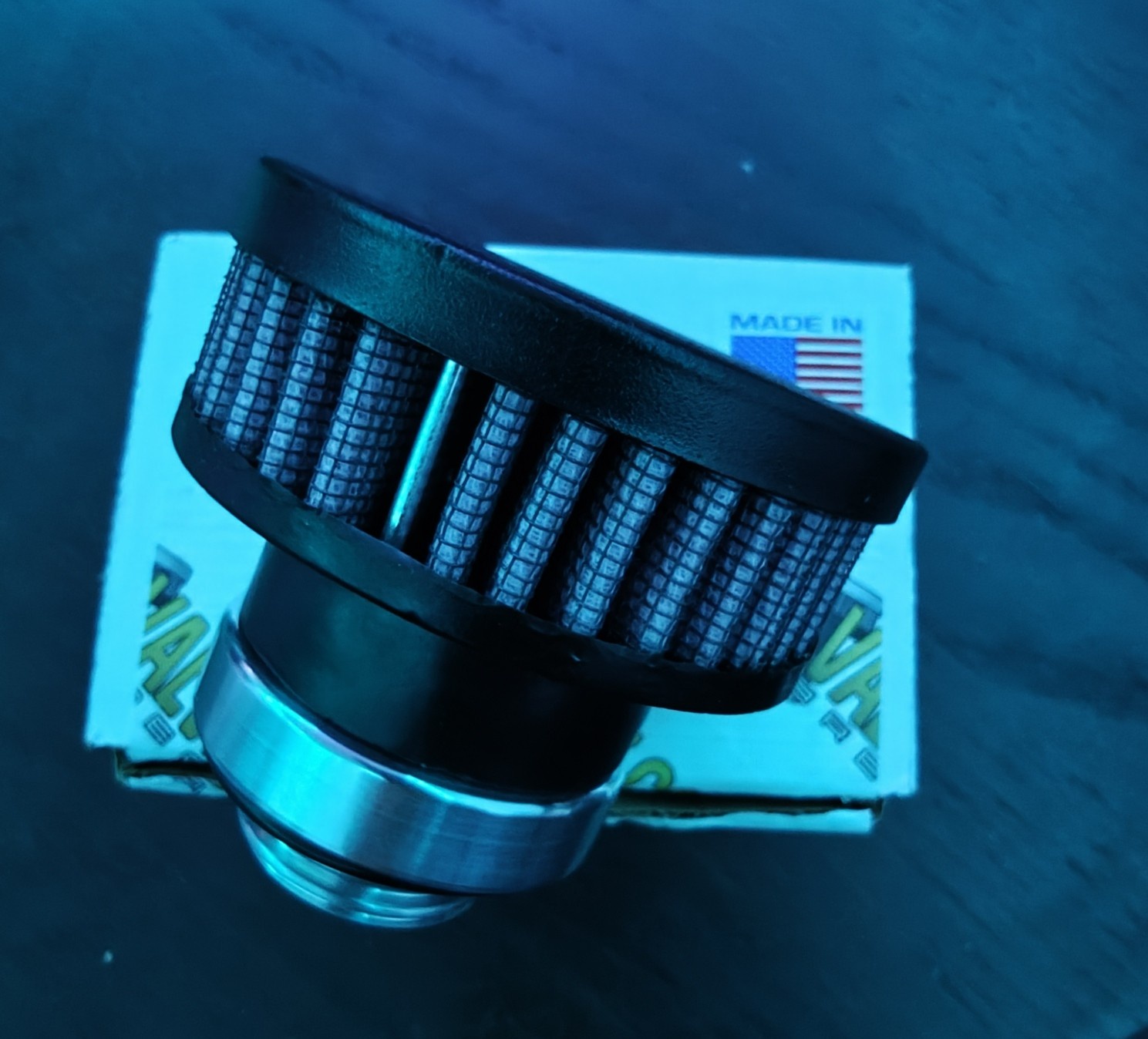

Also I got this for any increase in crankcase pressure.

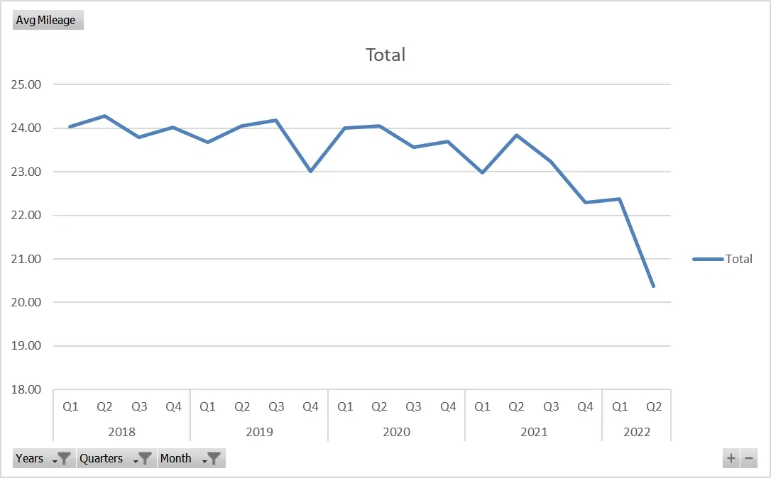

Kind of my angle with the life of a Direct vs Port engine, although I don't know of any testing to back it up. Stuff in the intake and valves is going to hurt performance as it builds up.
For gasoline engines, the MPG difference between direct injection and port injection is about 2%.
Criteria:
- 15K miles per year
- 25 mpg (DI) / 24.5 mpg (PI)...2% less for PI
- $4/gal for gas
Yearly gas cost:
- DI = $2,400
- PI = $2,449
So you spend $49 more per year with the MPG inefficiency of the port injected engine.
Decrease in mpg due to buildup on a DI engine can be 1%-2% or more per year, and cumulative, so by year 4 you could be at 23 mpg, where the port injected car's still running a smooth 24.5.
Not saying without catch cans your Z will be dead in 60K miles. But personally I think it's a relatively small measure that could provide long-term benefits.
This is an MPG chart from a WRX owner asking what's going on (original thread here). He didn't respond that he had the valves cleaned, but a commenter detailed their experience/results before and after what they thought was this same scenario. Not saying this is all true and should be used to make decisions about what you do and don't do, but it's par for the course for the gas DI experience. I think VWs are known to build up pretty quickly.

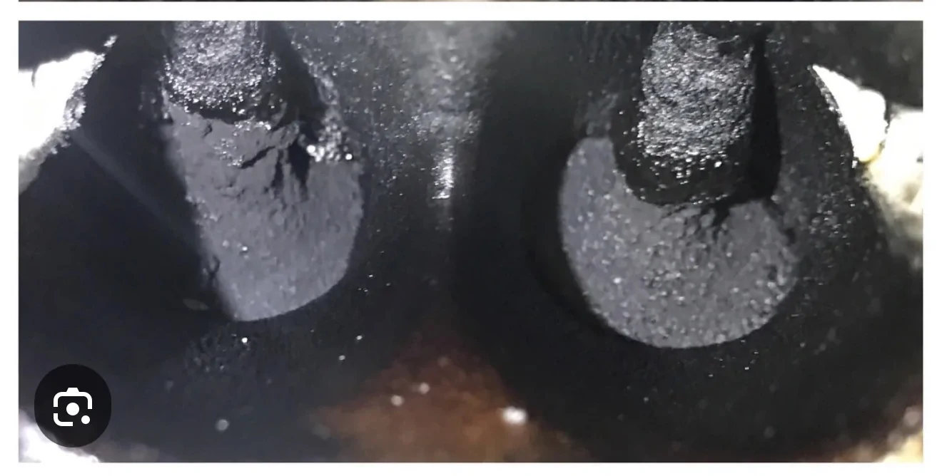

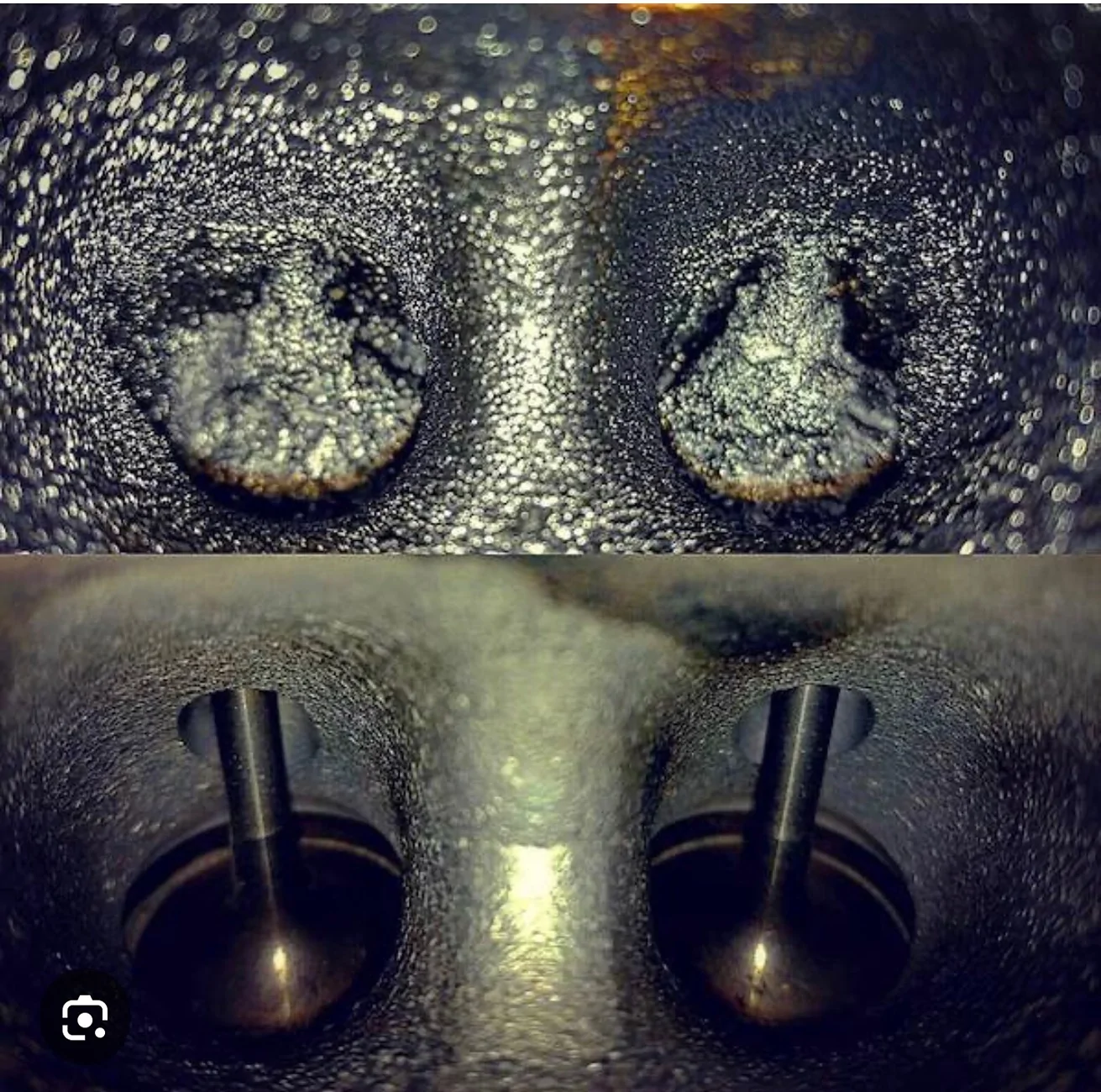

Here is Direct injection. Doesn’t happen on port injection as the atomized fuel cleans everything. The second pic is a before and after with professional cleaning

None of these pics are from a VR30... I'd be willing to bet they're from some German vehicle. It took a while for VW & BMW to get it figured out, but eventually even they did.
As I said, a solution looking for a problem.
