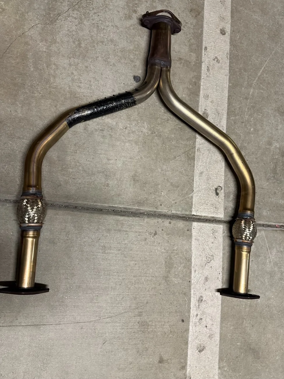

I've been getting a mild burnt plastic smell ever since since I went on a 6 hour road trip right around 3k miles. It smells very similar to a hot glue gun warming up. I'm at 4k now, and it's been doing it for about a month, Checked oil, it's fine.
The smell is mild in cabin, but noticeable if I roll windows down or open driver's door. I've popped the hood while noticing it- It doesn't seem like it's coming directly from the engine bay. I've looked under the Z and don't see anything obvious (melted plastic, dripping fluids, etc). It happens even after a short drive (10 miles/20 mins)...

I’m very similar milage. Just over 4K. No, theres no strange smells that I’ve noticed. By now any RTV from manufacture and new hoses should have gassed off.
I’m of the mind that something plastic has melted on your exhaust manifolds or Cats that you can’t see. Maybe a plastic bracket, plastic pop-rivet or a zip tie type thing.
Cats run at 900F+ in normal operating temps. I know from previous experience that they would melt plastic instantly so it sticks to them & takes forever to burn away completely. The smell is very noticeable after every drive when that happens.
I’m not racing my Z around much. First 2K miles were break-in. I still mainly cruise it around at 2-3K RPM with the occasional pull building boost on an on-ramp or when passing. I’ve not redlined it (yet). I rarely see over 175-185F oil temp. Diff runs similar temps or slightly less.
Does your drivetrain oils / coolant temps run hot? What are typical readings for coolant, engine oil, and diff oil temperatures after it’s warmed up and you get the smell? Might be worth comparing them to a similar year & trim owner to see if any differences stand out.

You were 100% right. Great call.
I swapped out the exhaust yesterday and found the culprit (attached photo)
What really pisses me off is that I took it to Nissan for an oil change service, and explained the situation in detail as I did above. Asked them to look underneath for a signs of “melted plastic” or “plastic touching metal” and they said “couldn’t reproduce smell” and - “inspected under car found no signs”.
As soon as I jacked the car up, got underneath, and took one look, I was like those lying, lazy MFs!

Look like they forgot to take off a label
From my experience, it’s a black plastic bag he ran over. If you run over a bag, look behind & see if you can still see it. That’s what happened to me on my 370Z Nismo. I couldn’t see the bag anymore- so I at least I knew. Smells terrible & takes months for that plastic burning smell to go away 😂
