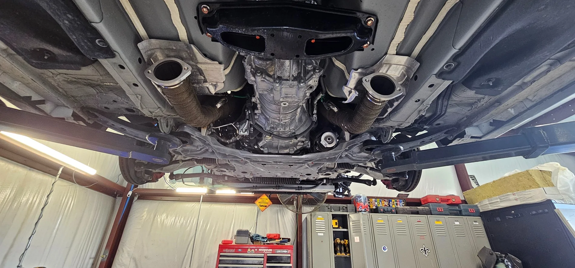

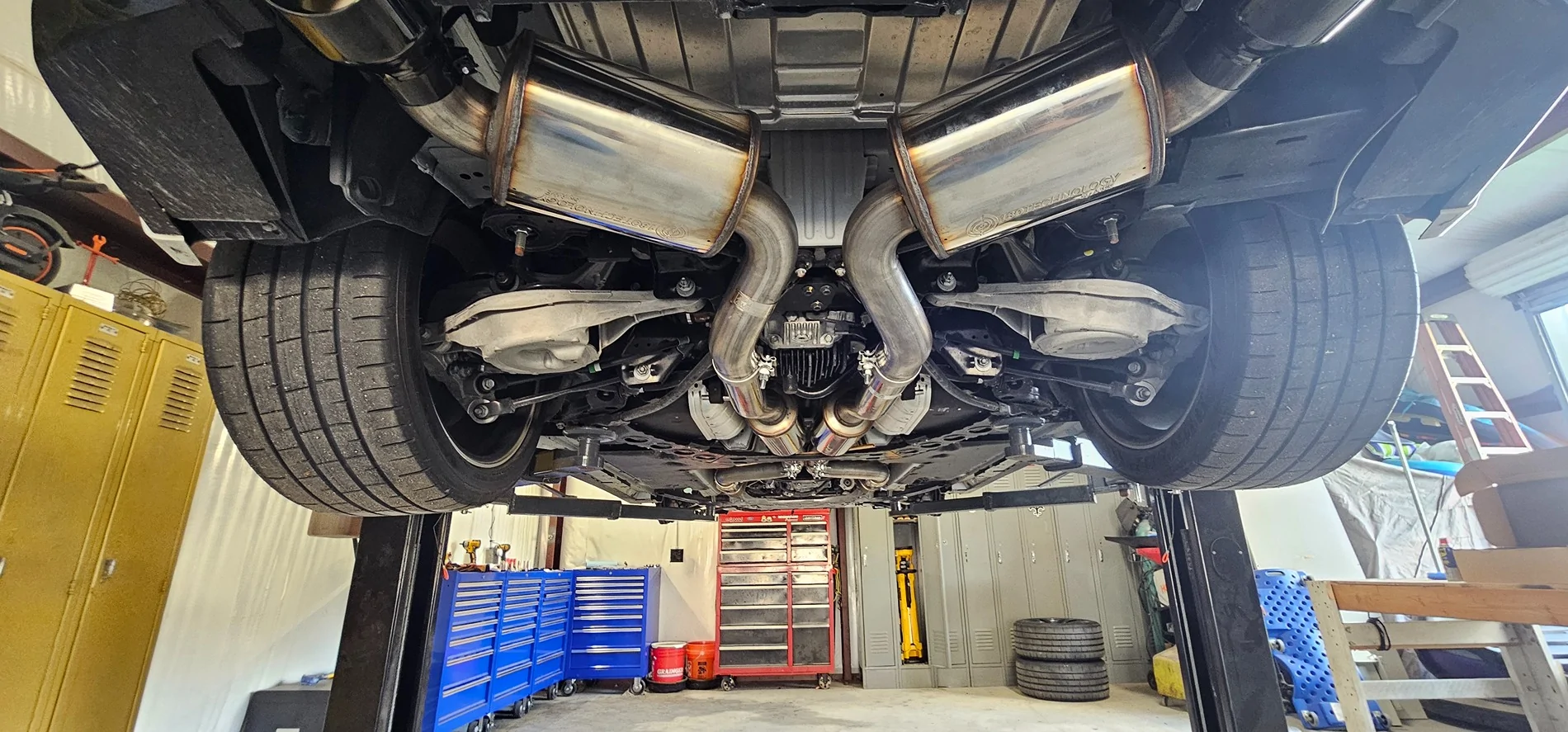

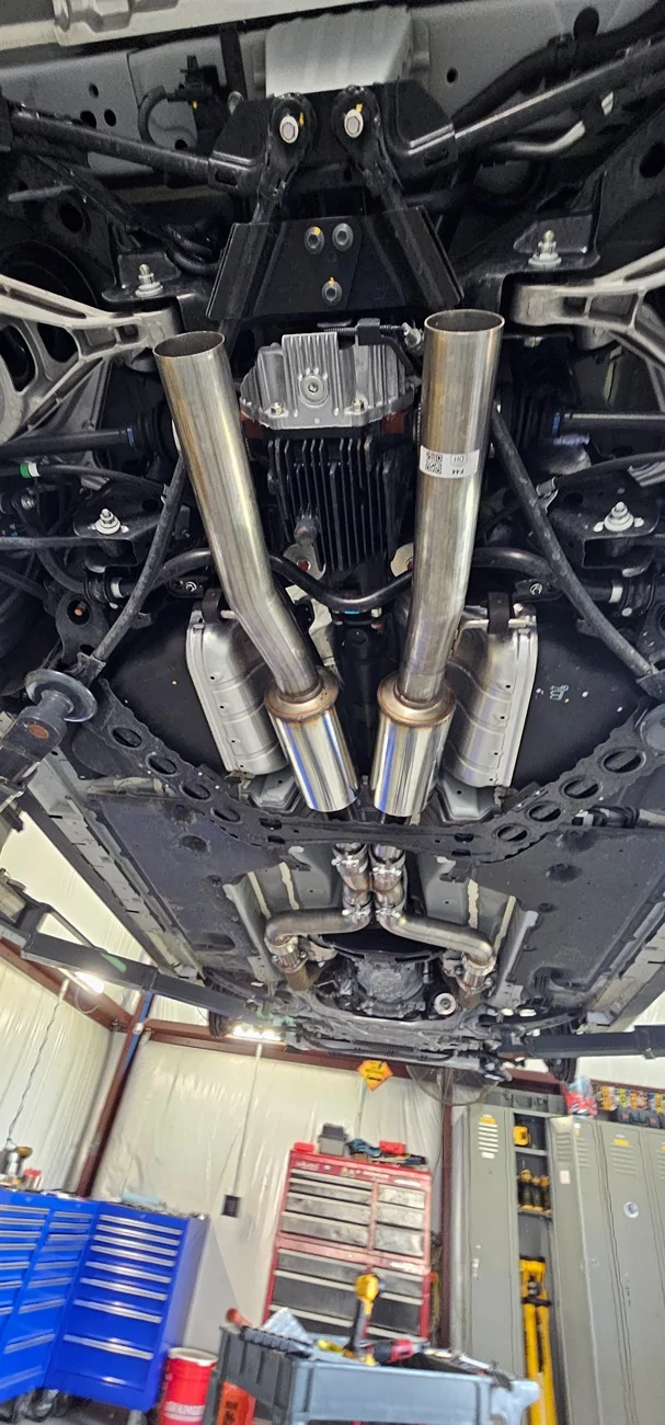

Thank you for all the pictures! Good call on wrapping your downpipes. I'll probably do the same, and also the AWE near the rear diff since it looks rather tight, along with near the emissions solenoid to avoid having to relocate that with their goofy adapter/hose.
I have a Stillen rear swaybar to get installed while the exhaust is off, too.

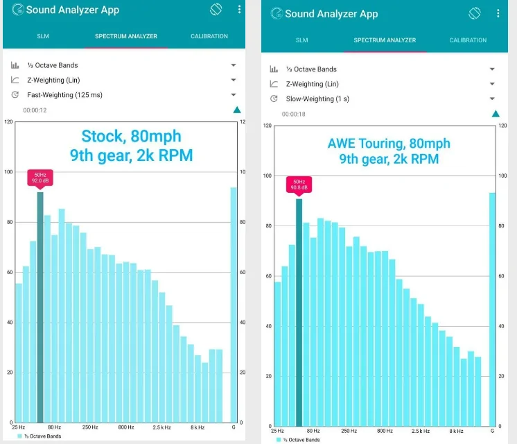

Our Touring Edition system does not drone.
I have an Automatic Sport trim. This drive train drones at 1700-2100 rpm which is right where the needle sits when going 75-85 on the highway in 9th gear. This will obviously not be a problem for manual transmissions on the highway, if it has the same noise in that rpm range.
For me, the stock exhaust was rather unbearable. The AWE Touring is significantly better but the same drone in the same range is still present. I suspect it is caused by the turbos since the noise instantly goes away when you let off the gas.
Not a super scientific measurement, but I took screenshots of a phone app:

Wow, that is super interesting, thank you for sharing that! It appears than the AT runs about 1k RPM lower than the MT at ~80 MPH (I think 83. MPH is 3k RPM).
