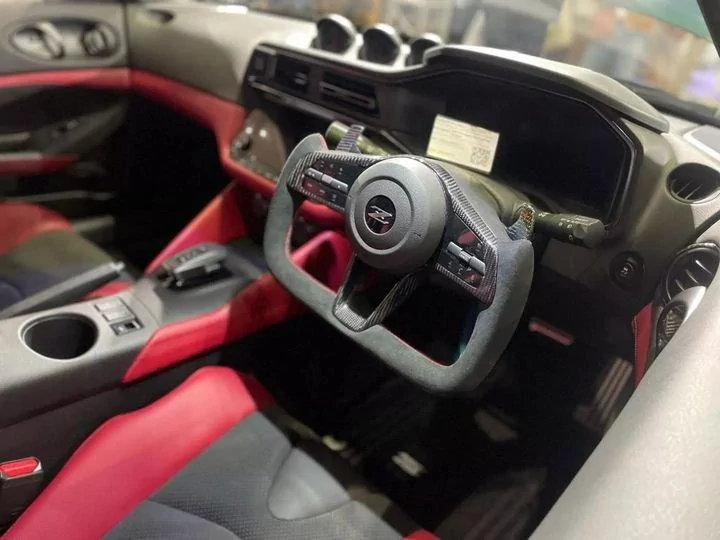

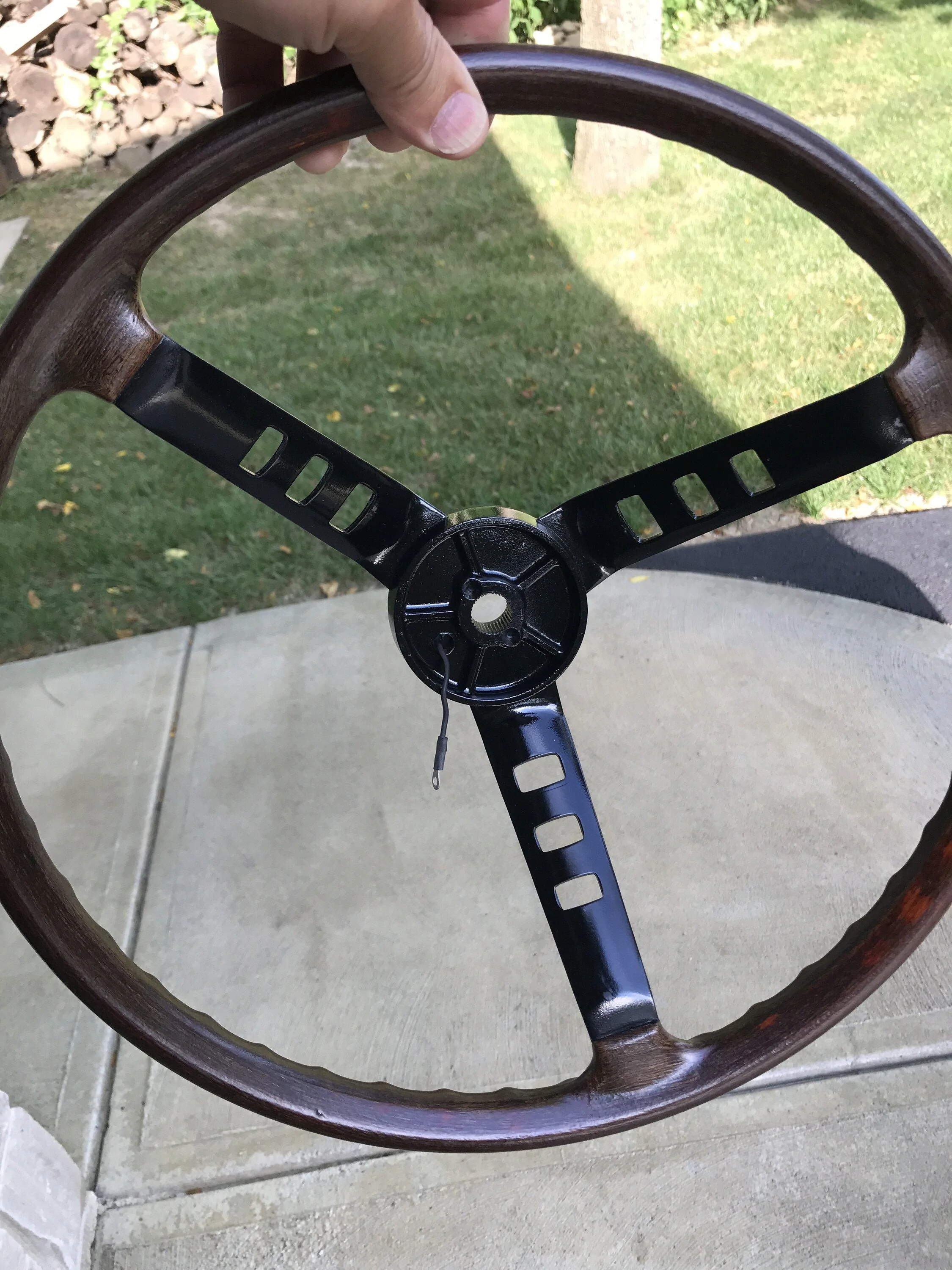

I saw this one on facebook today
Any takers?
Hard pass on the yoke. The stock wheel feels really good to hold imo. I didn't buy into the GTR-inspired back story, but they might have been onto something.

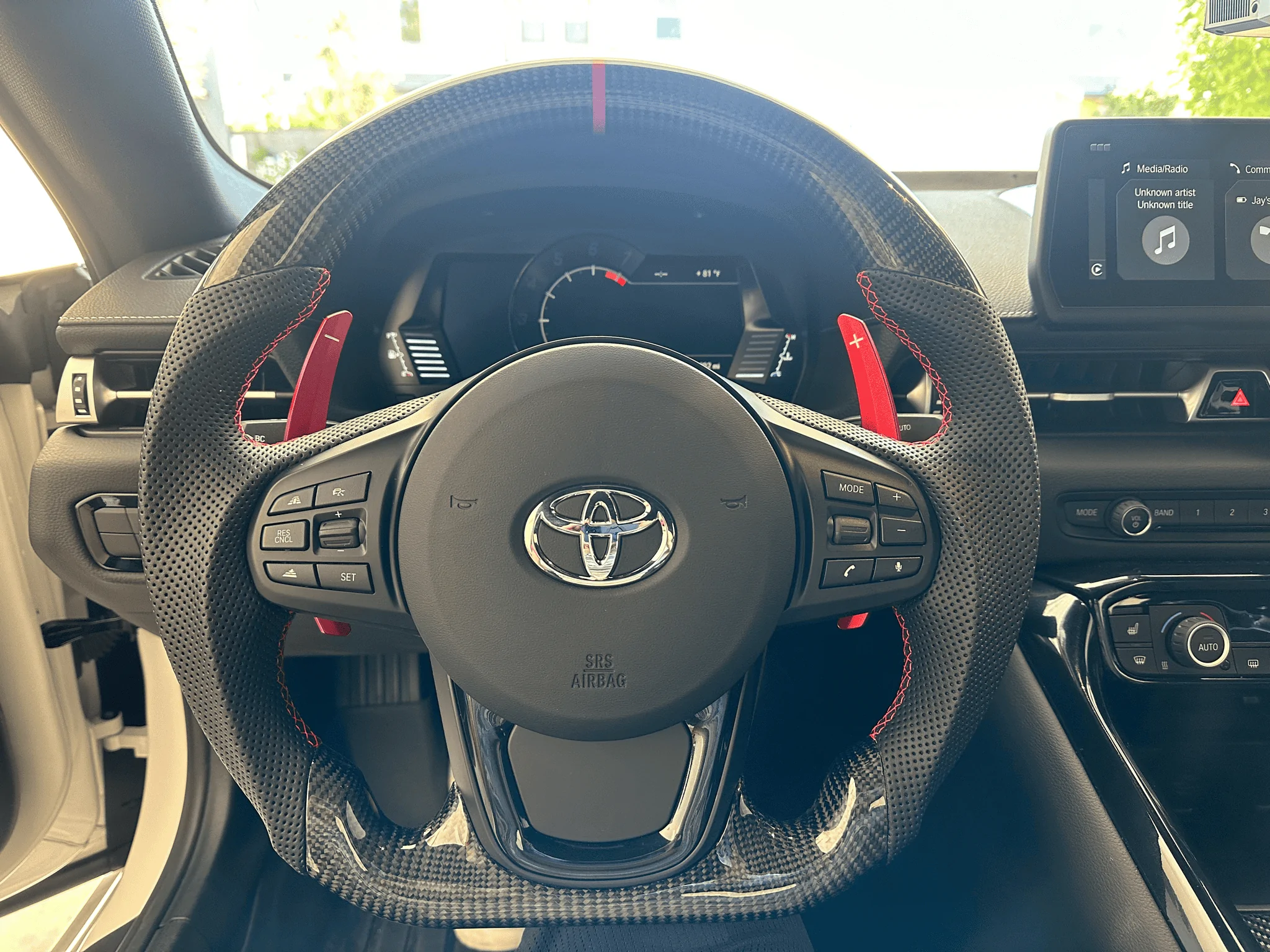

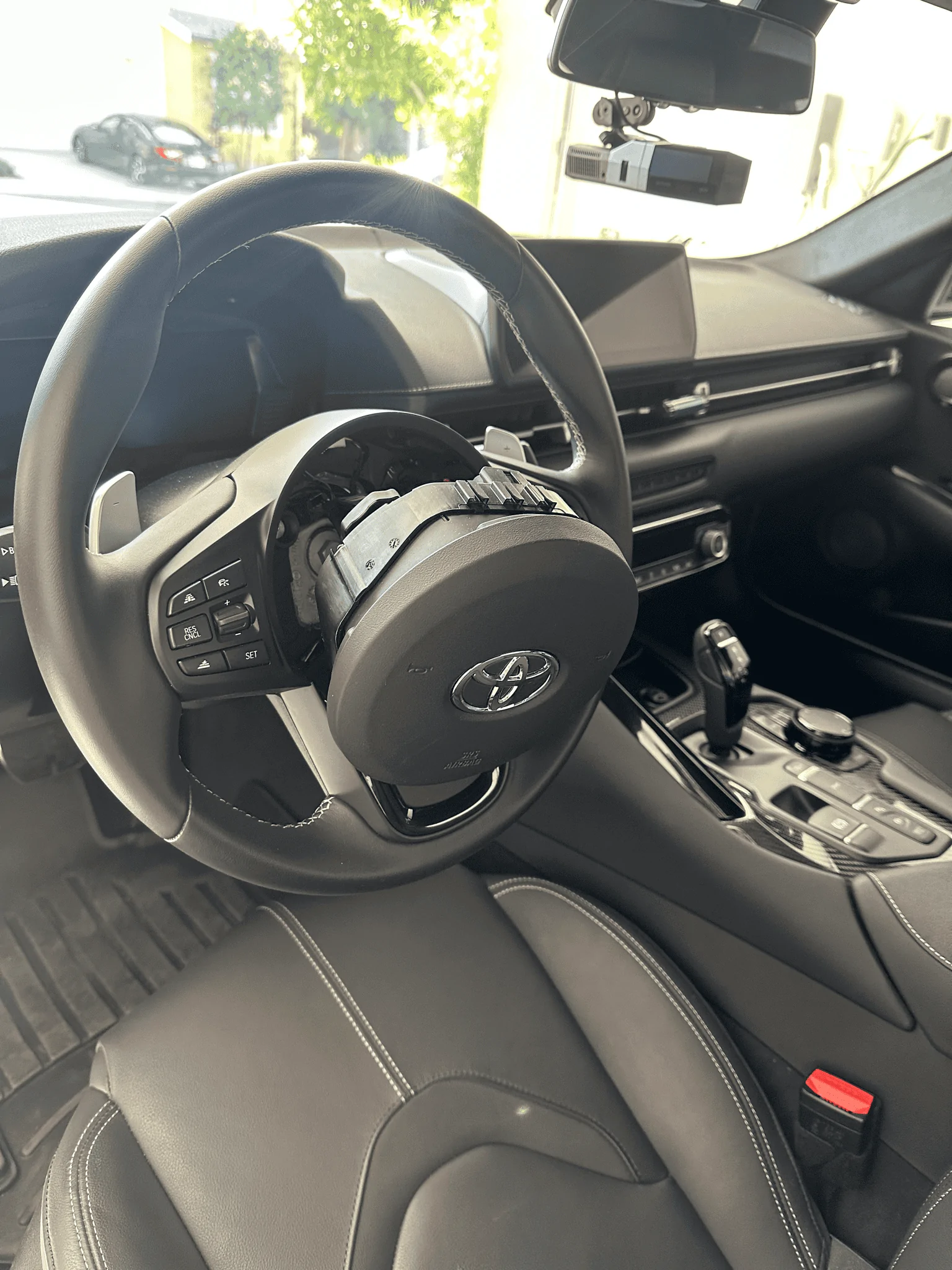

Having done it on the Supra, I probably will… if I ever get my hands on a Z. Not difficult to do at all with proper tools and nice way to customize the wheel how you want it. But not a fan of the 1/2 cut wheel design.

That looks rather nice. Who makes that? I'd be interested on doing this with the Z if all the factory controls are retained.

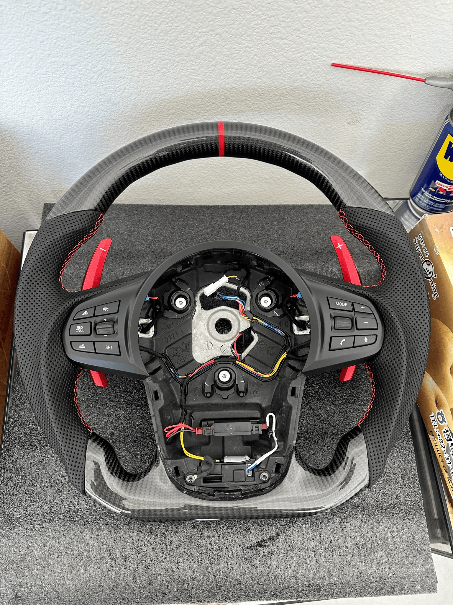

I purchased the wheel and paddle shifters from a vendor on the MKV forums (A90shop) but seems just about every vendor over there offers the same type and customization. I bet many Z vendors will do the same.
All of the buttons are factory - I had to take apart the stock buttons/trim and stock paddle shifters to transfer the spring/lever mechanism to the red aluminum shifters and then reassembled everything on the new wheel.
About 1.5-2 hour install if you have proper tools - flathead screwdriver to release the airbag, impact wrench (for the loctite bolt that holds the wheel to the steering column), torx and screwdrivers.
