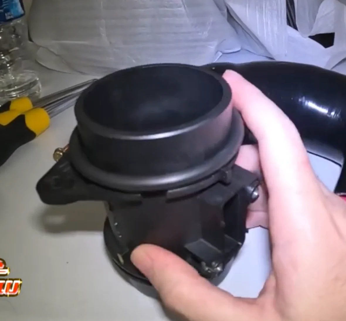

tried it on dyno with no OEM filter (lost power)
got a copy of the dyno ? where did it loose power? - if it lost down low, it must have had gains up top - similar to 3” b6
Most modern cars will lose power without a filter. The filters work well to smooth the airflow and make it less turbulent for accurate/stable MAF readings.
