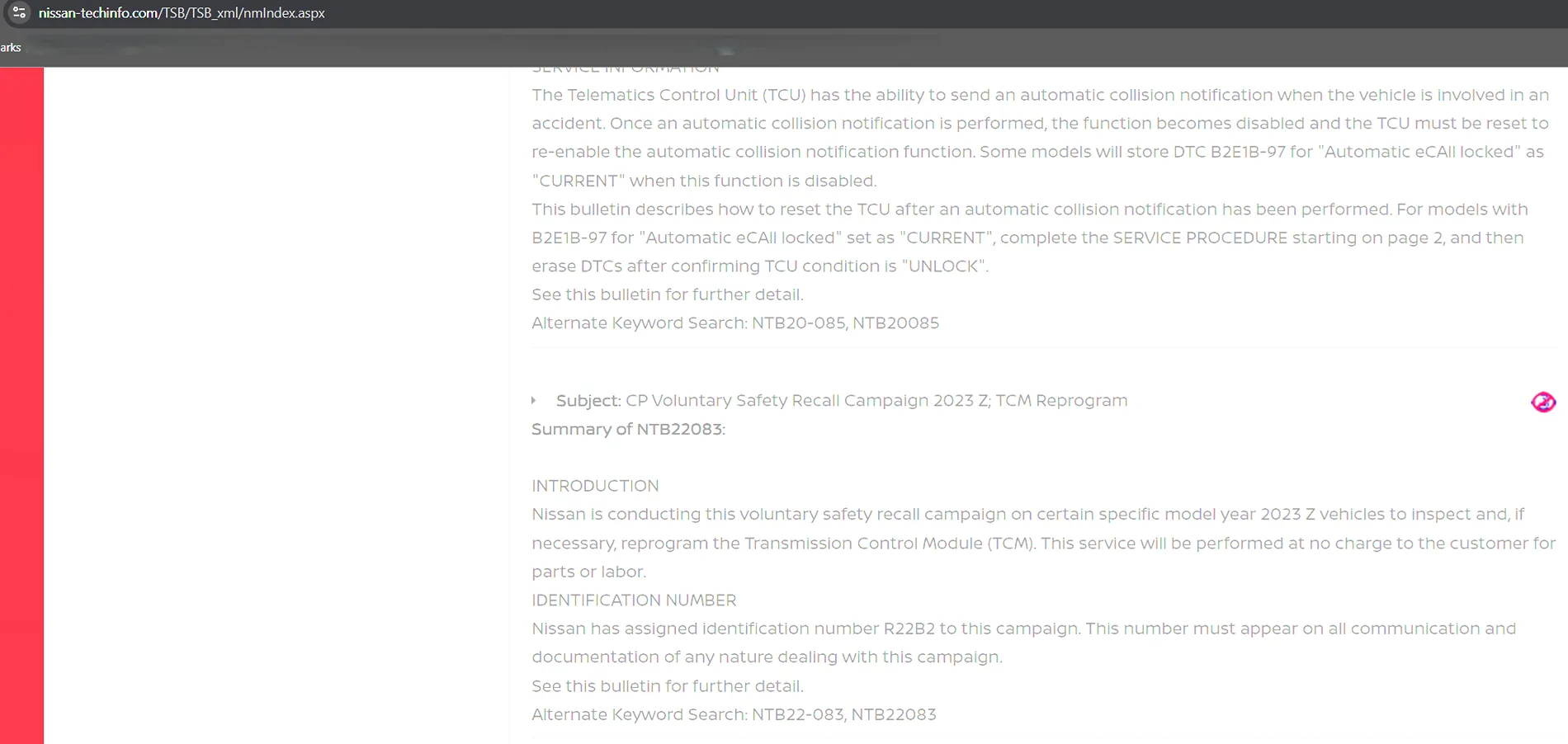

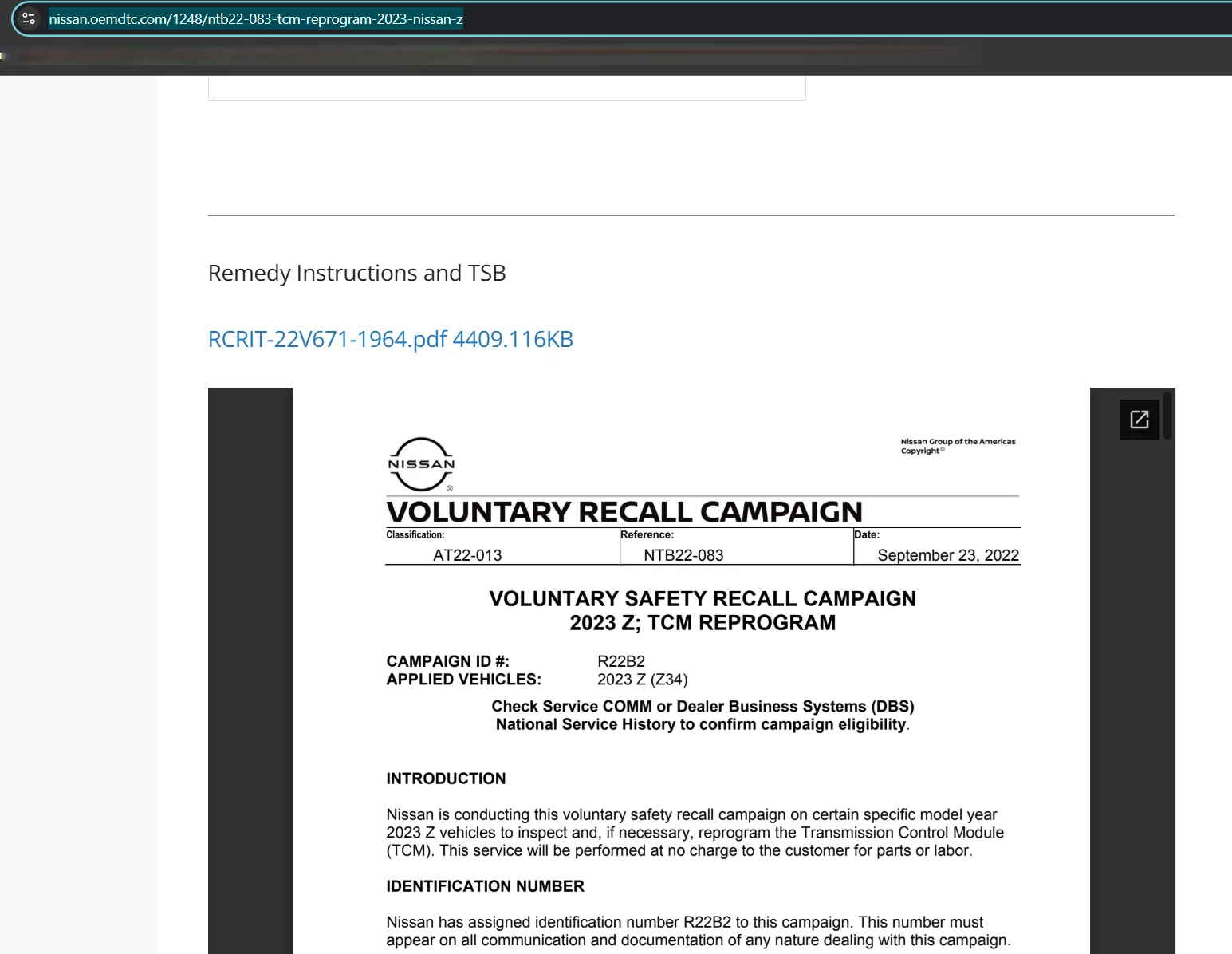

Hey guys, I know that this thread is a little bit old but. I notice the same behaviour of lurching when the car is close to stop.
I read in other forum (https://www.newnissanz.com/threads/z-jerking-nearly-any-stops.2317/) that this was solved with a software update, But it doesn't give details other that the lurching was solved. So I visited the web page of nissan to check if there was a recall, and search for the VIN number and this said that there was not recalls for my vehicle. So I googled some releated words with recalls and service bulletins and luckly I found a page, that looks legit (not 100% sure) that if pay and you get subscribed, you can access to files of Service bulletins and recalls from nissan (https://www.nissan-techinfo.com/TSB/TSB_xml/nmIndex.aspx).
Fortunately this allowed me to search for this service bulletins. So I used the code of the recall and google it and I found this other web page (https://nissan.oemdtc.com/1248/ntb22-083-tcm-reprogram-2023-nissan-z) that indeed says that there is a "voluntary recall campaign" for reprogramming the Transmission Control Module (TCM). If you visit that web page and scroll down, you will be able to download the pdf with the campaing.
Below you can find screenshots of the web pages that i visited and the PDF
Unfortunely due to work I wont be able to check this with the dealership and also in Mexico the service of mechanincs of dealerships kind of sucks so I hope this info helps next time you send your Z for service and find out if this reprogramming of TCM solves the lurching issue.

Best is to bring it to Nissan dealer and log a complaint. Dealers get special bulletins which are not published publicly. It’s covered under warranty then why guess.
