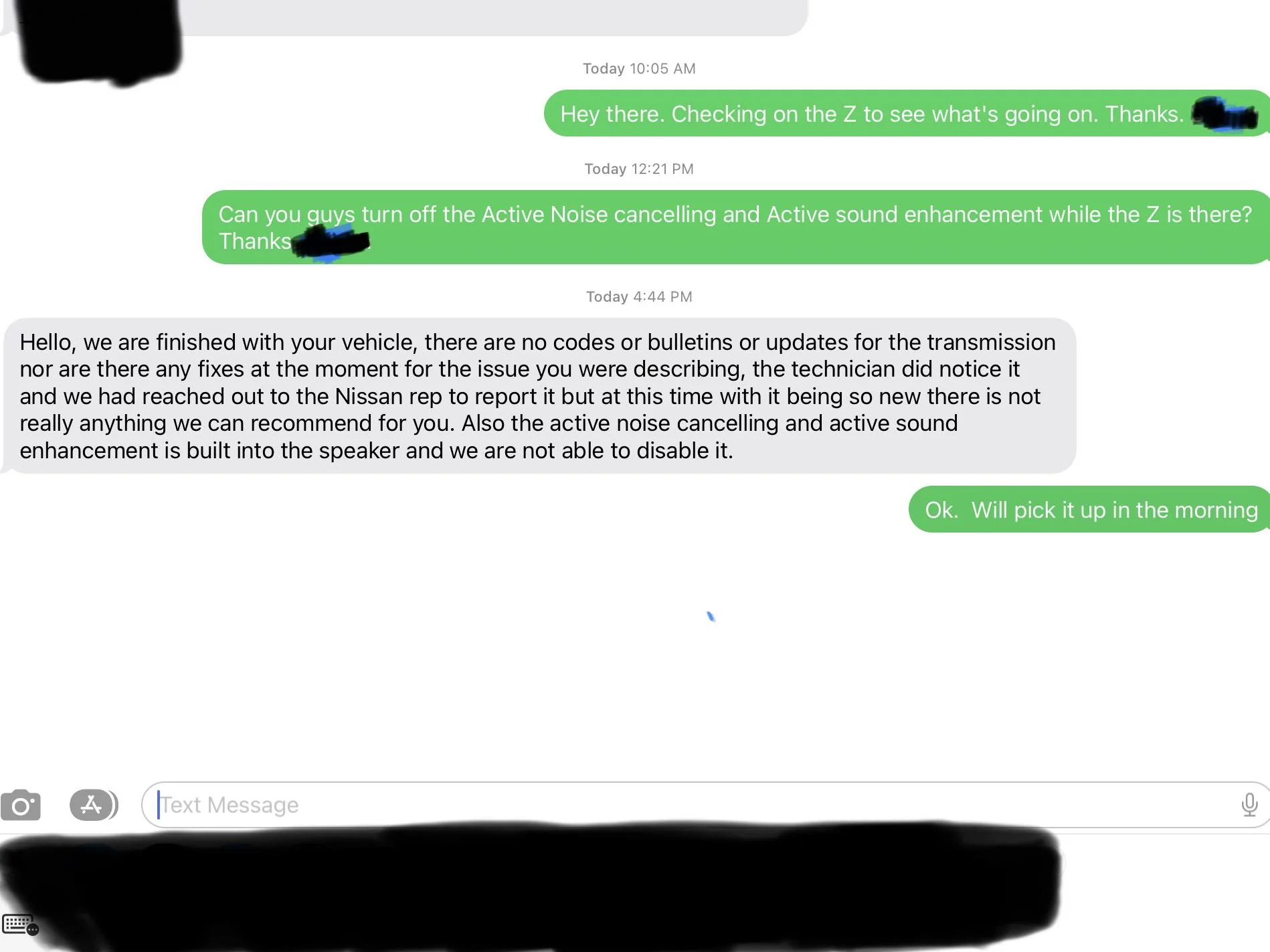

I feared lurching into someone in front of me as well. I kept a good distance away when stopping. I dropped mine off at the dealer Friday. On the way to the dealer it did not lurch one time! I almost turned around and took it back home! They gave me a loaner and listened to my thorough description. I told them about others here on the forum having the same trouble. They said they would properly research it and see if there were service bulletins yet. Sure seems like they are eager to get it fixed properly.

I picked the Z up this morning. I am happy with my local dealer (Coyle Nissan in Clarksville, IN.) They listened to me, gave me a loaner and did all they could. They said they spoke with the Nissan rep and he had heard of the problem but there is no fix yet. We are going to check on it again in a couple months at the first oil change. Like MCN1SMO said above, it’s probably a characteristic of the transmission maybe even across Nissan models. I can jam on the brake when stopping and keep it from happening. That is just not what I expected out of this car.
