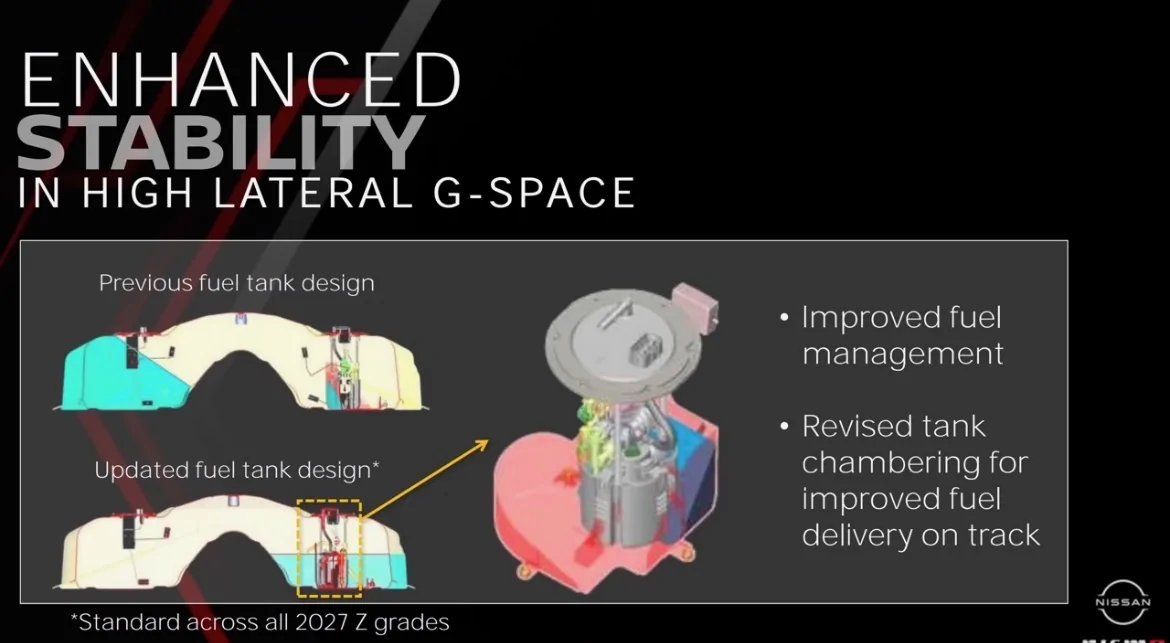

Seems like there is hope for those wanting the fuel starvation fixed with official Nissan parts.
99
2,936
5,525
New tank design with 'baffle wall', entire tank can be retrofitted, promising:
'On the topic of track-day confidence, Nissan's engineers also addressed a known quirk for regulars: fuel starvation. They redesigned the fuel tank by adding a simple but effective baffle wall in the lowest point of the tank. This traps fuel and eliminates the fuel starvation issues previously caused by high-G right-hand turns when the tank dropped below a quarter full. All 2027 Zs get the new tank, and we confirmed that earlier model year Zs can also retrofit this new tank.'

Do we know if there were any revisions to the pump, sending unit and the other stuff in the tank?...or if it's just the tank itself, and everything else is identical?
See my post in the other Nismo Z POV thread
Judging by this photo seems like fuel pump, there is no way the tank internal has been modified. Nissan would need new molds to be done for new tank manufacturing and the economical killer safety certifying a new tank would cost them millions.
99
2,936
5,525
My hope is any addtl baffling within the existing tank will solve the problem, at least most of the problem above 1/4 tank, which may not need any new safety re-certifications, we shall see.
