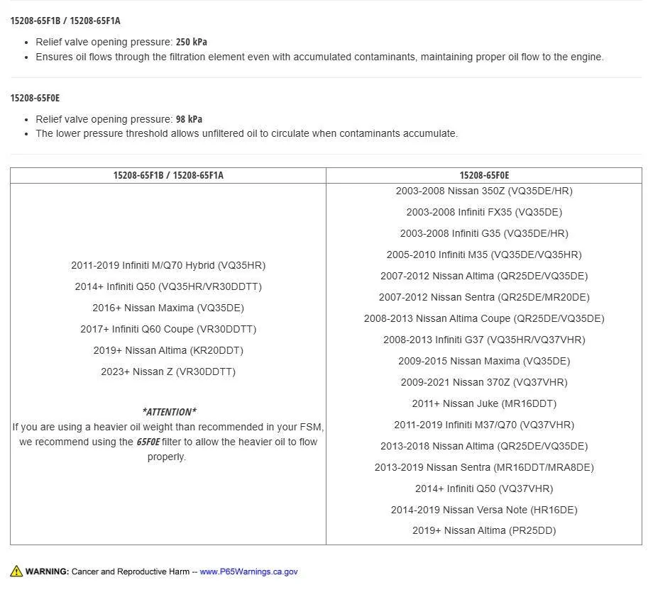

Z1 sells the Nismo 15208-RN011. Their oil change kits are 0w20 and the 65F1B filter. https://www.z1motorsports.com/lubricating-system/nismo/nismo-performance-oil-filter-p-4275.html
Z1 ALSO says:
*ATTENTION*
If you are using a heavier oil weight than recommended in your FSM, we recommend using the 65F0E filter to allow the heavier oil to flow properly.
If they are picking the 65F0E over the 65F1B SOLELY because of the relief, I'll be disappointed. It is foggy if one filter would allow thicker oil to flow through it better or not.

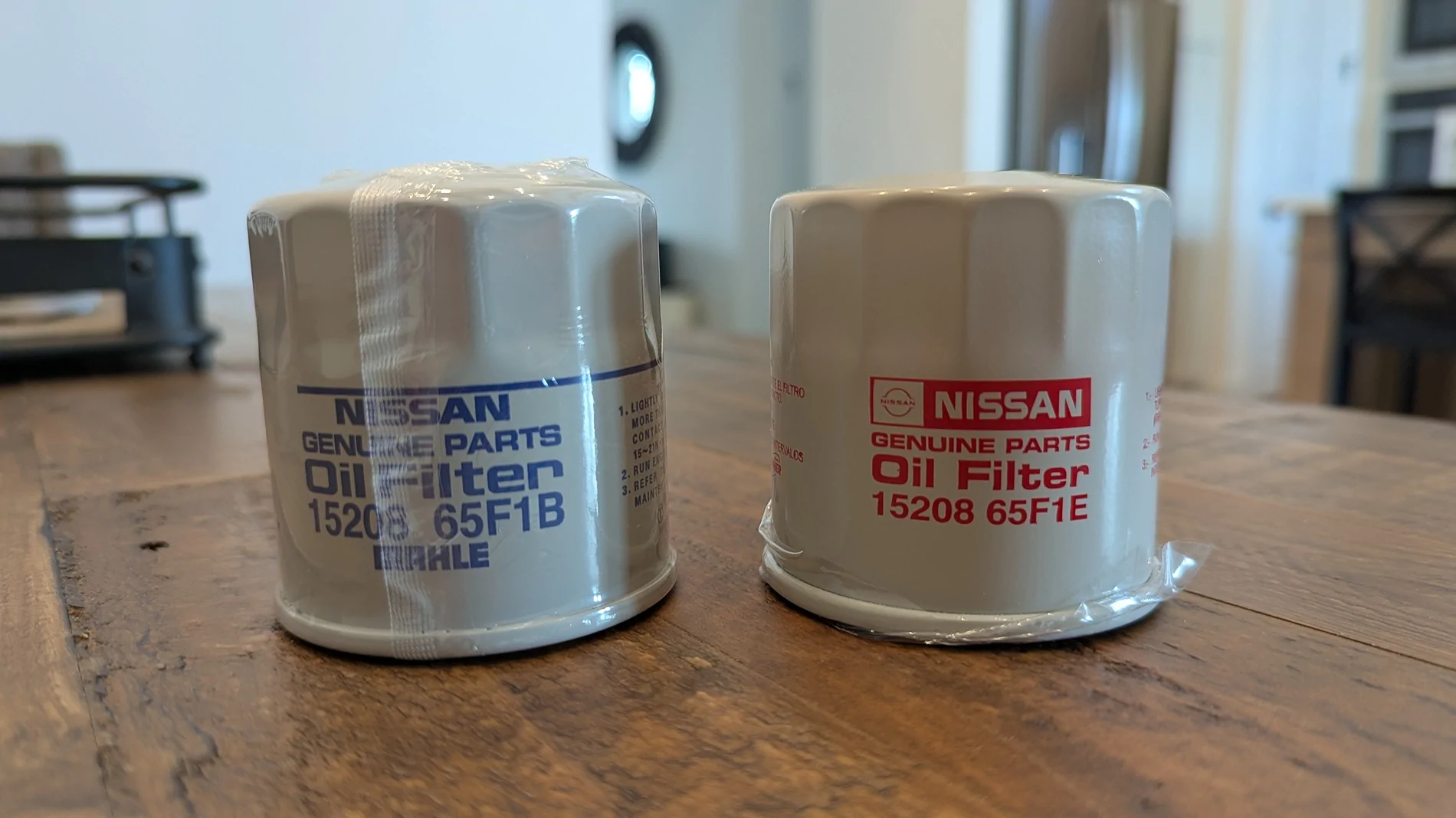

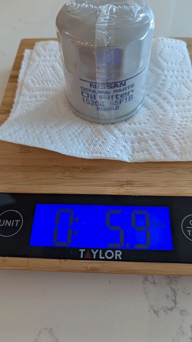

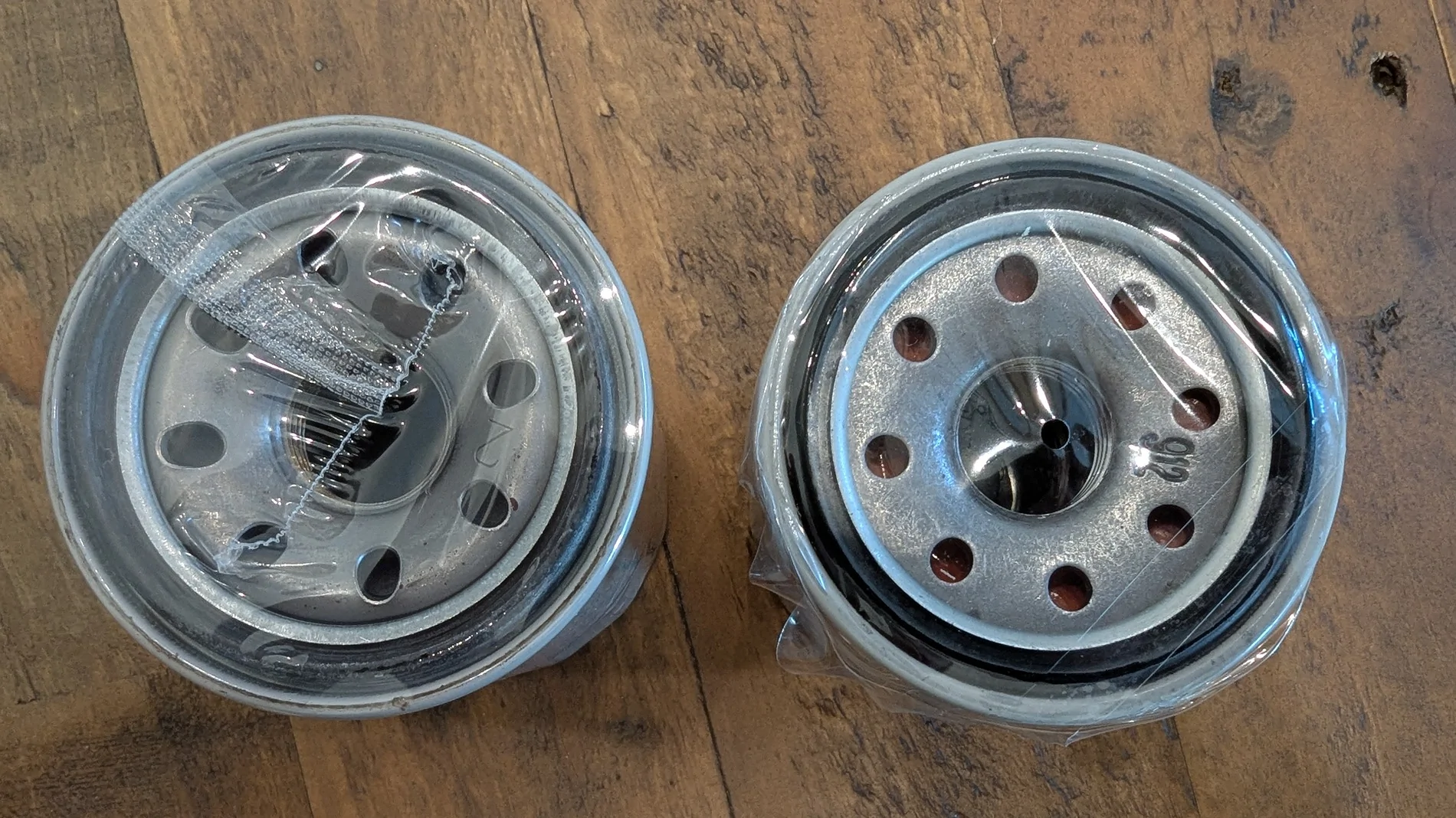

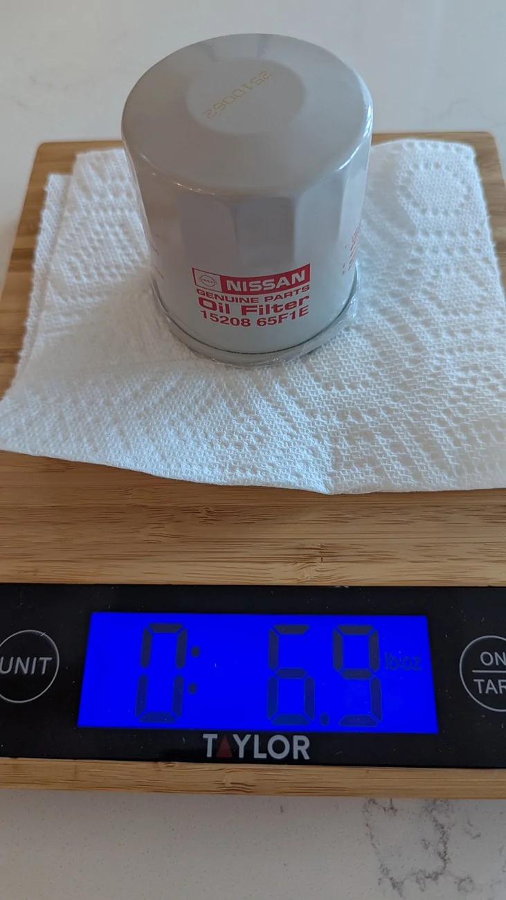

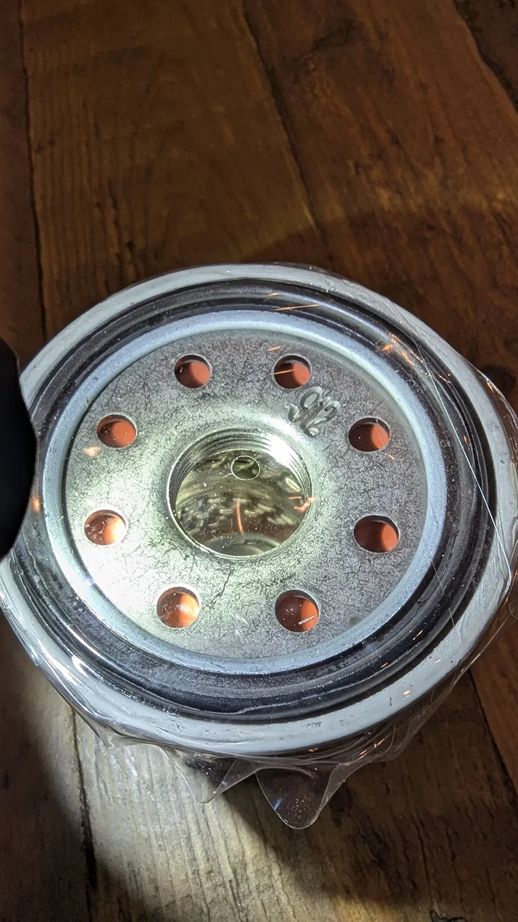

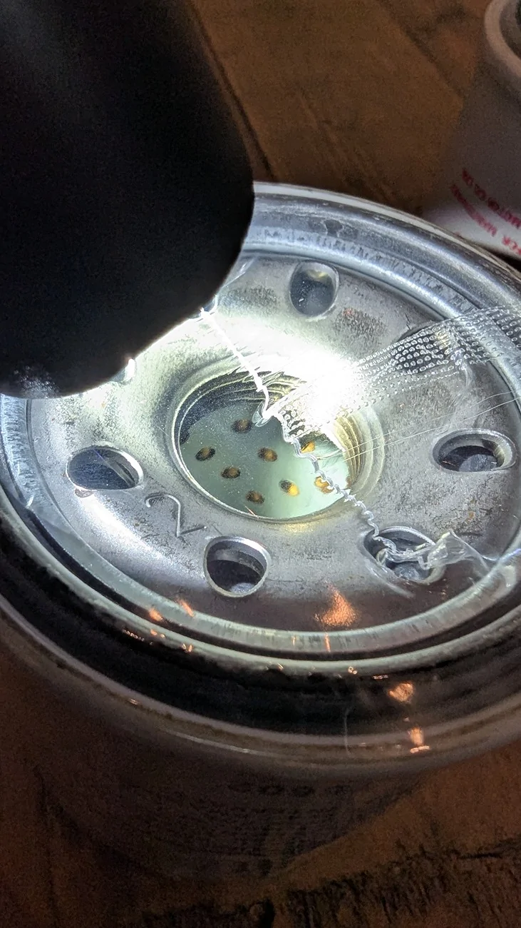

Japan vs. Mexico:
Japan vs. Mexico:
Japanese F1B:
Mexican F1E:

Z1 recommending a lower bypass pressure when running a thicker oil is backwards logic, and just forces even more unfiltered oil to flow more frequently.
