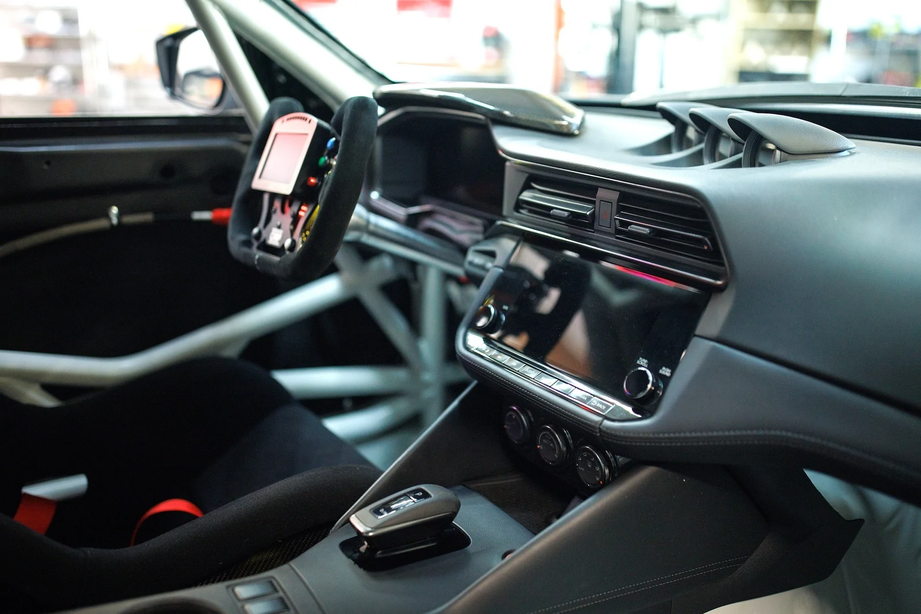

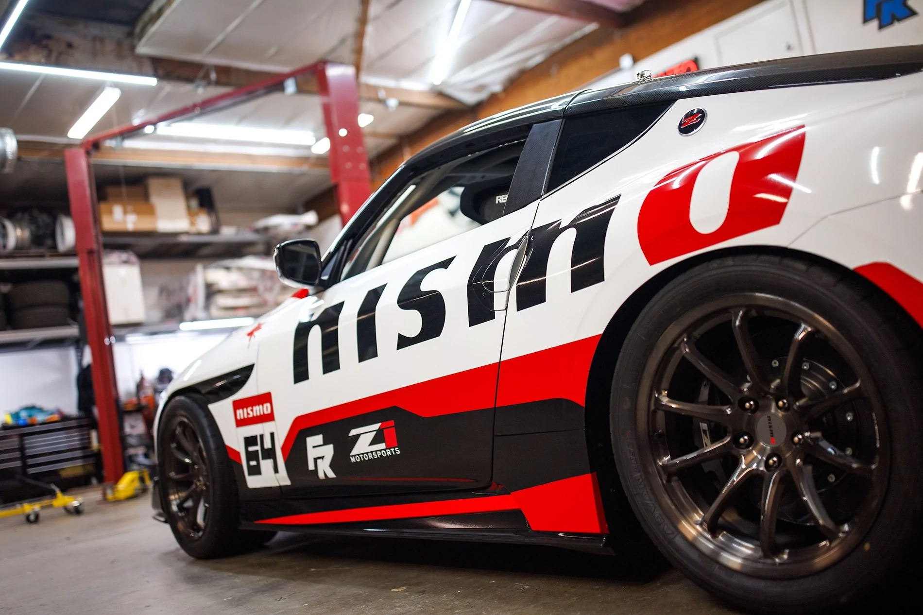

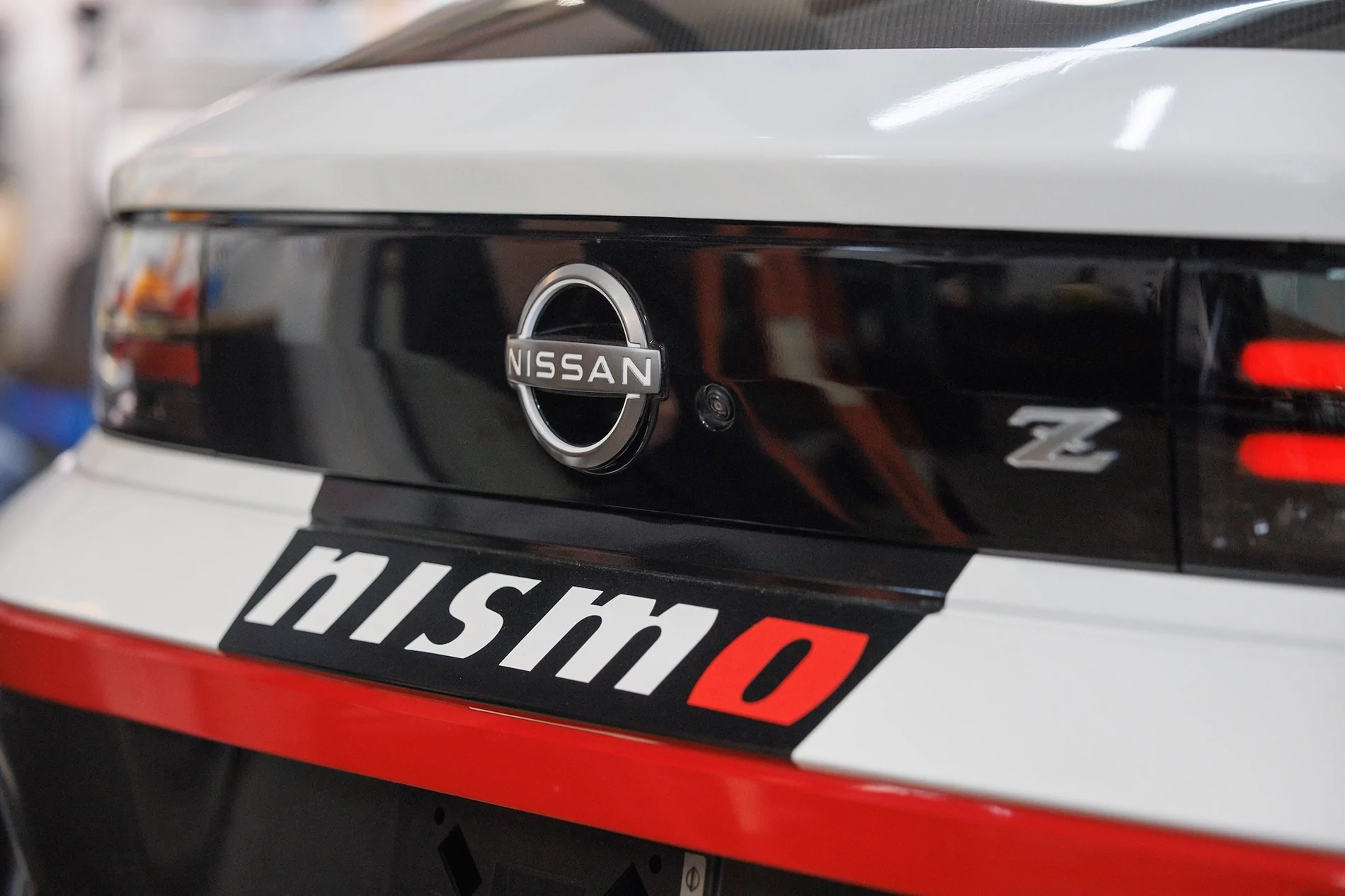

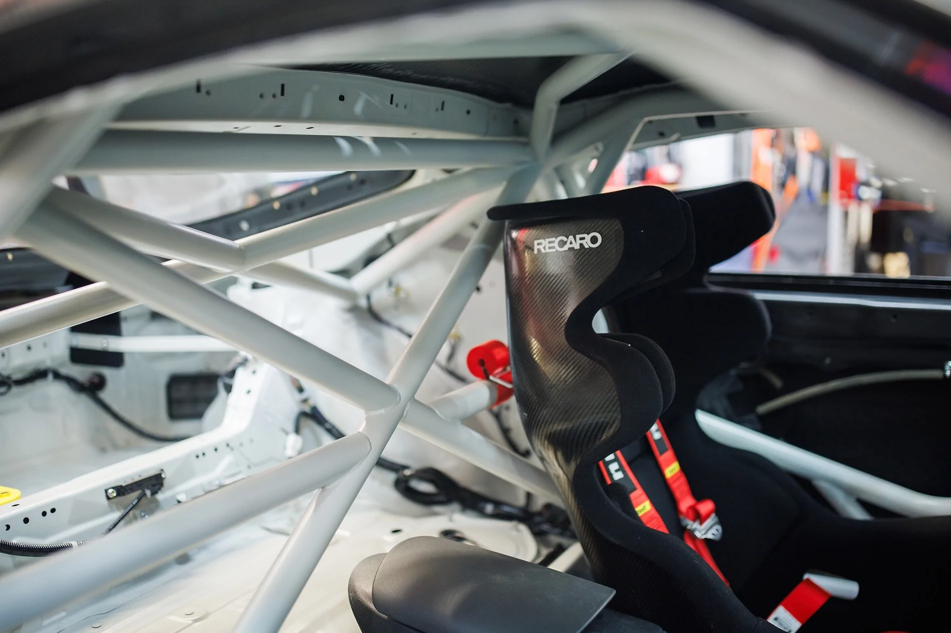

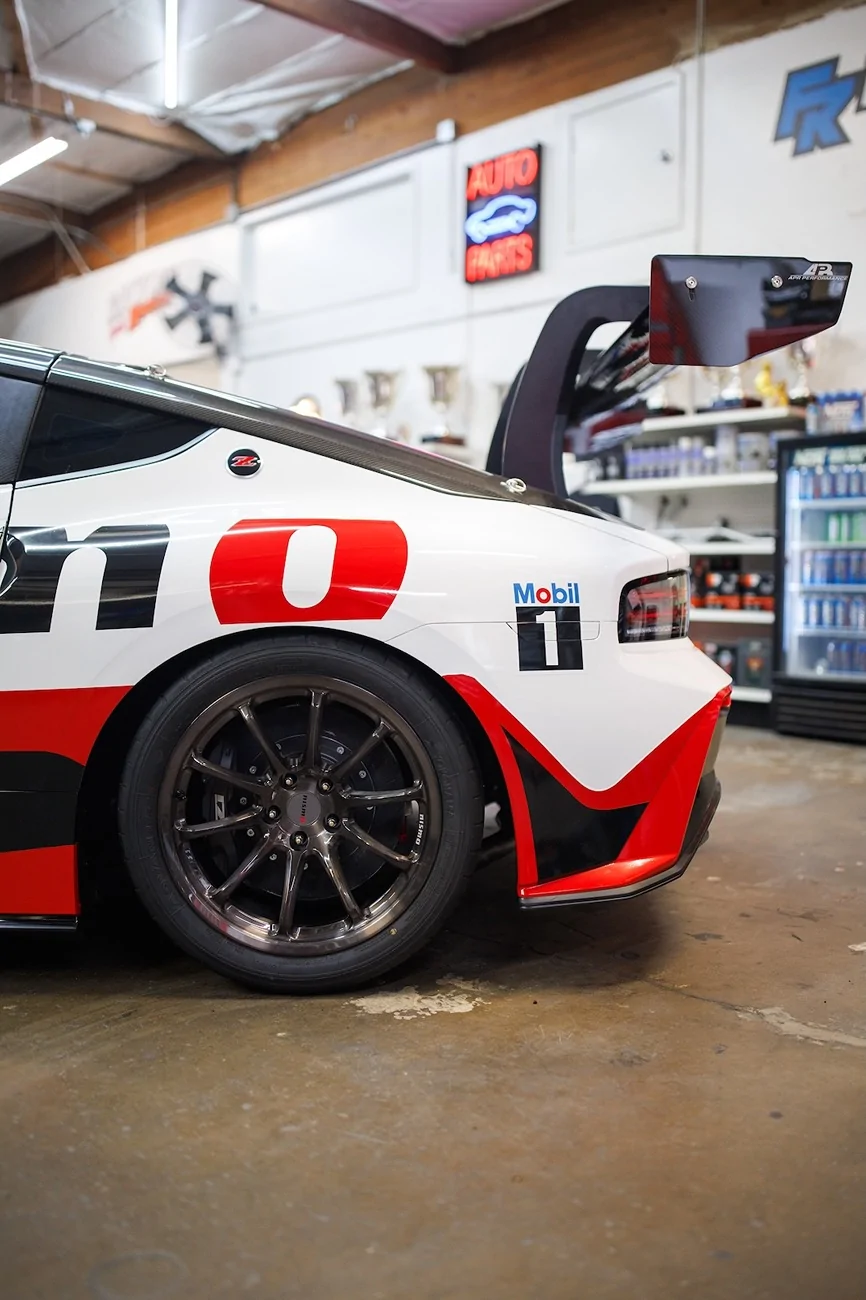

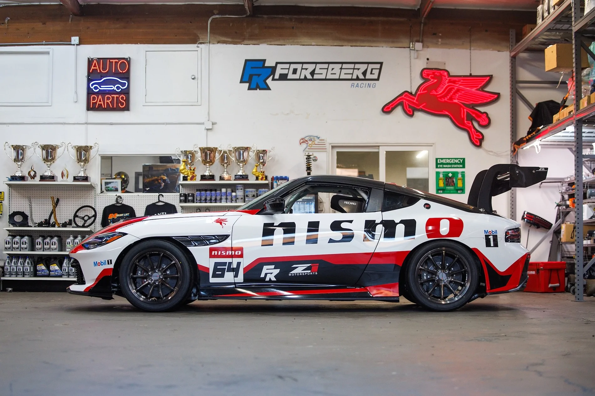

The latest in a long history of collaborations with Forsberg Racing, the NISMO GT-Z4 — owned and modified by Forsberg Racing - is a track-ready race car planned to enter competition in the GRIDLIFE GLGT series in 2026. Starting life as a standard Z NISMO, the build incorporates NISMO performance parts, highlighting how the scintillating sports car can be accessibly upgraded into a highly competitive racer.
The suspension, exhaust kits and miscellaneous other parts are sourced from the NISMO catalog, showcasing the way Nissan and NISMO enable enthusiasts to build sports cars that meet their needs and driving style.
Build Sheet: Forsberg Racing NISMO GT-Z
Suspension
  • NISMO coilover suspension kit
  • NISMO adjustable front upper control arms
  • NISMO adjustable rear camber control arms
  • NISMO adjustable rear toe control arms
  • NISMO adjustable rear caster control arms
  • NISMO front and rear performance sway bars
  • NISMO front strut tower brace
  • NISMO front outer tie rods
  • NISMO subframe bushings
Wheels and Tires
  • Prototype NISMO LM-RS1 wheels (18-inch x 10.5-inch +22)
  • Yokohama ADVAN A052 tires (front 295/35/R18, rear 315/30/R18)
  • NISMO valve stem caps
  • NISMO forged lug nuts
Exterior
  • NISMO / Forsberg Racing livery design
  • APR Performance GT-250 swan neck wing
  • APR Performance front splitter
  • APR Performance front canards
  • Z1 brake duct kit
  • Z1 competition big brake kit
Interior
  • RECARO P1300GT carbon seat
  • Z1 seat bracket
  • OMP window net
  • Cage Kits Road race spec cage
  • STEEL-IT® coated chassis
  • NISMO racing harness
  • Paragon cool suit
  • Woodward steering column
  • Forsberg Racing carbon fiber dash
  • MoTeC 8-button keypad
  • MoTeC C125 dash
  • FireSafe fire suppression kit
Exhaust
  • NISMO cat-back track exhaust
  • Z1 stainless downpipes
Performance
  • Z1 cold air intake kit
  • Z1 VRX70B turbochargers
  • Z1 air to air intercooler kit
  • Z1 differential cooler
  • Z1 finned large capacity differential cover
  • Z1 catch can kit
  • Mobil 1™ Racing 0W-30 synthetic motor oil
  • Z1 billet oil sandwich plate
  • Concept Z oil cooler
  • Radium Engineering surge tank
  • AMS high pressure fuel pump
  • AMS high flow injectors
  • AMS flex fuel kit
  • NGK spark plugs
  • MoTeC PDM15
  • OPTIMA® battery

Funny how they gutted the whole interior but left the radio and middle console 🤣

Car looks great, especially that livery, just disappointed on the rear end; I never like rear wings but it should at least have a spoiler with. It looks too empty, and it would add a degree of performance but looks great regardless, especially that carbon hood.

very curious to see how the automatic holds up in competitive racing.
1,645
2,683
nevermind is not gonna be an OEM auto . I couldnt imagine it would be but the pics confused me
