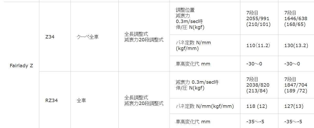

I'm also looking for coilovers and torn between kw v3 and the ohlins. I found that ohlins Japan has made the DFV for the RZ34 (https://ohlins-czj.jp/automotive/auto-search/) and found that blackhawkjapan imports them for a fairly reasonable price (https://www.blackhawkjapan.com/products/ohlins-ohlins-00087?_pos=2&_sid=7ffd9b87f&_ss=r).
I've heard nothing but good comments about ohlins over the years and I wanted to get the best of the best for my Z. But buying JDM Ohlins seems too risky on the books to me due to no warrenty and the uncertainty about servicing it within North America.

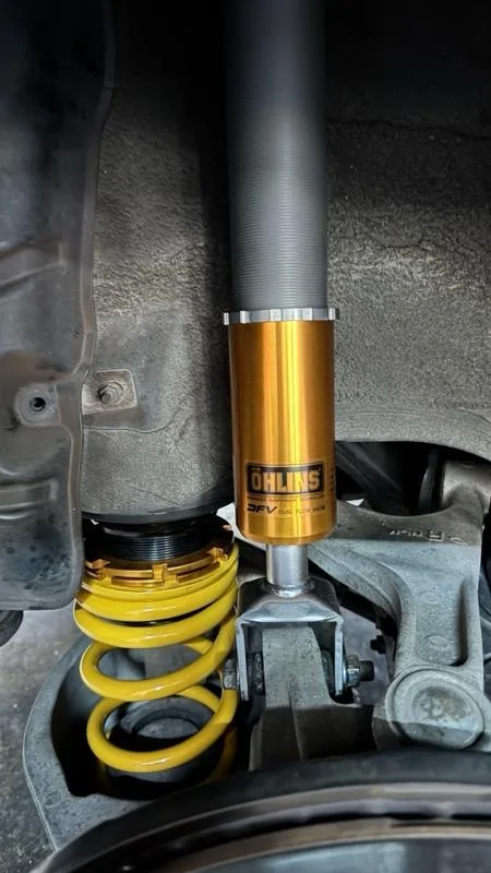

I'm pretty sure the pic from black hawk is generic, I found this from a Japanese website where people post and review their mods, and this pic came from an RZ34 with JDM Ohlins
(Source with English google translate: https://minkara-carview-co-jp.trans...l=auto&_x_tr_tl=en&_x_tr_hl=en&_x_tr_pto=wapp)
I agree that the spring rates are good since the rear is confirmed to be a divorced setup. Ohlins USA seems to have softer spring rates versus their JDM variant, probably because the roads in Japan are just that much better than those in the USA.
My new wheels are coming Q2/Q3 this year, and I really wanted to get my coilovers ready at the same time. Since Ohlins USA does not have a solid timeframe on when they will release the USDM version, the JDM variant might be my only choice.
