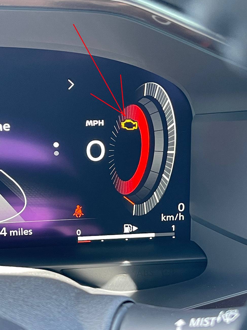

Another question I have is the engine light is on while I am driving. I am not sure if the engine light suppose to be on after the ECUTEK installation???
I am waiting for Z1 Motorsports to response back to me about the engine light after the ECUTEK installation.

Another question I have is if the engine light is on while I am driving. I am not sure if the engine light is supposed to be on after the ECUTEK installation???
I am waiting for Z1 Motorsports to respond back to me about the engine light after the ECUTEK installation.
While you are waiting for a response, you can do a couples things yourself.
You can read the error code (Diagnostic Trouble Codes) by selecting the “OBD readiness” menu and the “DTC Tool”. With the DTC Tool you can see the DTC number and also clear all DTCs.
its maybe from switching between maps. Select the map you want to run, then clear the DTC codes and the check engine will go off. If light comes back on, post the DTC number.
no mods at the this point right? No mods, then you should not have any error codes. But its common to throw a code when switching between maps.
I cleared all the DTCs and the engine light went away!!!
Thanks!!!
