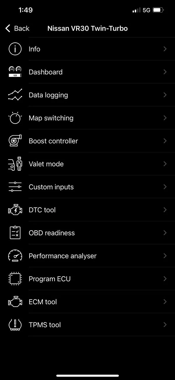

I just have a few questions about the menu on the ECUTEK app:
1. The Switch Maps is showing 3 options and would like to know which option to pick:
93/91 Octane Low Boost
93 Octane High Boost
91 Octane High Boost
I live in Arizona and I believe I should select the 91 Octane High Boost and I use Premium Unleaded gas which has the pump number 91.
2. What is the Boost Controller? Do I need to make adjustments to have the best performance? There are 3 sliding bars:
Mode 1
Mode 2
Mode 3
Do I need to make any other adjustments in order to get the best performance for my Z?

The option allows you to decrease / increase boost. The boost controller is a regulator or boost limiter. more boost more power. So for each map you can select one of the 3 boost modes and you can set the boost level for each mode. Low=economy, high = max performance

No need to have all 3 options set the same. You will only select and use one at a time. I assume that you are bone stock except for the ECUTEK. No harm in adjusting the boost. it is just a limiter. The ecu will still manage the boost level. a lower boost setting will help with fuel economy - maybe.
With the high boost setting, you can always control the boost with your right foot. The stock tunes are fairly harmless along with simple mods like intakes, downpipes, exhaust, etc.
now once you get into heavy mods and aggressive tuning like bigger turbos, fuel injectors, fuel system upgrades, aggressive timing, increased rev limiter the tuner, maps and settings become more critical.

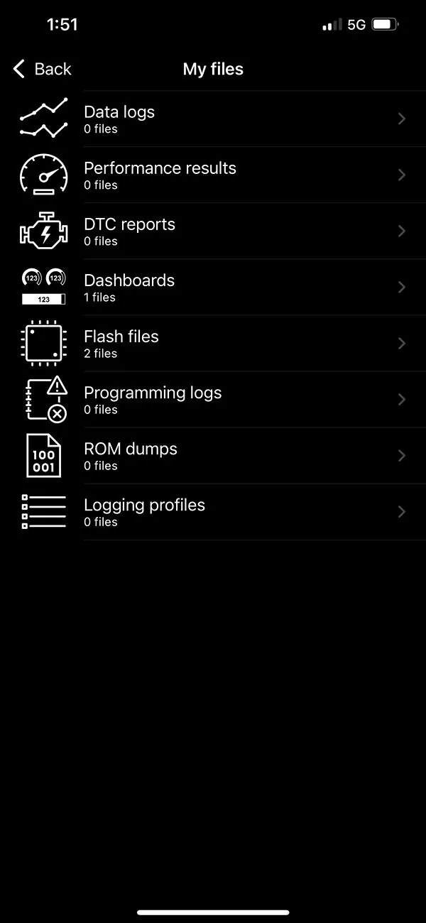

I have attached 2 pictures of the ECUTEK settings just in case anyone is interested in buying the ECUTEK. It would be wonderful if Z1 Motorsports have a video on what these settings mean and how to adjust all of those settings.
I have no clue what these settings are supposed to do??? They need to go into detail for each setting.
Another thing I would like to add about ECUTEK from Z1 Motorsports. The delivery time for them to ship the ECUTEK to my home was only a few days. So the shipping was very quick. After I installed and sent them the information about my Z, it took them about 2 days to send me the installation files. The whole process from purchasing the ECUTEK and full installation was very fast. Installation was a breeze and very straightforward.
Only thing that was confusing is that they sent 2 files. One file is the tune file and the other file is the stock file. I didn't understand why there were 2 files. They told me to install the tune file only. The stock file is there just in case you want to put everything back in stock of your Z.

z1 can answer your questions as a tuner but ECUTEK should provide the help info. Since ECUTEK does not sell direct to the end user we are caught between the tuner and ECUTEK. With that said, there are lots of ECUTEK videos. Our engine (VR30) has been around for 10 years now. So you may want to search ECUTEK vr30.
it sound like you answered your own question about the two files. Did you do a rom dump before installing the z1 tune? did the tuner ask you to do a rom dump and send the file before receiving the z1 tune? Is the stock file the tuner sent from your car or just a stock map he already had?
maybe the tuner has a newer version of the stock map. Manufactures often revises the stock map but do not always offer the newer map to previous owners.
you should have downloaded the stock tune from your car via the rom dump feature before installing the z1 tune. once you load the new z1 tune the original stock map is gone.
maybe the tuner always provides a stock map in case you did not do a rom dump before installing the z1 tune. If there had been an issue with the z1 tune, the tuner was prepared to have you to re-load the stock map he sent.

I was told NOT to install the stock file and ONLY install the tune file. The installation was a success in the end. Driving the Z now is for sure quicker now. It's even more exciting to drive it now.

you would only install the stock map if you wanted return the ecu back to stock.

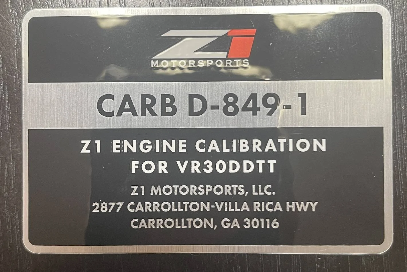

The reason that I am not getting the burble map is because I bought the wrong ECUTEK. There are 2 options for ECUTEK. I bought the CARB COMPLIANT option because it is for the state of California:
Z1's CARB Legal Performance Tuning Package provides the best tuning solution for 2023+ Nissan Z outside of our in-house services. The Level 1 Tune (base) requires no dyno tuning and is expertly pre-calibrated to suit your vehicle and meet California's CARB requirements. This tune is identical to the Level 1 Tune in our Performance Tuning Package and offers the same performance advantages, however, it meets all CARB requirements and has been tested to be in compliance with CARB standards.
Carb Legal EO: D-849-1
I live in Arizona and Z1 Motorsports told me that I picked the wrong ECUTEK if I wanted the burble map. If you want the burble map, BUY THIS ECUTEK:
https://www.z1motorsports.com/z1-pr...cutek-performance-tuning-package-p-43398.html
And you need to put the CARB decal sticker underneath the hood of the Z. See attached picture.

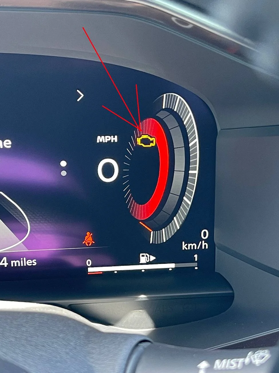

Another question I have is if the engine light is on while I am driving. I am not sure if the engine light is supposed to be on after the ECUTEK installation???
I am waiting for Z1 Motorsports to respond back to me about the engine light after the ECUTEK installation.
