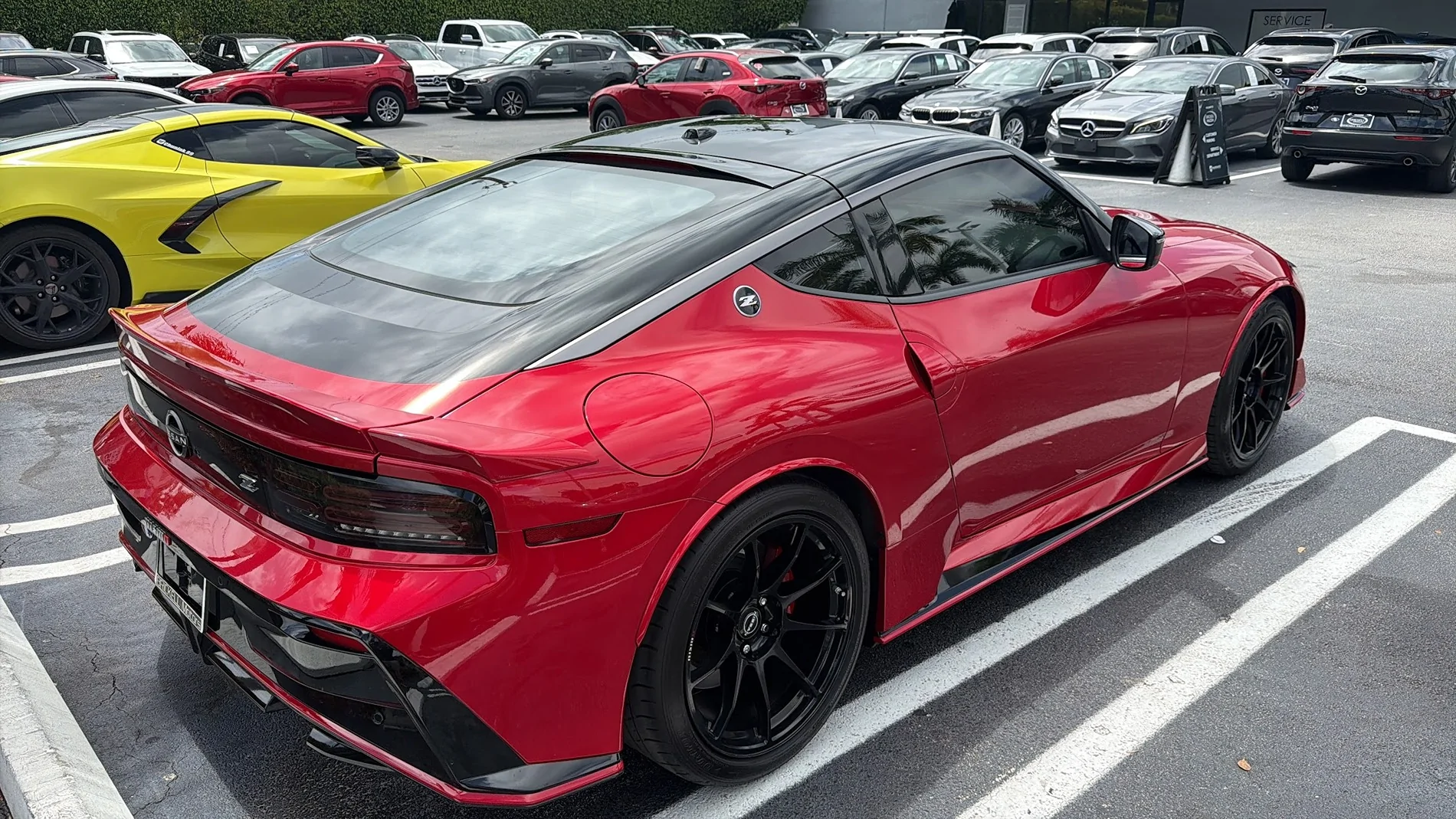

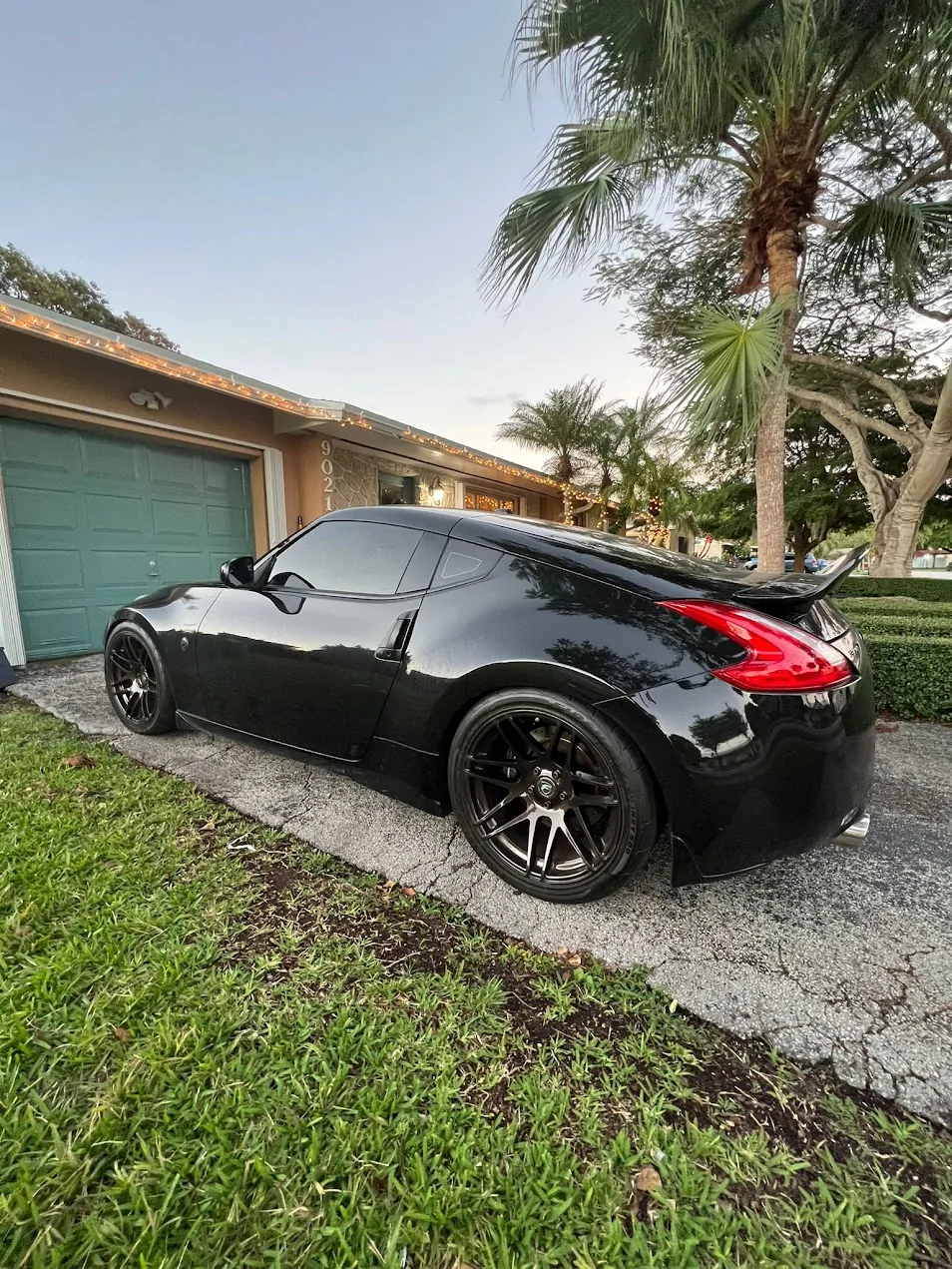

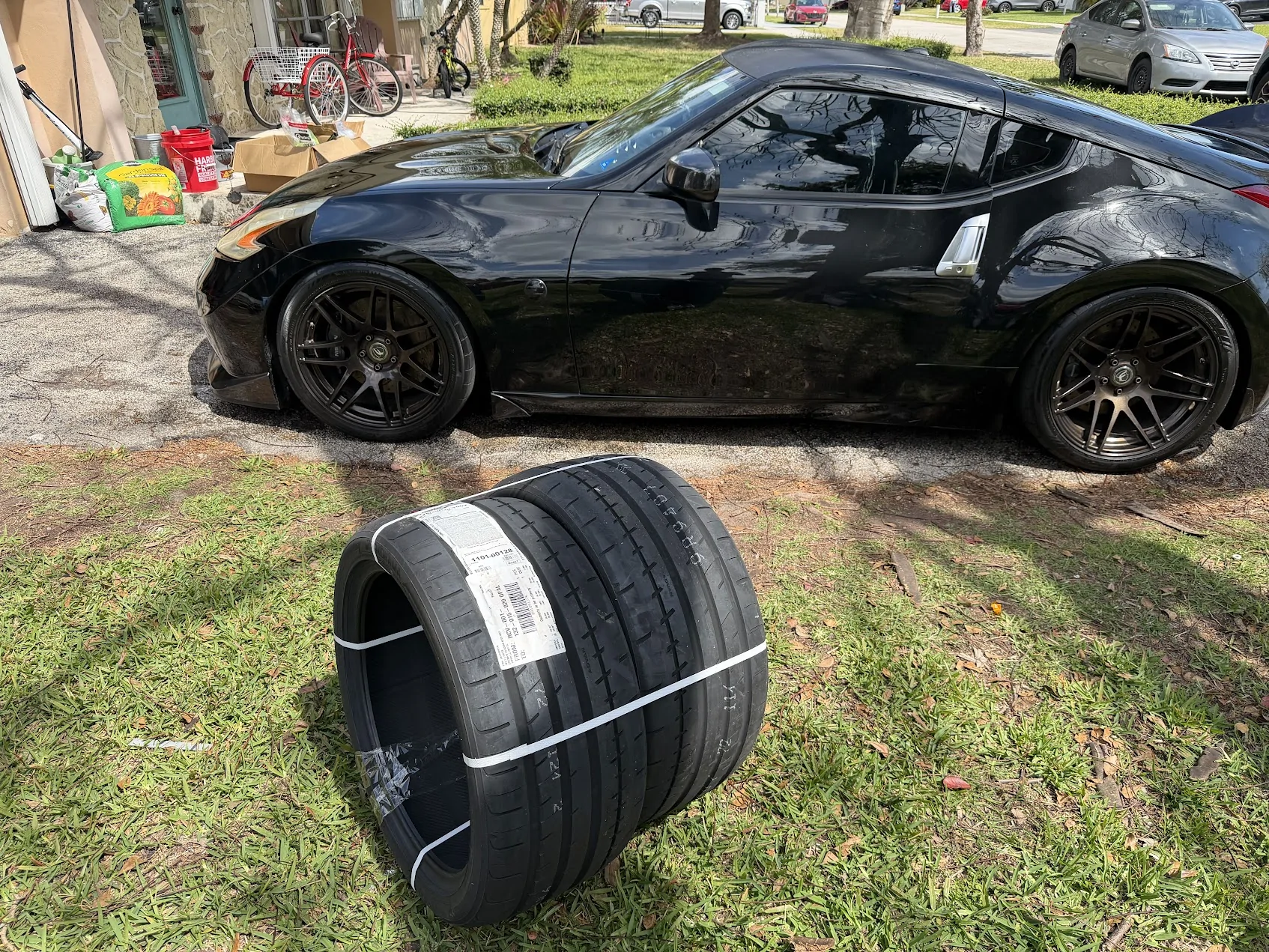

Next weekend I’m planning to test-fit my old setup from my 2011 370Z onto my new 2024 Nissan Z.
The old setup
Front: 275/35/19 (don’t remember the offset, but it fit perfect on the 370)
Rear: 325/30/19
I just picked up the Z, so I’m still learning about it

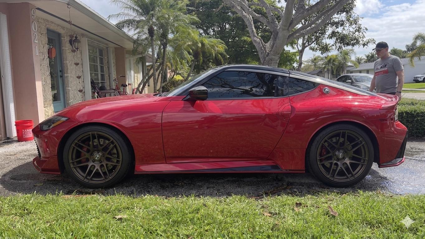

I know the 325 in the rear is pretty aggressive, so I’m curious if anyone has tried something similar or knows what to expect fitment-wise. also hope the bronze burn complimente the pasion red.
Like I said before, this is a test fit, so don't burn me at the stake. 😁
Appreciate any input

Welcome! And congrats on the RZ34!
Bronze, light or dark, works on everything, imo.
Cant say yes or no, but someone here probably can. All depends on wheel width and offset. I believe the fender flares on the NISMO eat up just a tiny bit of inner clearance than the Sport and Perf without.
Was concerned about circumference difference (VDC issues), but the 275/35 and 325/30 are almost identical.
The width and offset should be stamped or molded into the back somewhere. Please let us know how this goes. Don’t know if I’ve seen a 325 rear yet.

Had to reschedule because the front wheel studs on my 370Z are longer, so the OEM lug nuts don't work with the aftermarket wheels. Just waiting until I get some time off to try it again, but this time with 10mm spacers. or shorter stubs.
