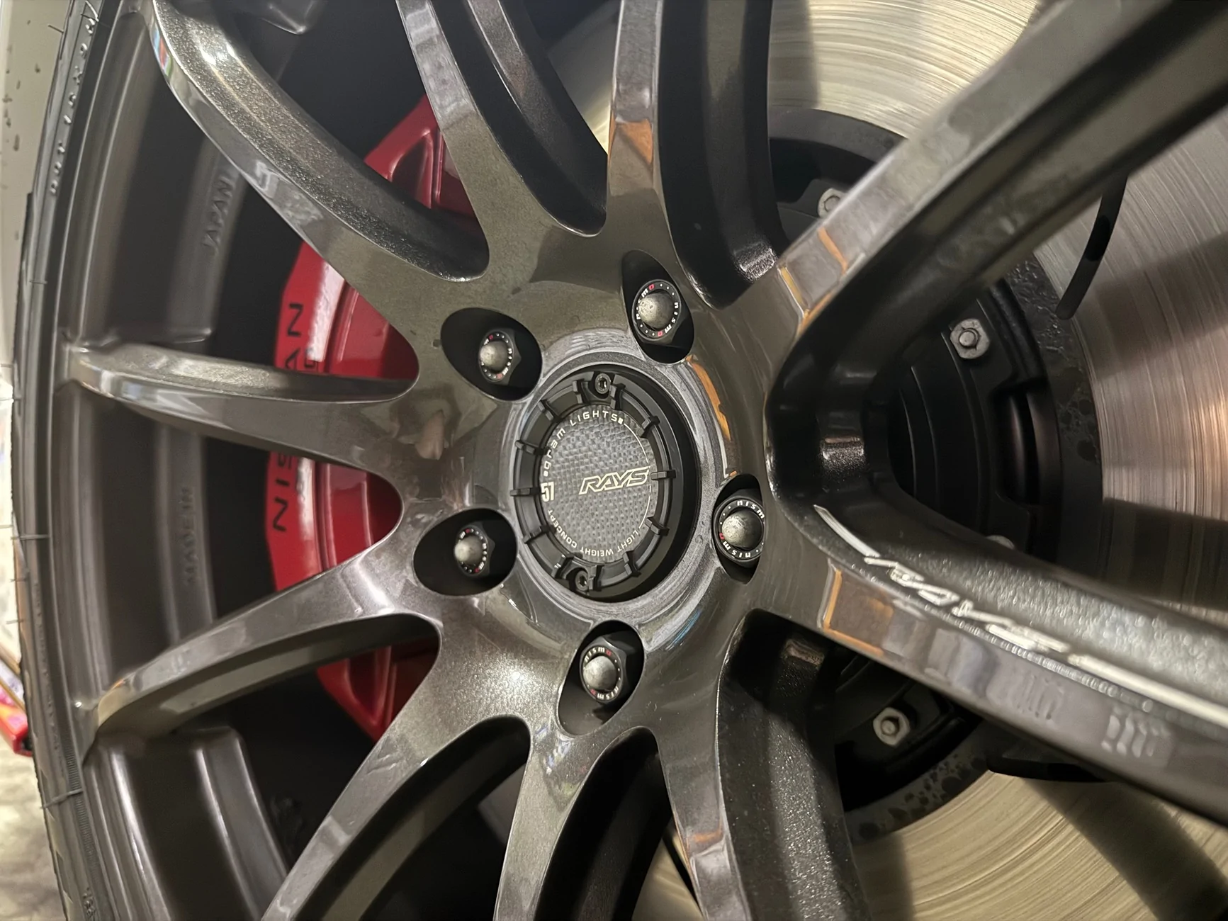

Test fitted 15mm spacers on the Performance wheels, the pockets on the reverse were not deep enough to allow the stud to clear. Jumped to 20mm, no problems. Current wheels have deeper pockets, and after testing clearance with a little blob of clay bar, found I had about 1-2mm clearance. So I have 15mm spacers on the fronts now.
