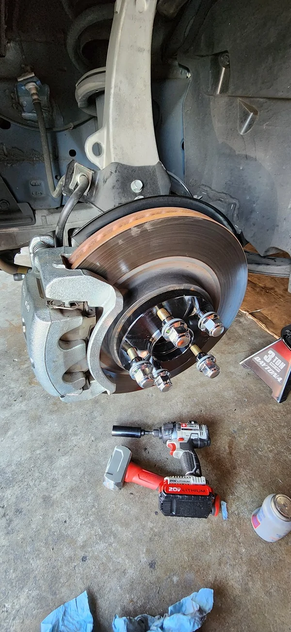

So originally I put in 20mm hub centric wheel spacers on all 4 corners. Then I decided to try 15mm for the front. Installed them like I have done many times over the years. Today, I decided to switch them back to 20mm. The wheels was stuck to the the spacers and would not come off. I tried to kick the sides of the tires trying to knock it off but they won't budge. Then I remembered when I installed the 15mm spacers I had to continue to torque the lug nuts more than I normally would before they reached the torque setting. Then I realized the 5mm difference in the two wheel spacers are the problem. Basically the wheel was not flush with the spacers, but rather contacting the stock studs. Since the wheels are aluminum I was pressing the wheels into the stock studs.
I had to raise the car and use a piece of 2x4 and a sledge hammer to hit the inside edge of the rim to knock the rims off. After the rims were off it was apparent why the wheels were stuck. Like I suspected the wheels showed areas where the stock studs compressed into the wheels. Not a big deal, but it could have been worse as it is possible the force could crack the wheels.

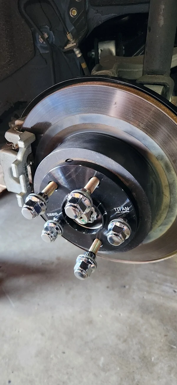

Saw someone had the same issue with the bolt on 15mm spacers. They saw a gap between the wheel hub and rotor hub. After that, everyone was saying the cavity of the '23+ wheels are not deep and requires slip on spacers for 15mm.
After reading the feedback. I went with extended studs for my 15mm and 12mm spacers. Stock lugnuts do not bottom out. But 10mm spacers will bottom out the stock lugnuts.
Swapping studs was easy. I can slip on 20mm if I wanted to.

Two types of spacers: bolt-on and slip-on. Both types can be hubcentric or not (flat or have a protruding hubcentric ring).
For bolt-on spacers typically the OEM studs protrude through, unless the spacers are massive. This isn’t a problem if the pockets in the back of the wheel center (between the lug holes) are deep enough. Unfortunately on the Z, the pockets in the stock wheels are too shallow for 15mm spacers.
What has happened is you have smashed the crap out of the wheel center down onto/around the protruding OEM studs. To run 15mm bolt-ons with OEM wheels you’d need to grind off a few mm of the OEM studs to make clearance for the wheels. Or grind off some of the pocket, which is prob worse than grinding studs.
Check out the pockets on the back. I assume they’re torn up, especially if the wheel is stuck. Hopefully only the pockets are damaged and nothing’s been misshapen.

You are 100% correct. The back of my wheels only suffered about 3/8” of compression from the studs. Not bad at all. Hopefully others will see this thread and won’t make the same mistakes as I did.
