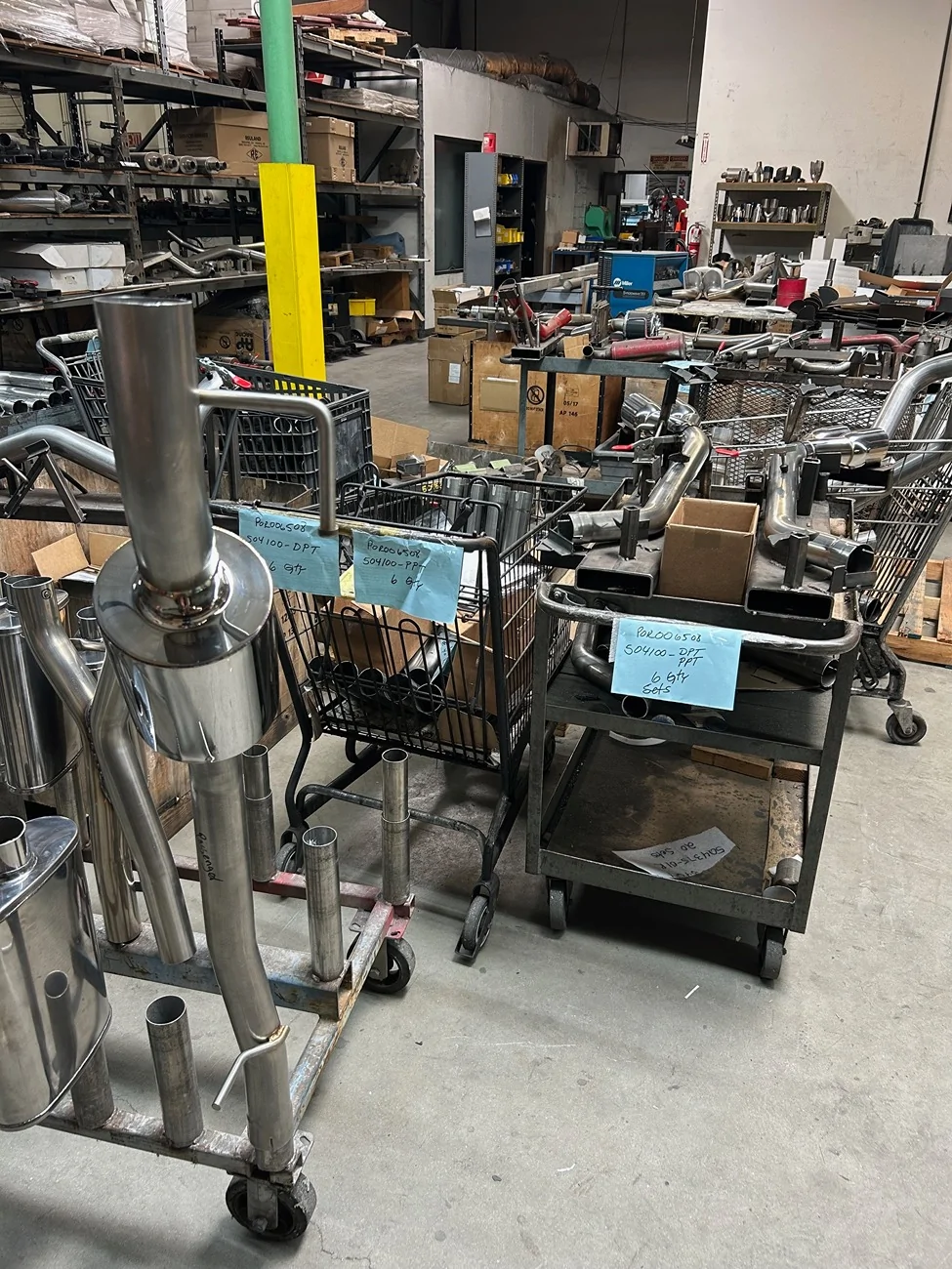

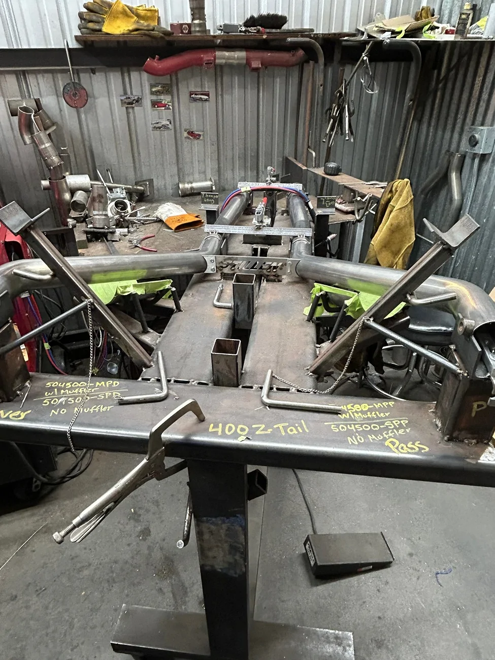

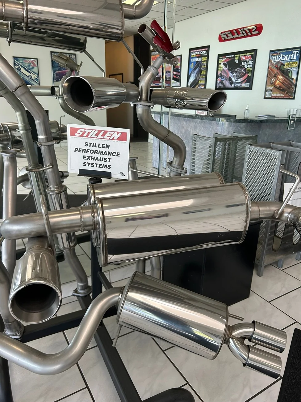

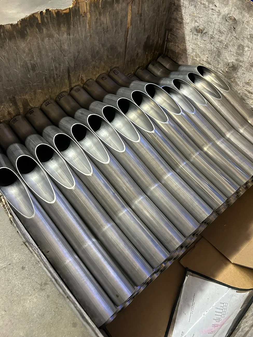

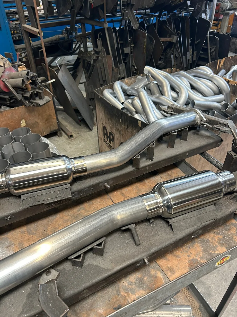

That's shitty quality control! I visited the Stillen factory today to see how all is made and QC applied. Impressed with nice tight tolerances and smooth mandrels. Ordering one and will report back. Noise alone is not the only deciding factor. I will install this before the weekend. My Z will eventually be tracked after retiring the RB26DETT 240Z
Nice looking finished product but the shop needs to work on their 5S deployment - the place is a mess.
True, but they've been around since the 80's, lots of molds and jigs, etc. everywhere for just about all model Zs and other Nissan/Datsun related.
