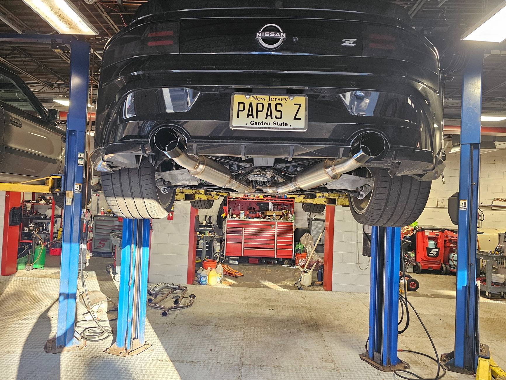

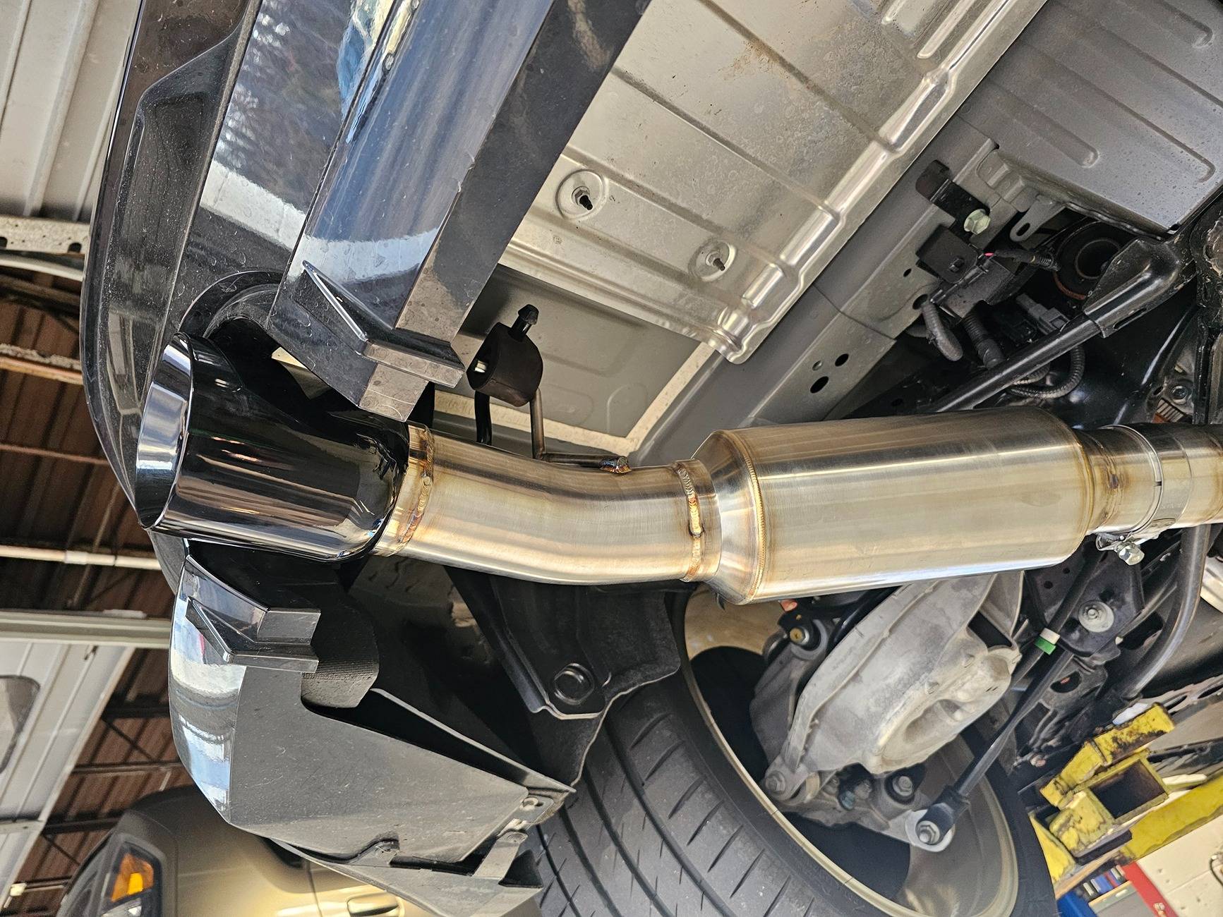

Ok, too catch up in the past couple of weeks I installed my LDP's, exhaust and started my tune with Sonictuned. Also, maybe today will give the shift knob a shot and install new Emergency Brake Handle and boot for shifter. Also, on my 2nd version of artwork for livery so hopefully that will begin soon.
3" Intakes Titanium - RAE Motorsports
3" LDP's Resonated - RAE Motorsports
3" Catback Black Powder Coated Tips - RAE Motorsports
ECUTEK Tune - Sonictuned

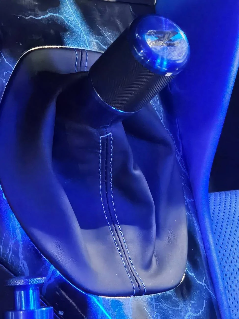

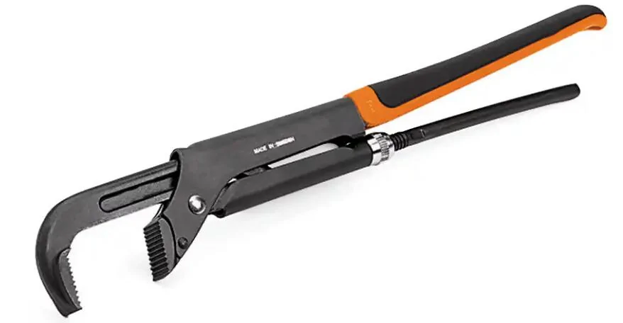

Conqured shift knob - if you don't care it literally took 2 mins to get off with Snap On adjustable plier wrench. Love my new ebrake and leather boot and my weighted shif knob with leather boot. Weight of knob cleaned up messiness of 2nd gate LOVE IT. Patrick Galligan on FB hooked me up GREAT guy and great product. His IG is @Customebrakes - if you like hit him up.
