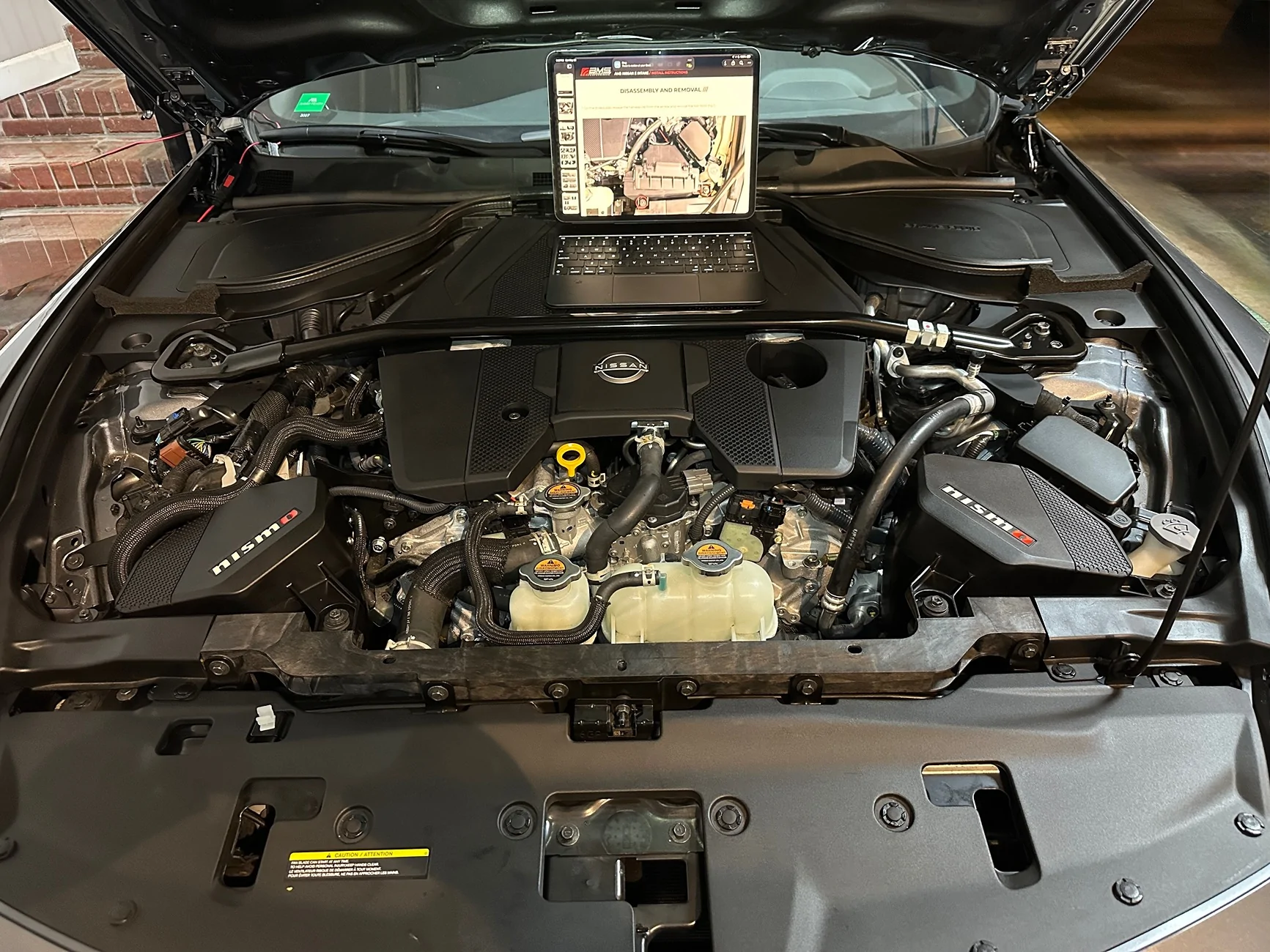

Installed my nismo intake
was not that bad thanks to all the posts and AMS instructions.
The AMS 80mm instructions has more detail for the spring clips on the air box than the standard AMS intake instructions. The clips are nice - you pop them out with a screwdriver and they will stay open in a locked position.
the hose clamps on the turbo side were not tight and easily loosen with a flat head screwdriver.
Installing the passenger side hose on the turbo housing was a blind shot - 100% by feel to get it seated. with my hands out of the way I was able to see that it was seated.
i installed the new hose clamps with a 1/4 drive ratchet w/ locking flex head and a deep well socket. except for the driver side turbo hose clamp, i used the same long flat head screwdriver i used to remove it.
i used super lube silicone brake grease on both ends of the hoses.
