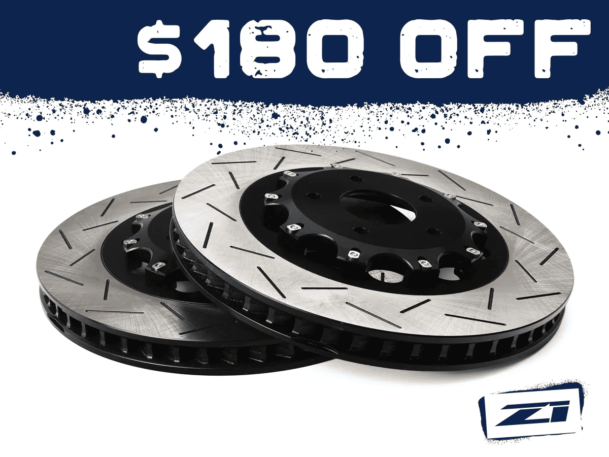

2 piece rotors make zero difference to heat dissipation.
How can this be true? Even at high track temps? If there is less surface area of heat absorption then wouldn't that mean less heat soke? Also these rotors are slightly wider than stock. Not saying you're wrong but I did research them which led me to buying them now I feel like I messed up lol. I emailed Z1 to ask for a refund.
Also read that it is cheaper to replace the iron and keep the hub vs replacing one piece rotors, that is definitely not always true. I can get a set of front and rear slotted one piece Stillen rotors for $500 vs $800 for front and rear Z1 iron replacements. So do you think the stock rotors will hold up with good pads for several track days?

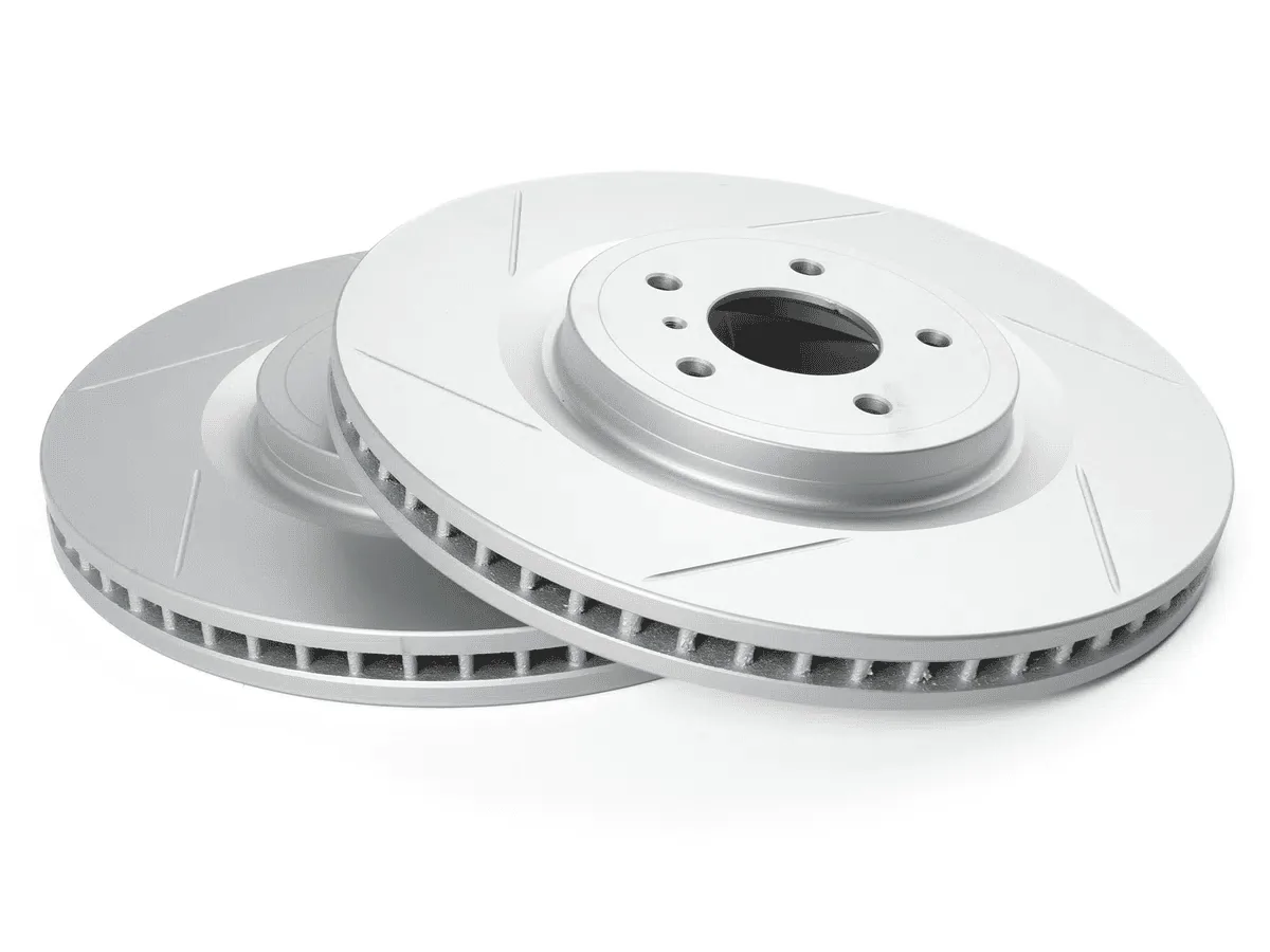

You know that '2 piece' doesn't refer to the double up of the rotor disc right?
Because that separation of the disc (with venting in the middle) is exactly how the stock brakes are... Look at my stock brakes in the below pic:
For further reference, have a look at the images below - first is single piece performance brakes, second is 2 piece performance brakes (same company, Akebono)
I can tell you now, that there would be zero difference in 'cooling'.
The only difference is that the black hub section (in the second image) is made of a different, lighter, metal than the silver disc section. This helps with unsprung mass.
YES, you can only replace the disc if it wears... but this is honestly something that should outlive the car in most cases. AND, good luck finding someone that will sell you only the disc... 9 times out of 10 you buy the disc and hub as a complete package.
Finally, don't get me wrong... if you are planning on doing not only a lot of track work, but a lot of HEAVY track work, then brakes play an important part - as do oil and trans cooling.
But there are a heap of other, far more cost effective, things you could do to improve heat, wear, performance etc etc before you start looking at things like big brake kits.
A single example - the stock suspension in the Z's is complete garbage. Get coilovers, or even just sway bars, and you can take corners much faster - resulting in less need for heavy braking.
That isn't just general advice, it's specific to the Z. They wallow like a boat without suspension upgrades...

@Proto Z please don’t take take this wrong but you have a lot more research to do on 2 piece rotors, specifically towards heat dissipation.
