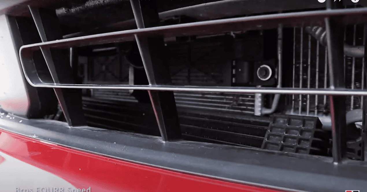

Close-up on the lower grill opening of this car you can already see where the road debris & bugs are hitting the cooling fins on the radiator. Looks like a mesh grill insert might be a good DIY install to protect from potential damage...similar to the aftermarket radiator protection grill screens for the front of the Porsche Caymans. But as many have mocked the appearance of the rectangular grill opening of the new Z, this shape should make it easy to fit & install a grill screen in the lower section.
2,690
5,644
My coworker bought the then-new 2016 Civic EX turbo and has since put 160k miles on it. The only problem it ever had, and twice nonetheless, was the intercooler developing leaks from the exact scenario you speak of.
Obviously, out of pocket for him, but could be avoided.
I'd come up with a stealthy solution, maybe a screen(s) only one inch from the finned radiator/condenser/cooler in matte black, something hard to see from the front.
