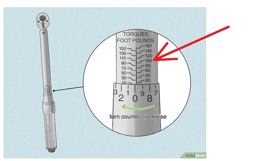

I recently bought a torque wrench and need advice on correct setting for the Z.
Some YouTuber videos are recommending 100in - lb. for all 4 wheels by using the torque wrench.
Here is the setting for 100 foot pounds:

I've seen some varying numbers based on different wheels and/or makes and manufacturers. But theyve always been between 80-110 FT-LBs. 100 ft-lb is a solid rule of thumb if you don't have the actual spec. the owners manuals in the new Z doesn't actually list a specific number but the prior gens were all on the lower side of 85 or so.

80 ft-lbs
Make you're you're using the correct scale i.e. not inches!

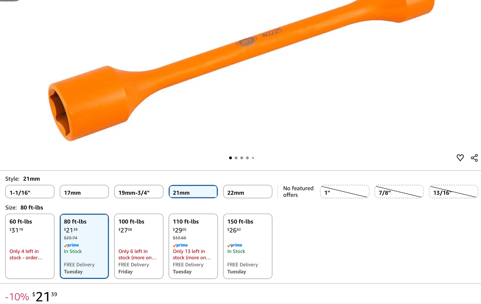

anyone use a torque stick?
i just use a socket with an extension

How reliable is the torque stick? Is it safe and accurate to use? Don't want the wheels to fall off while driving on the highway. LOL!
Never used one - going to order one and use with my impact wrench, then follow-up with a torque wrench to verify it works.
No, because they only work with power, air, or electric, wrenches. They need the high speed of a power wrench to get the shaft to flex to let you know that the torque point has been reached. With a hand wrench, you won’t be able to get it to work. I’ll For me anyway, it’s easier just to use a regular socket with a torque wrench. Although frankly, most of the time I just do it by feel.
I will use it with an impact wrench. My thoughts was to then verify with a torque wrench….

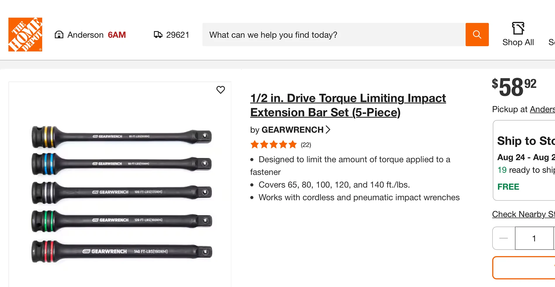

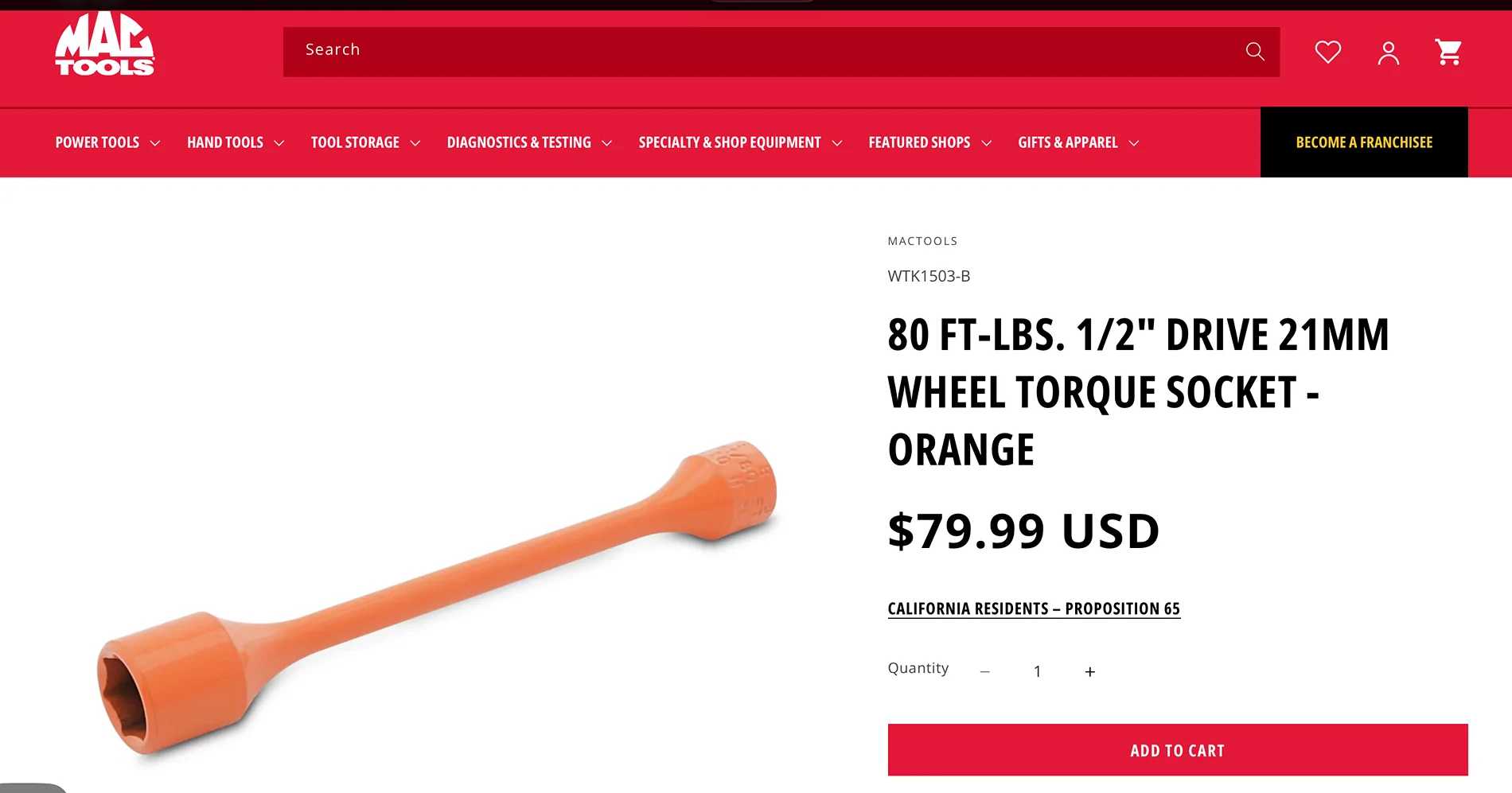

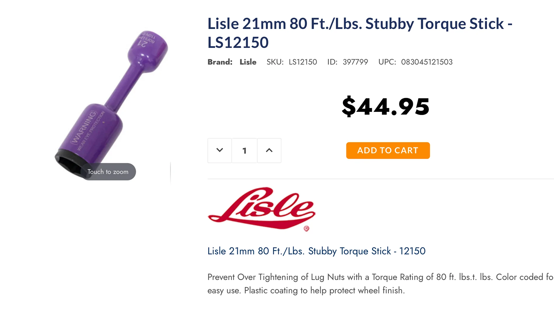

Not concerned with cost. i have torque wrenches…. I like the idea of using a torque stick.. my orginal post was asking if anyone has experience?
here are a couple of more options
