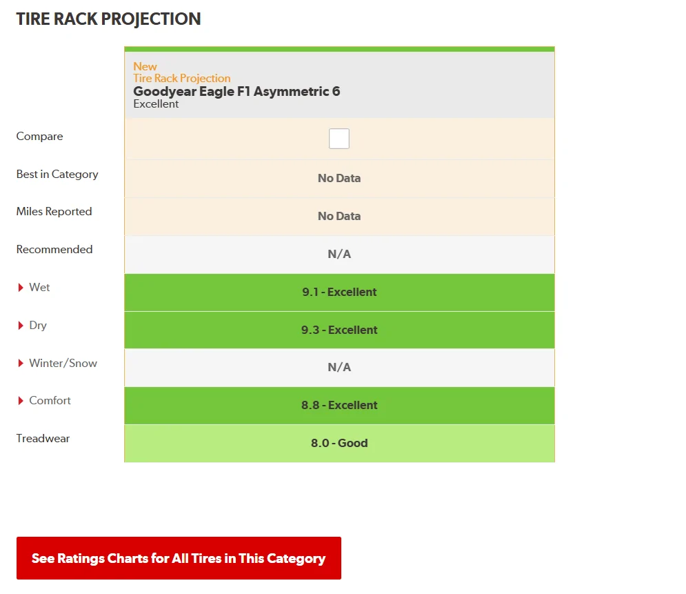

Did tirerack.com drop the category ranking/comparison charts or am I missing it? In the past you could see all tires in that category lined up, or at least the ones with enough miles/scores to make the list. I can see individual rankings, but not the whole category.
Sorry, I didn't see your question until this morning.
They do still show the full category ratings if you click on the red box below the individual tire rating. It says "See ratings charts for all tires in this category"
See screenshot below.
