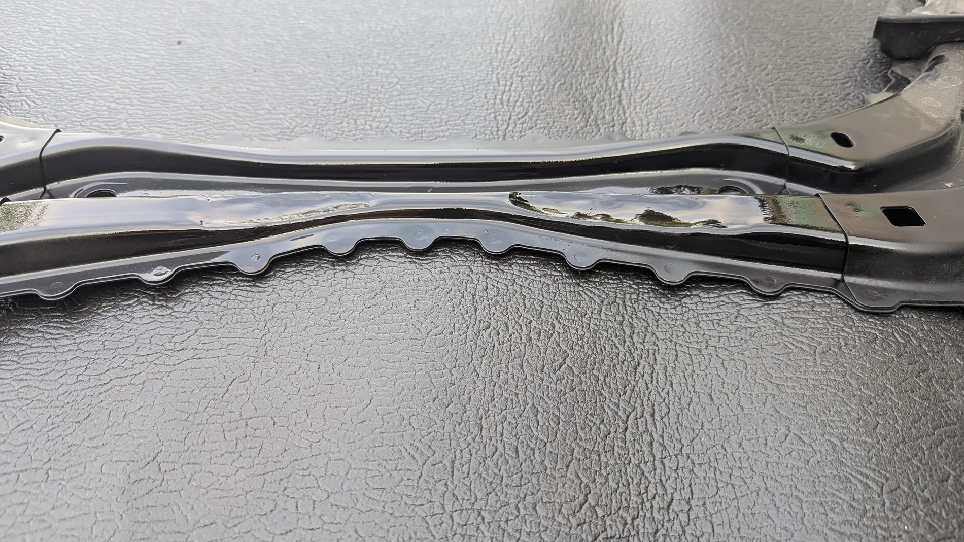

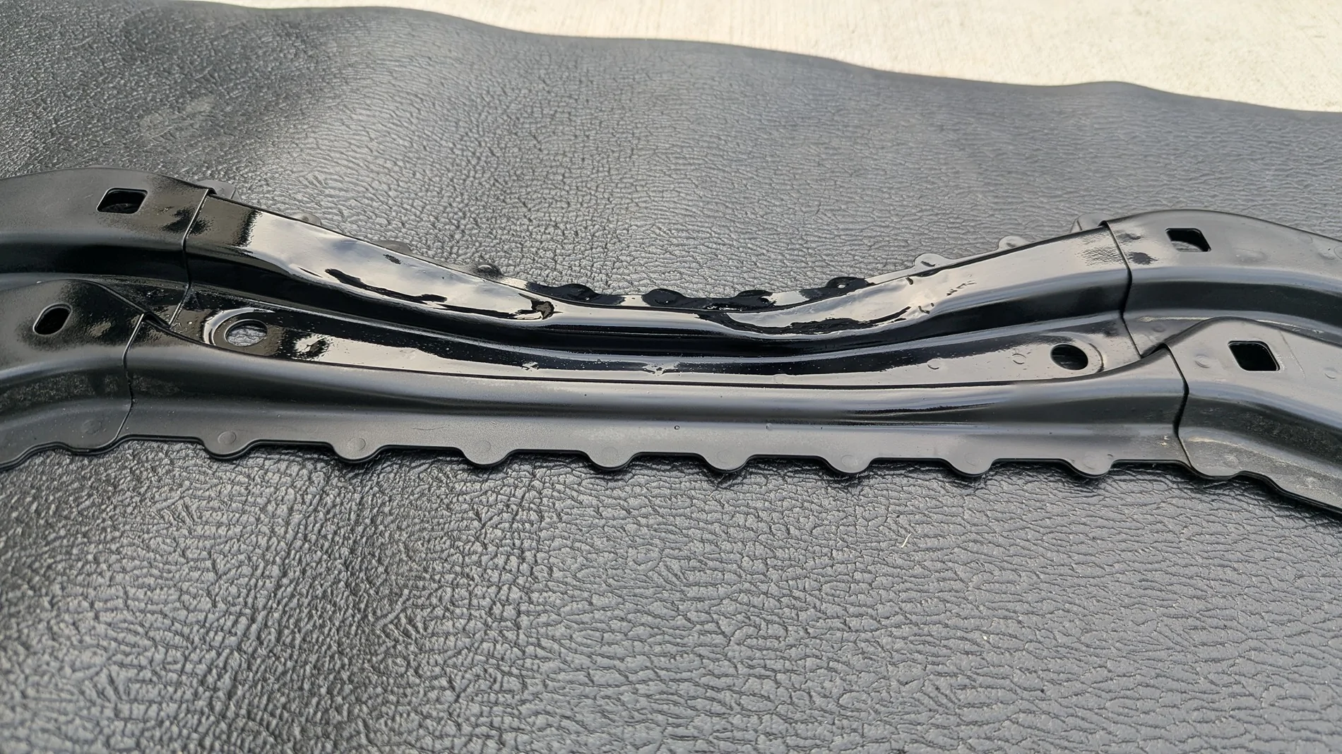

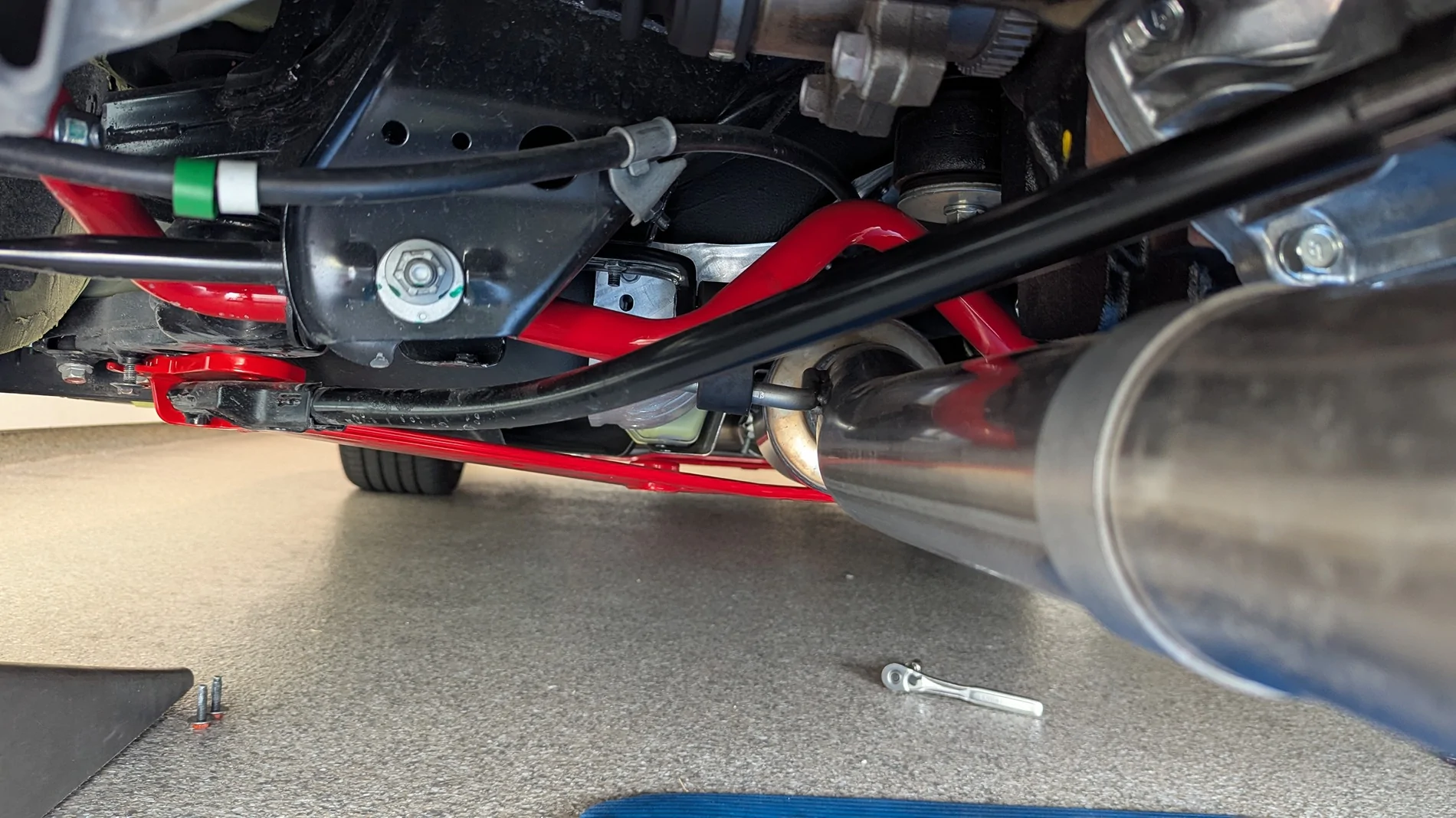

This is how to make the AWE catback exhaust not rattle on the W-brace:
Hammer & repaint; you'll see exactly where the exhaust is rubbing/rattling.
AWE needs to start including four ¼" spacers for this brace with their exhaut systems.

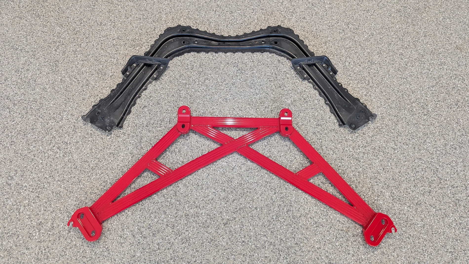

Wack, do you think the Z1 bracket would work as well?

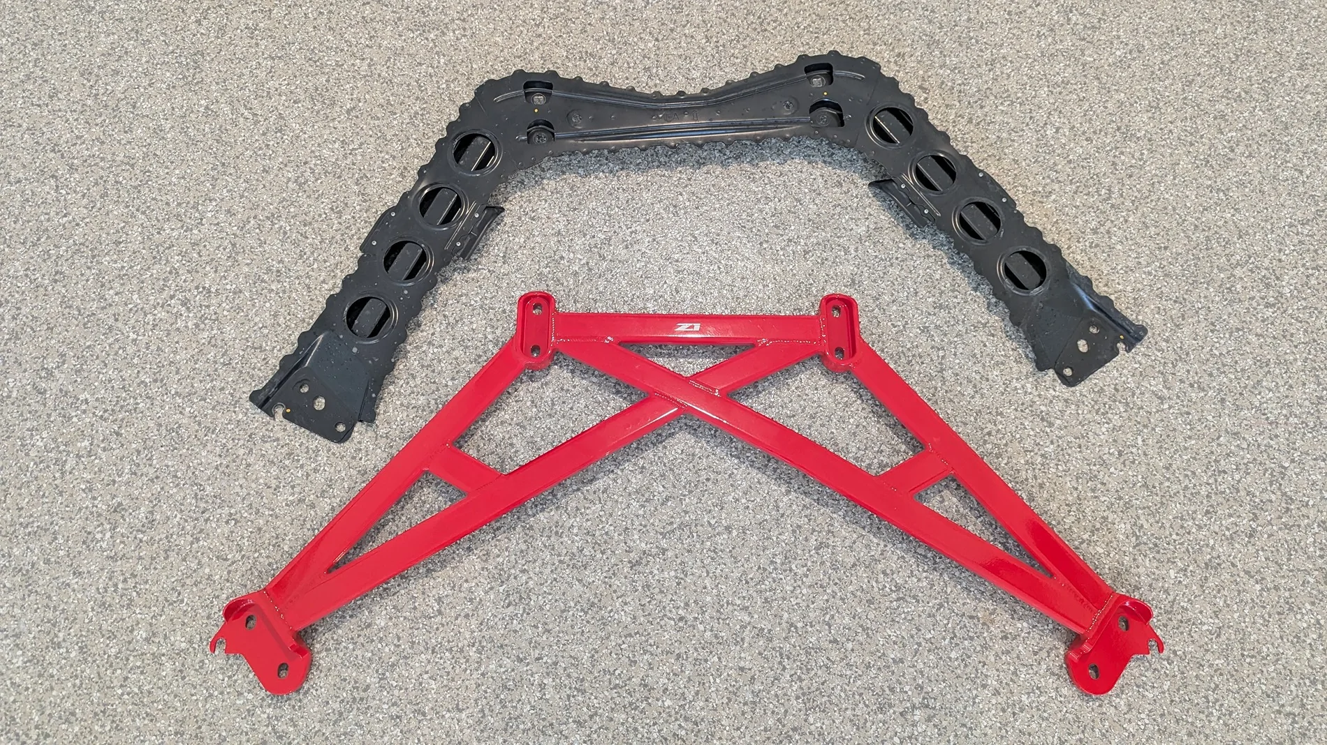

on the flipside, I let the exhaust break in more and its gotten way more quiet, so I'm happy now
No, I tried the Z1 W-brace yesterday and the fitment was, shockingly, even worse!

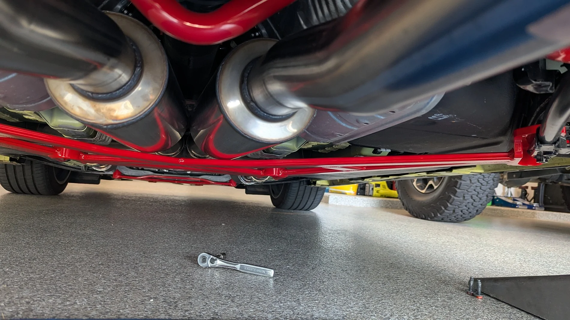

This is painfully unfortunate, I would’ve thought it would fit better LOL, I need to go under the car and check if my resonators are on the brace, to my knowledge they aren’t. Either way, wish there was a fix for this
Now that I am having the same problem, I just wanted to come back to this post to say thanks for trying the Z1 W-brace and sharing. Thanks!

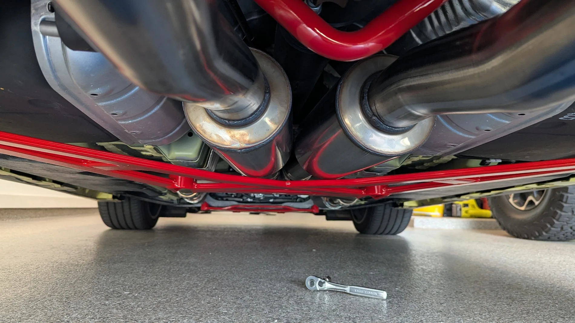

I may have to try the crush and paint method as a last resort. My resonators are just about touching which inhibits rotating them higher and away from the brace since that also brings them closer together.
I wonder if it would be possible to put a small washer or shim under the w-brace at each bolt between the brace and the body. I'm also thinking there could be some small room for adjustment at the lower down pipe flanges if I unbolt those 4 bolts and push upward on the exhaust. (If there was any play gravity would have them sitting low.) Anyway, my speculations aside, my point was just to say thanks because you likely saved me from buying this brace.
Good luck! Let me know if I can be of assistance!
IIRC, the shop I had install my cat back had to do something like this. The pipes were hitting occassionally on first install even though there was a gap.
