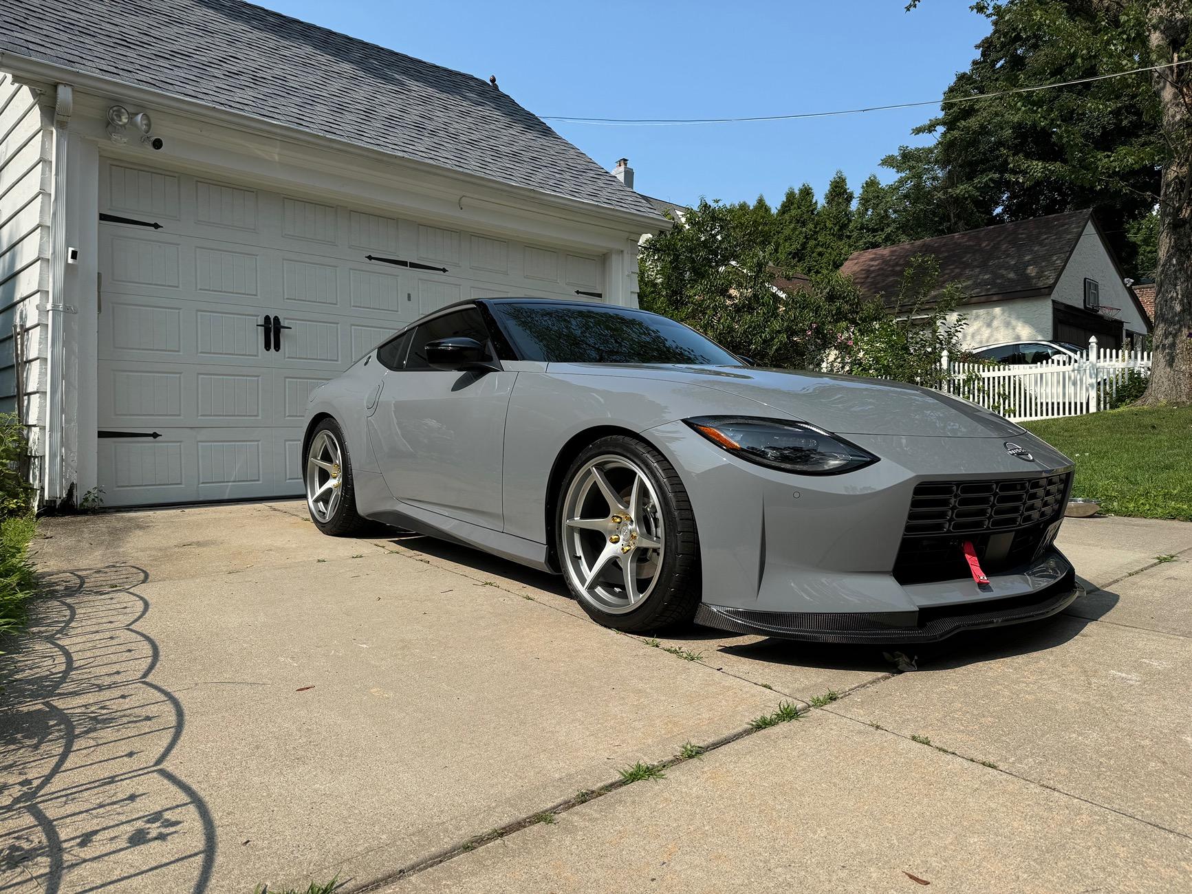

I just installed these over the weekend. As the only available lower springs on the Z there isn’t many choices.
I have installed H&R and Eibach springs previously. Also a few coil overs, in the past.
Rears are pretty easy, as it’s a divorced set up, only took once bolt and it was simple.
Fronts are are a bit harder than the 2 above mentioned brands if you don’t have one of those shock machines that allows you to compress the spring. I ended up using the car to compress the springs, careful not to bend the dust shields…
It’s a bit lower than I like, I have Z1 CF front lip, and it’s pretty low. The ride is firmer, and not as floaty as the stock OEM springs. Body roll is okay, it’s improved a bit.
Looks great Villian!!

Damn. Looks good Villian

Beyond reducing body roll, how do the swift springs impact side-to-side transitions? Do they make the Z quicker to respond than OEM? How about under braking? is there less dive under heavy braking? Can you feel what the car is doing more?
When I added Eibach Pro-kit springs to my Redline Z33 track model, I felt suspension performance was better and fit my wish to make the car more neutral in overall handling.

The color with the wheels looks BANGIN!?
