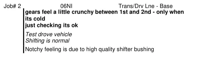

My December 2022 built manual proto is definitely a little crunchy going into second when cold. Seems to be fine once it's warm. Someone suggested it might be fixed with different fluid or it's the down hill out of my street, or it's all in my head.
But I'll mention it tomorrow when it goes in for its first 1000km service. Do note: I've been very gentle to it for it's first 1800kms so far, intend to wear in to 2000kms.

Service completed, this was their response.
Hmm, crunchy and 'notchy feeling' are not the same. Get a 2nd opinion at another dealer, doubt it's a bushing problem, Nissan knows this. One member here already got a replacement.
