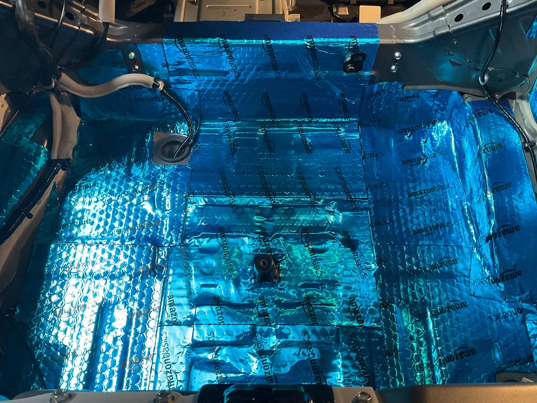

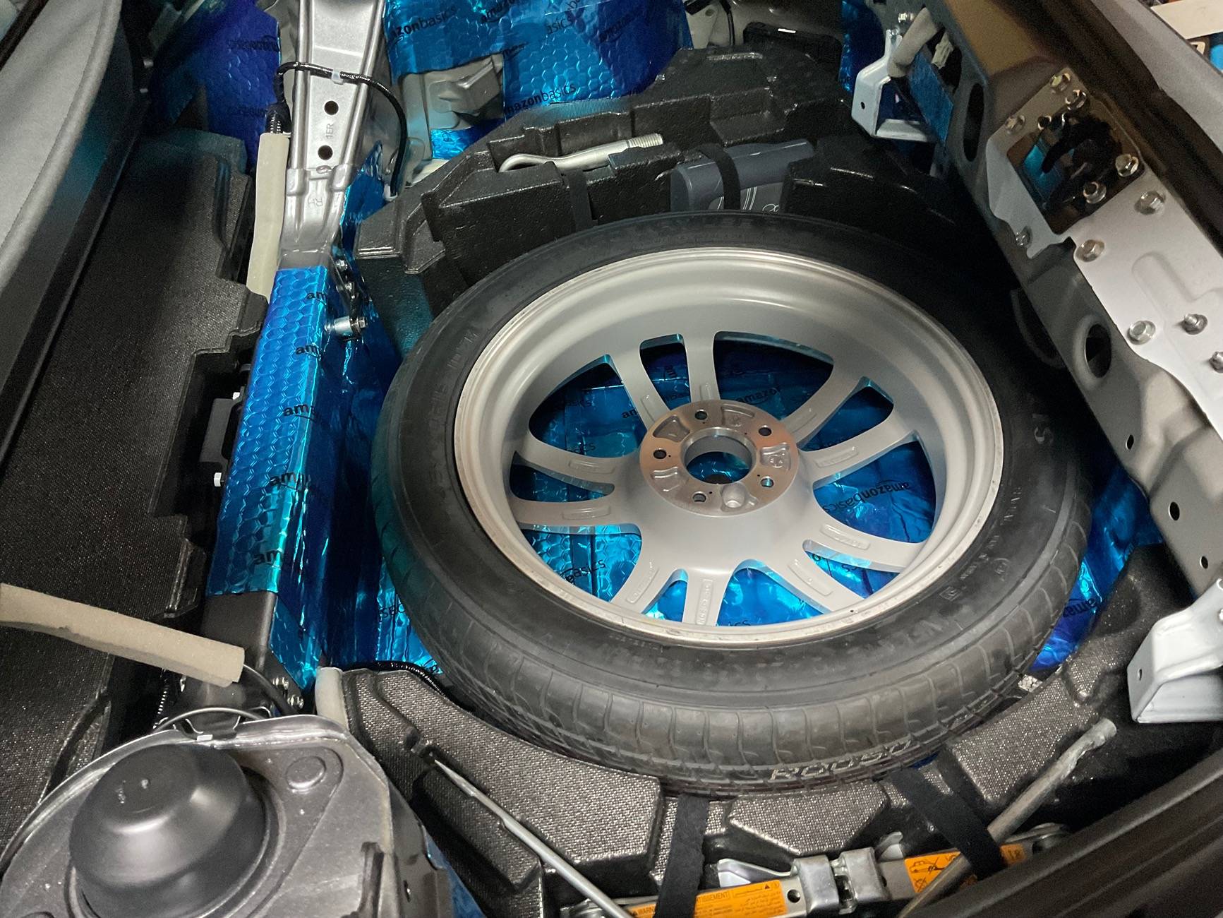

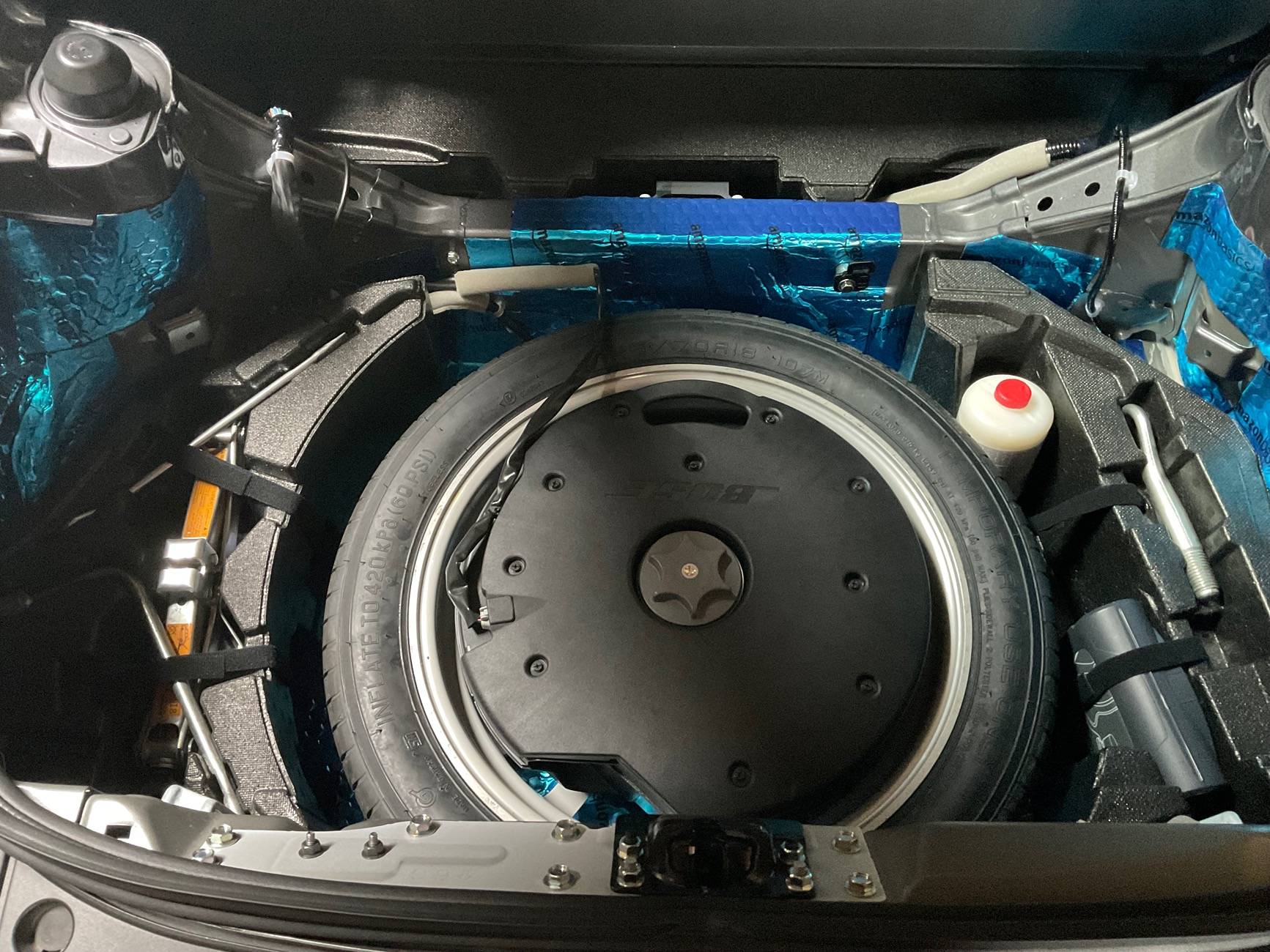

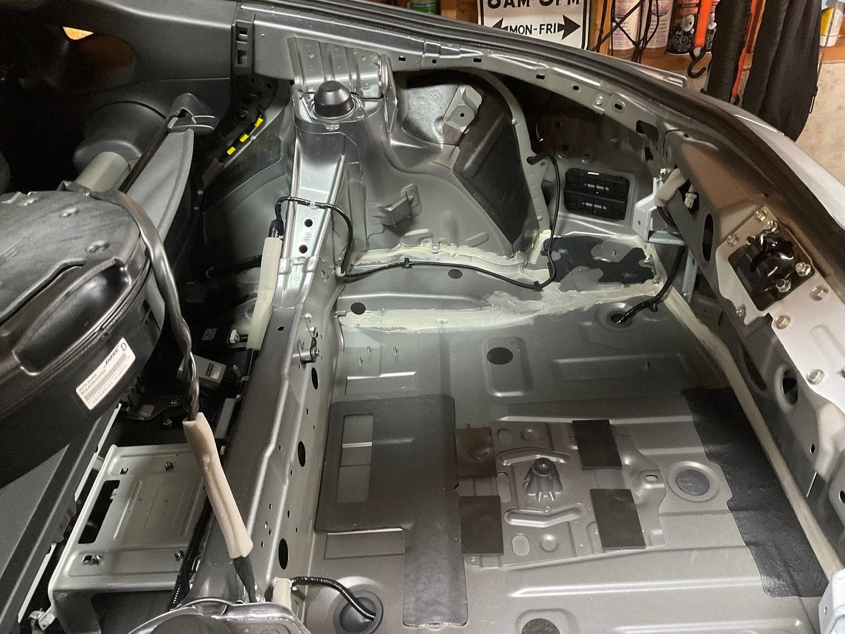

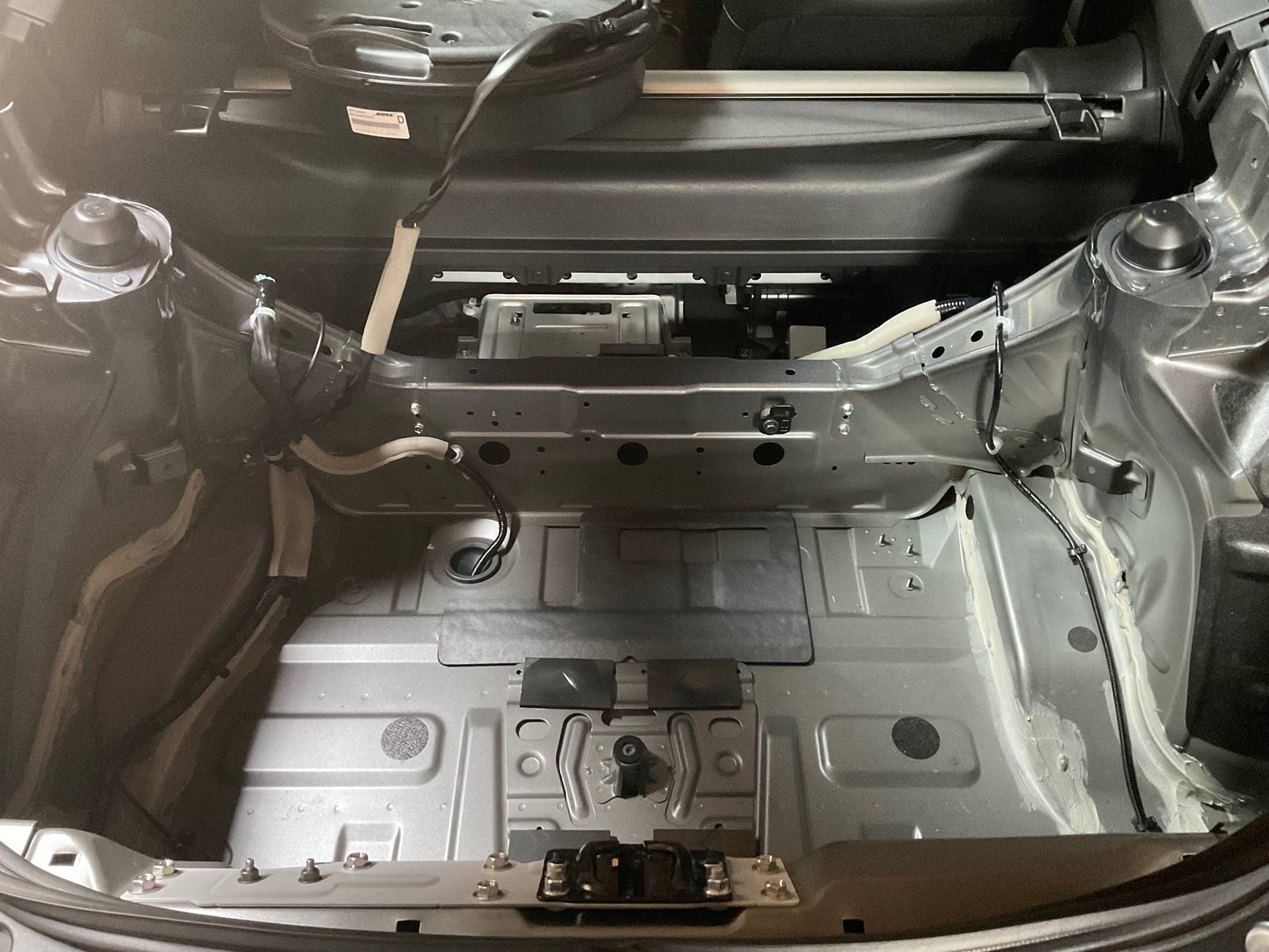

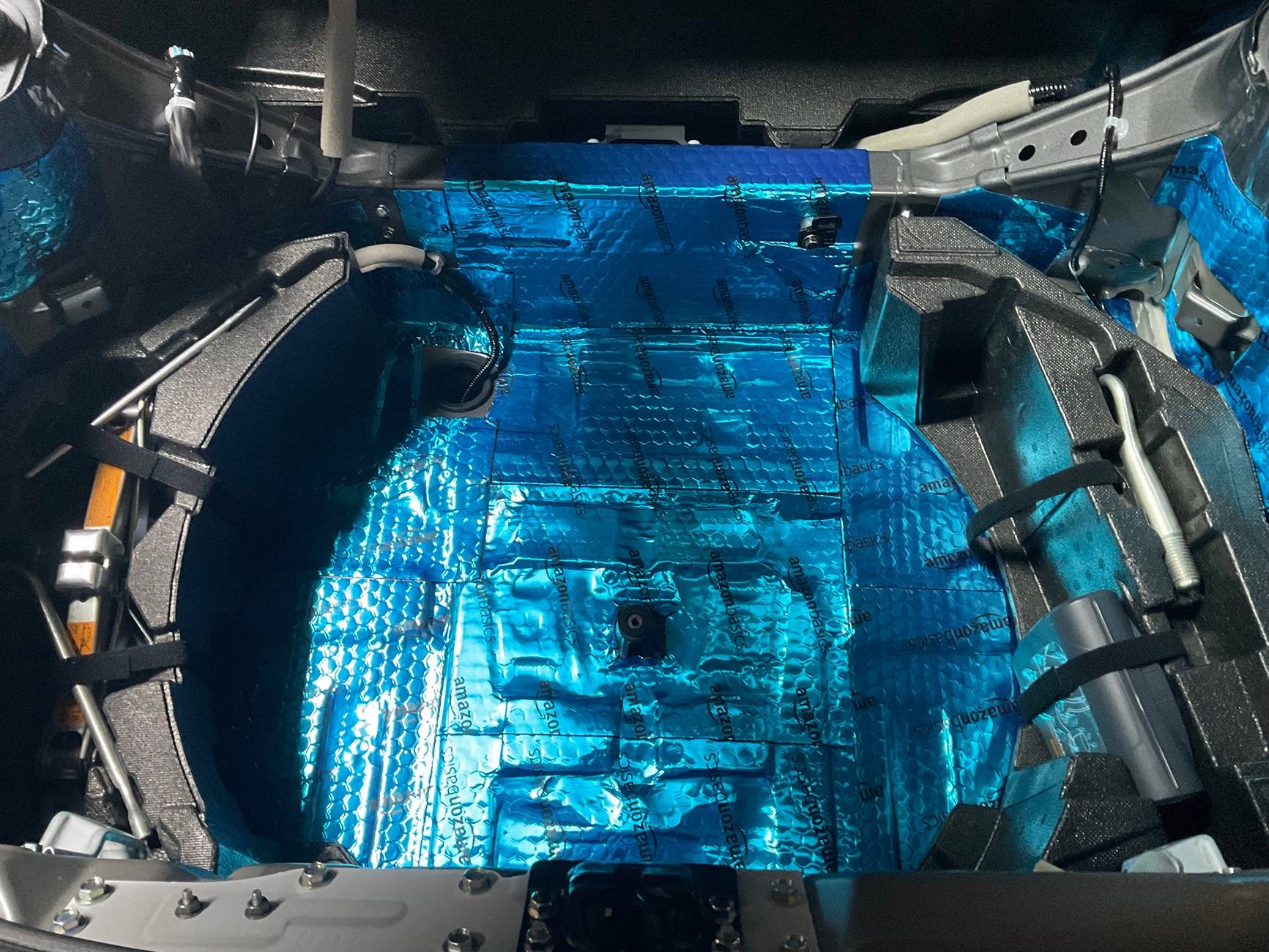

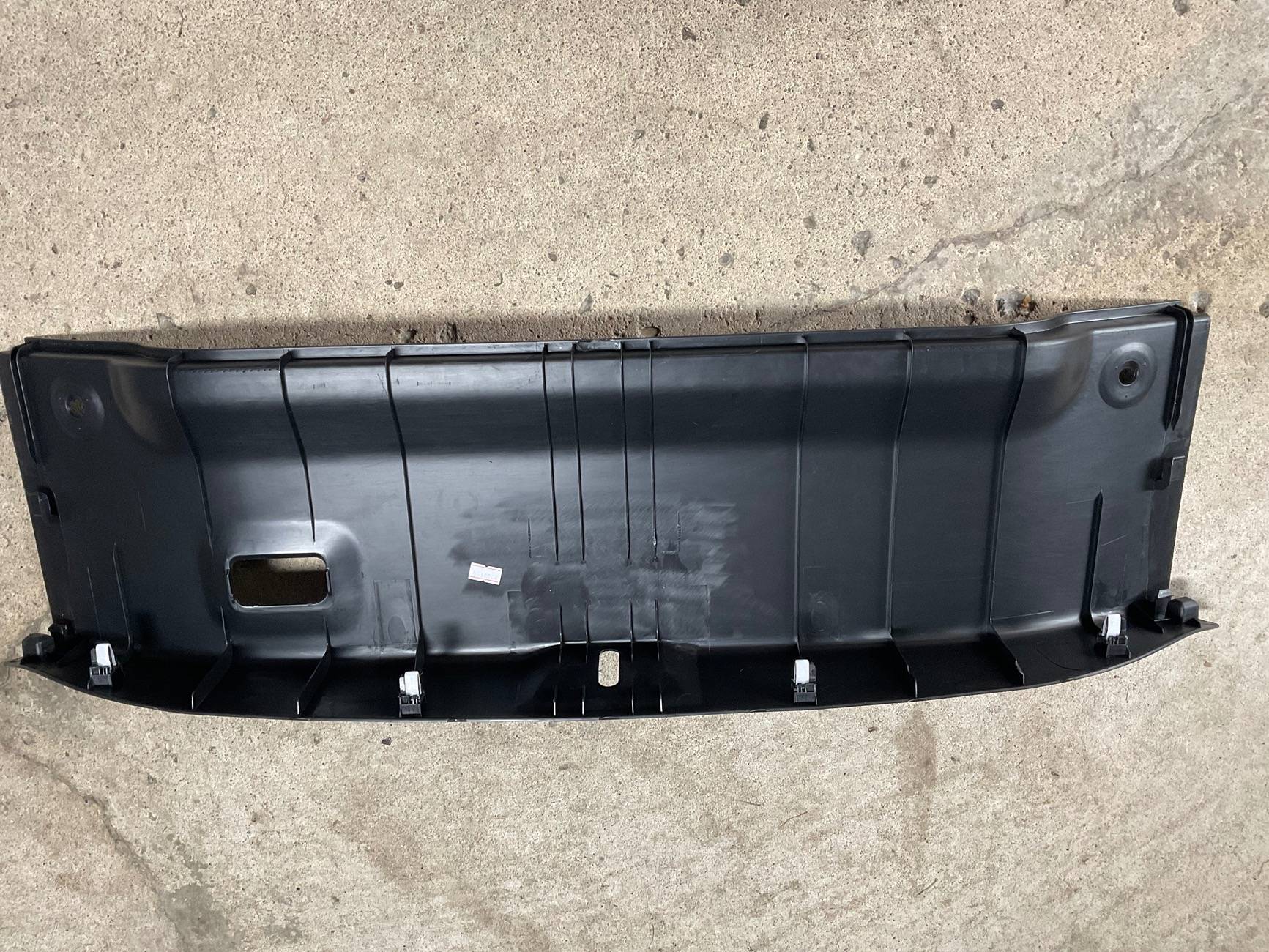

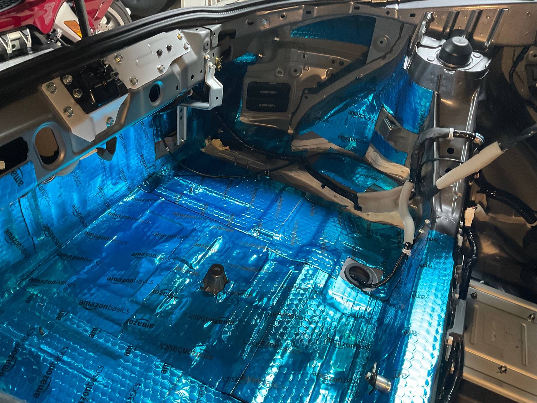

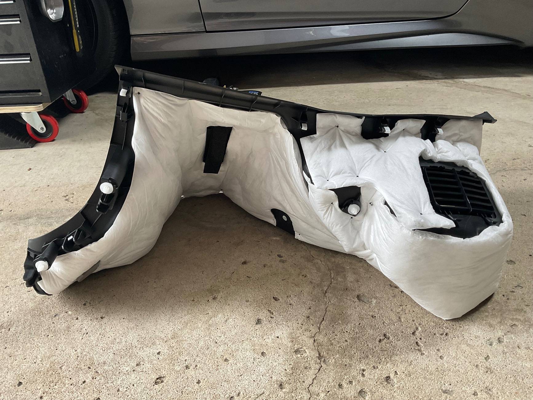

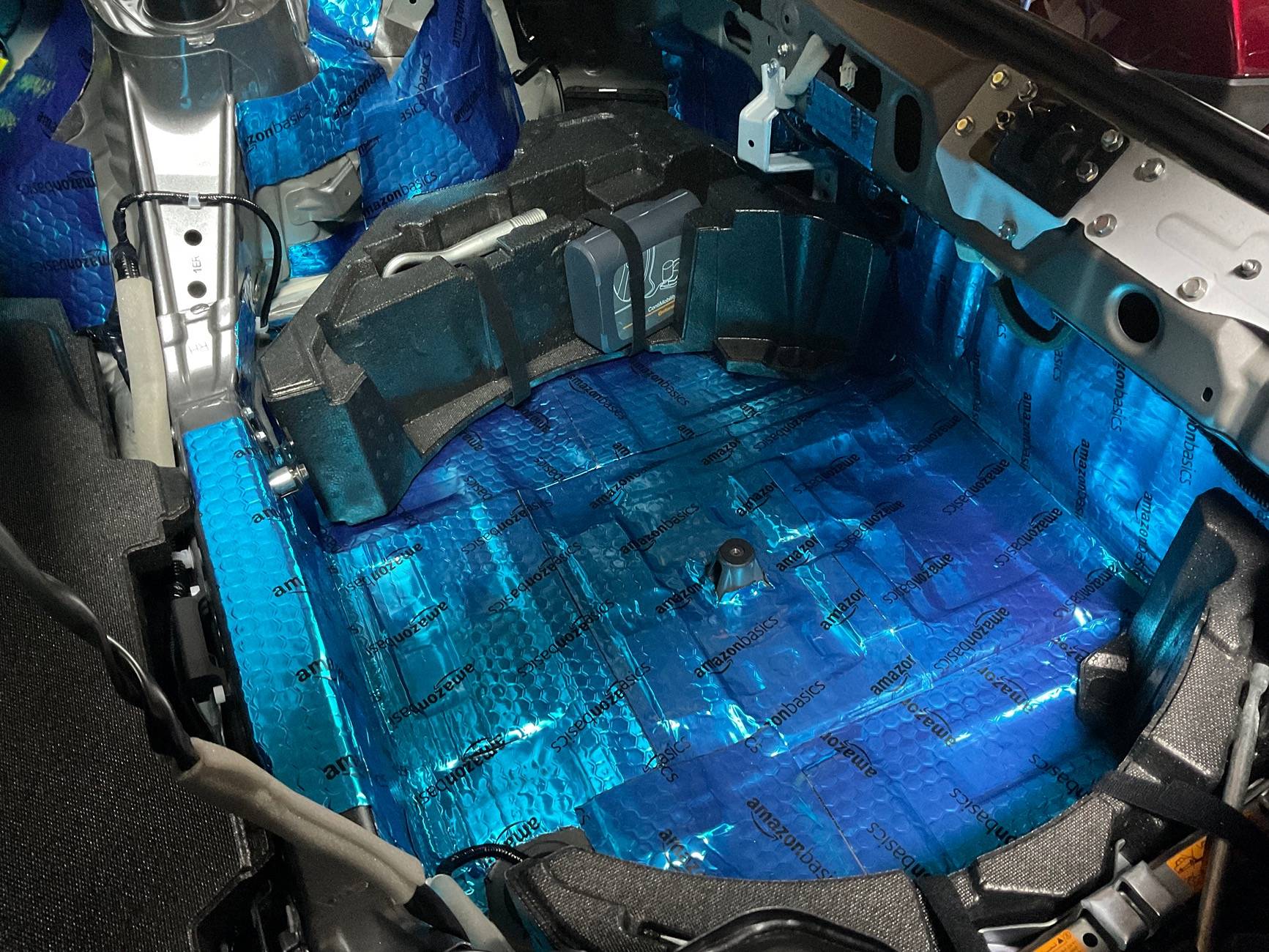

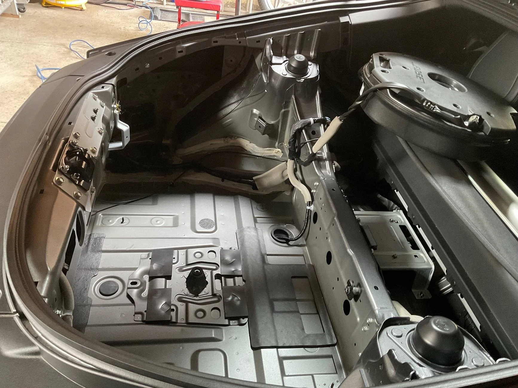

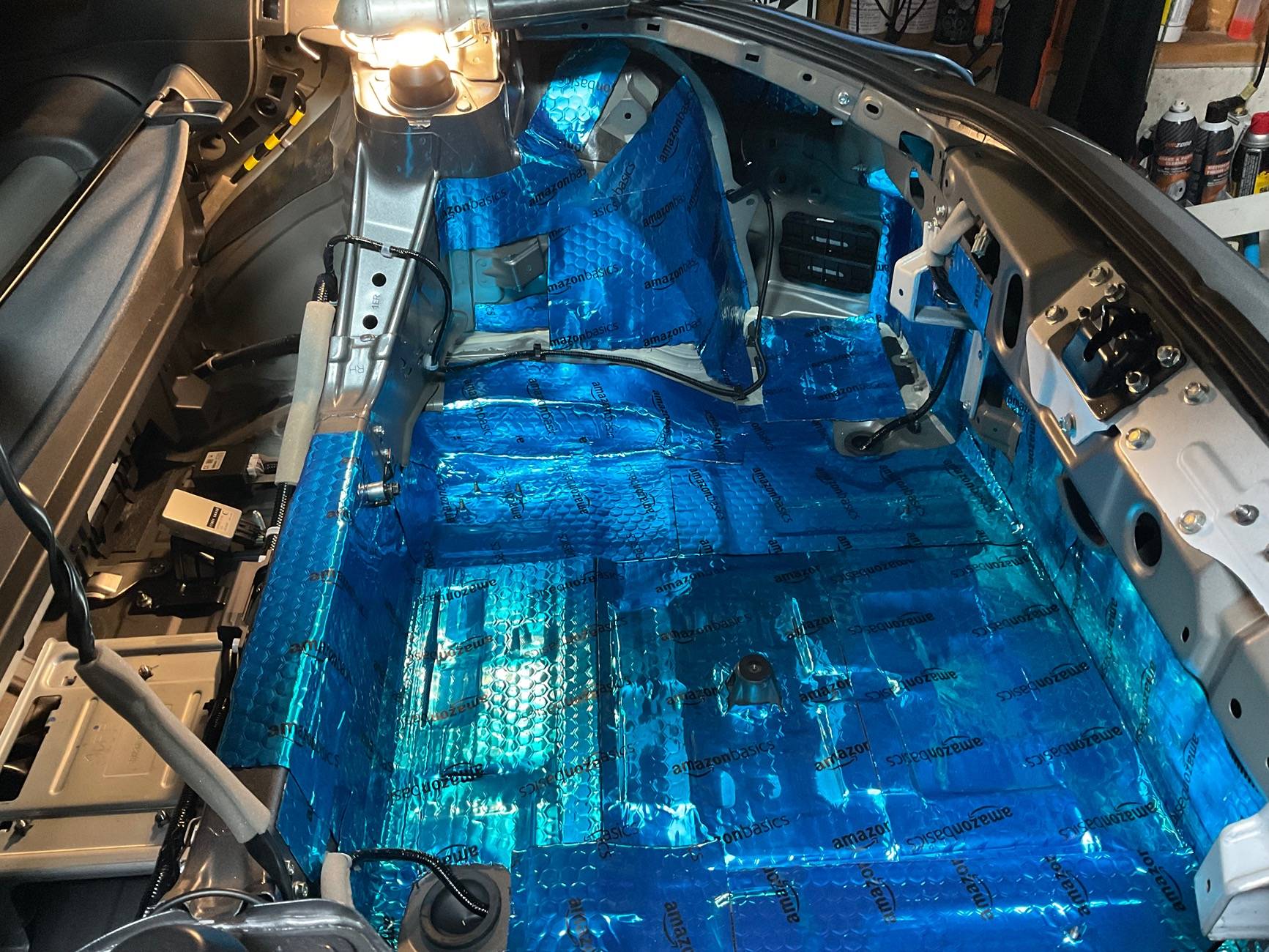

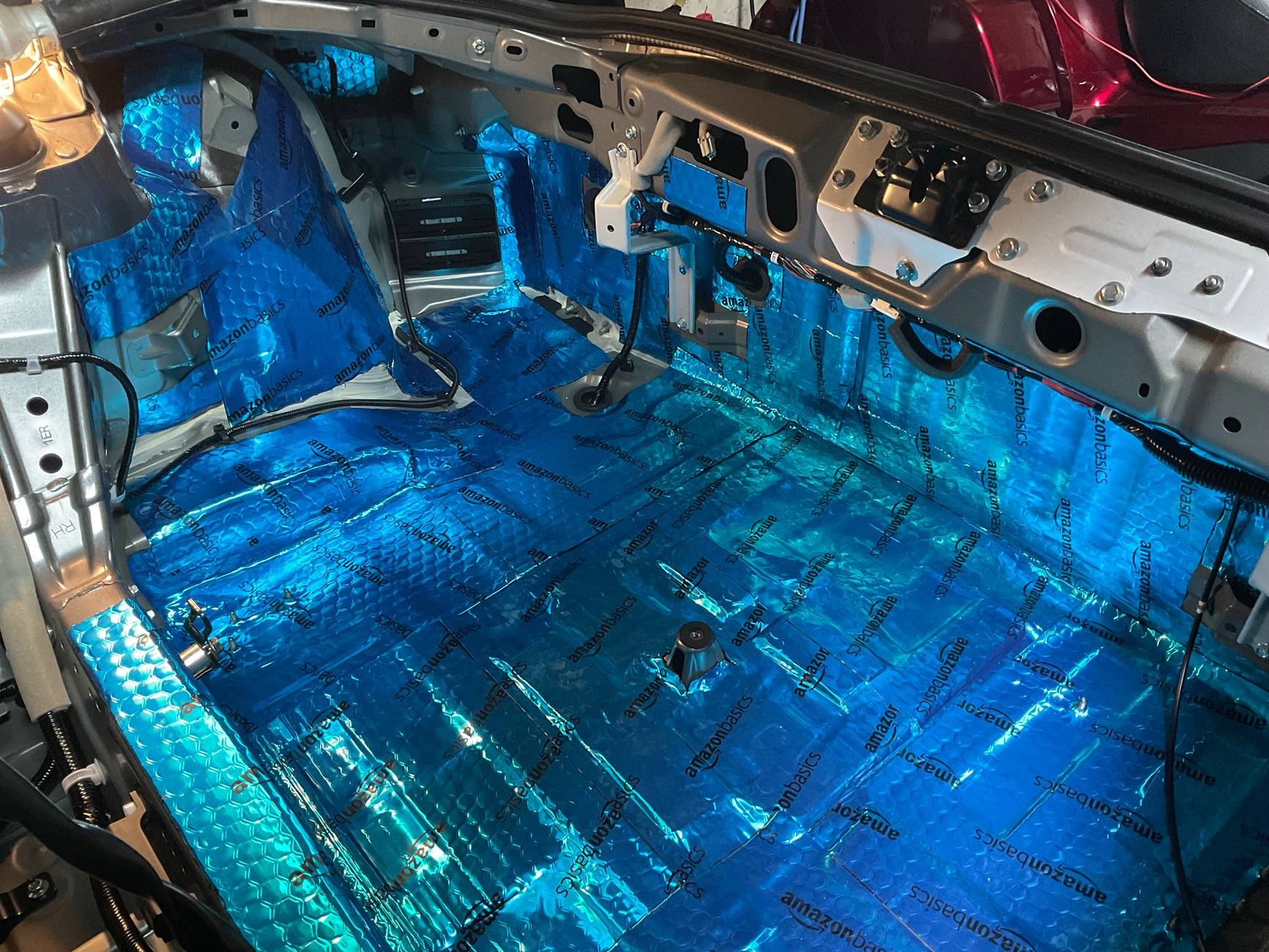

I also added some sound deadener to the trunk area only. I removed all the trunk trim pieces and foam inserts then placed the deadener to the floor, back wall, and side fenders. Attached are before and after pics. I also took a couple of pics of the rear and side trim pieces that show where the trim clips are located…for those who want to remove them also to apply the maximum amount of deadener in the trunk. Removing the trim was easy albeit a little nerve racking as I didn’t want to break any trim clips. The clips are attached firmly and do take quite a bit of effort to release.
The noise level was noticeably reduced. It was well worth the cost and effort. I used the Amazon Basics sound deadener and it was easy to apply. I ordered the 34 pack of 10x13” sheets which turned out to be more than I needed. I used about 23 sheets in total. I’ll use the rest for either the seat floor area or the doors at a later time. Total cost about $100 Cdn dollars.
Hope this helps those who are considering this project.
Great Job!
I see that you decided not to cover those vents at the corners of the rear fenders. They are completely open to the outside; those the reason I covered them.

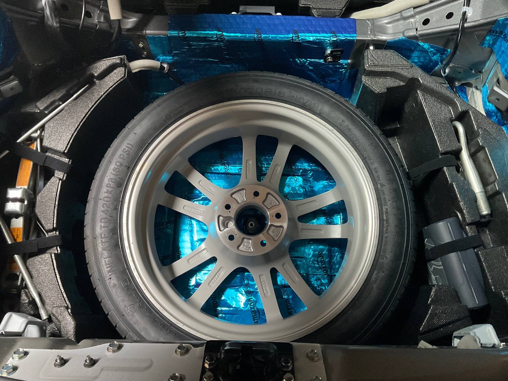

I want to get the same spare tire set up that you have. How did you go about it?
Thanks.

Great Job!
Thanks.
Regarding the “vents”, are you referring to the small square boxes on the left and right rear corners? Frankly, I didn’t know that that’s what they were, so I left them uncovered.

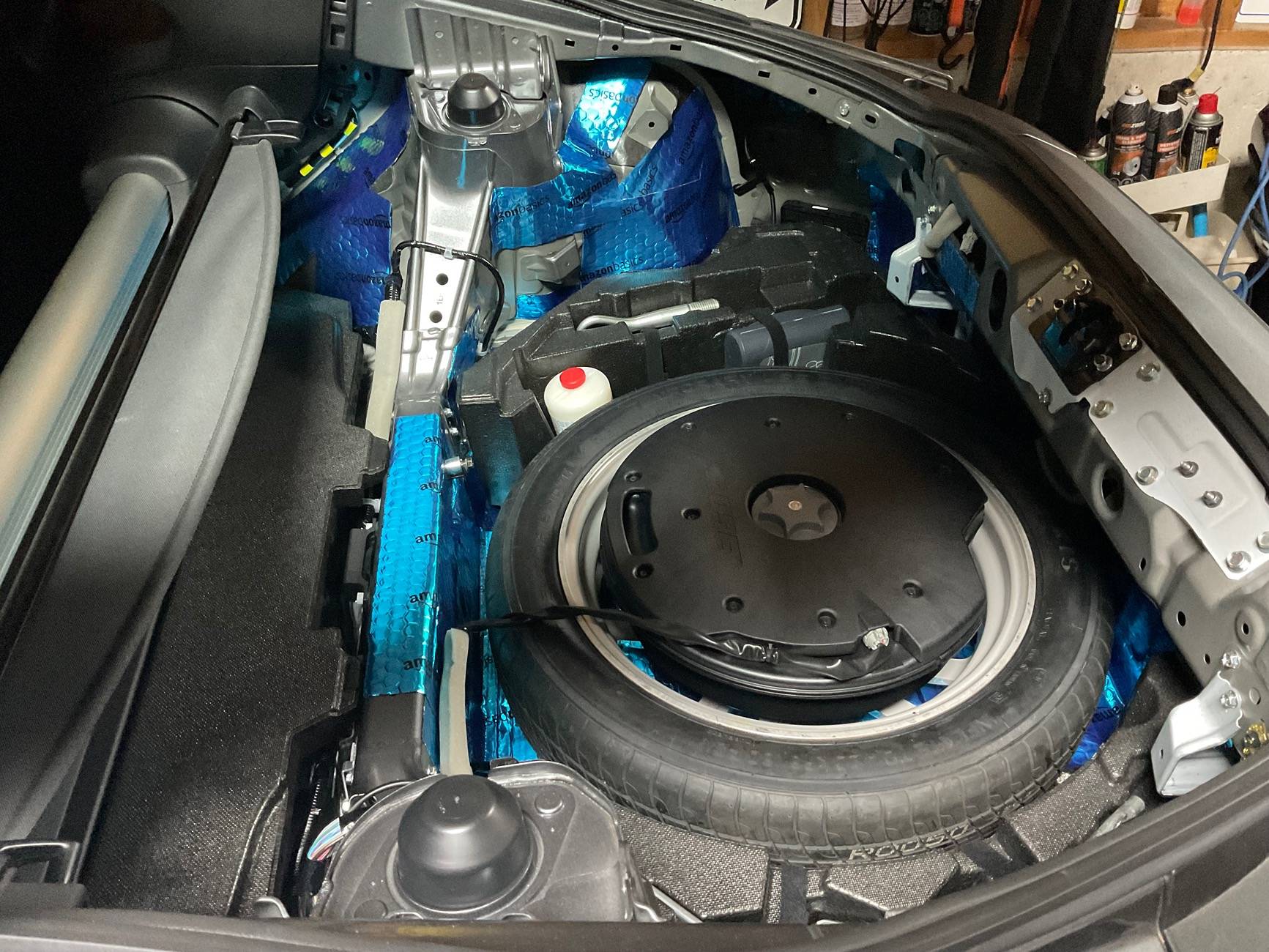

The spare tire idea was taken from another thread in this forum. I really don’t like the goop repair solution that the Z came with. I rather have an actual spare tire. I managed to find a brand new and unused spare tire/wheel off of Facebook Marketplace. It was from a 370z Nismo. (Fitment was exact) As I have a Performance model, it was important to get the 18” spare as opposed to the 17”. I also picked up the scissor jack, lug nut wrench, etc from an auto wrecker. Much cheaper than buying them from the dealer, by far.
To fit the spare tire in the trunk, you simply have to remove the center foam piece. The sub woofer fits inside the spare tire, as it did with the previous generation 370.

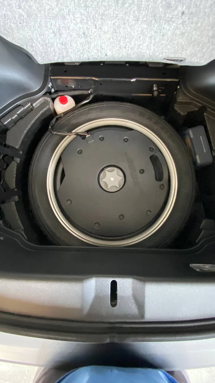

Completed my spare tire set up (thanks GtownZEDD)
I love it and highly recommend it to anyone that has done a muffler delete.
I got my stability at cornering back. For some reason, it feels a little bit quieter as well and the base sounds louder as well.
Very happy. Now I have to get an actual jack ?
